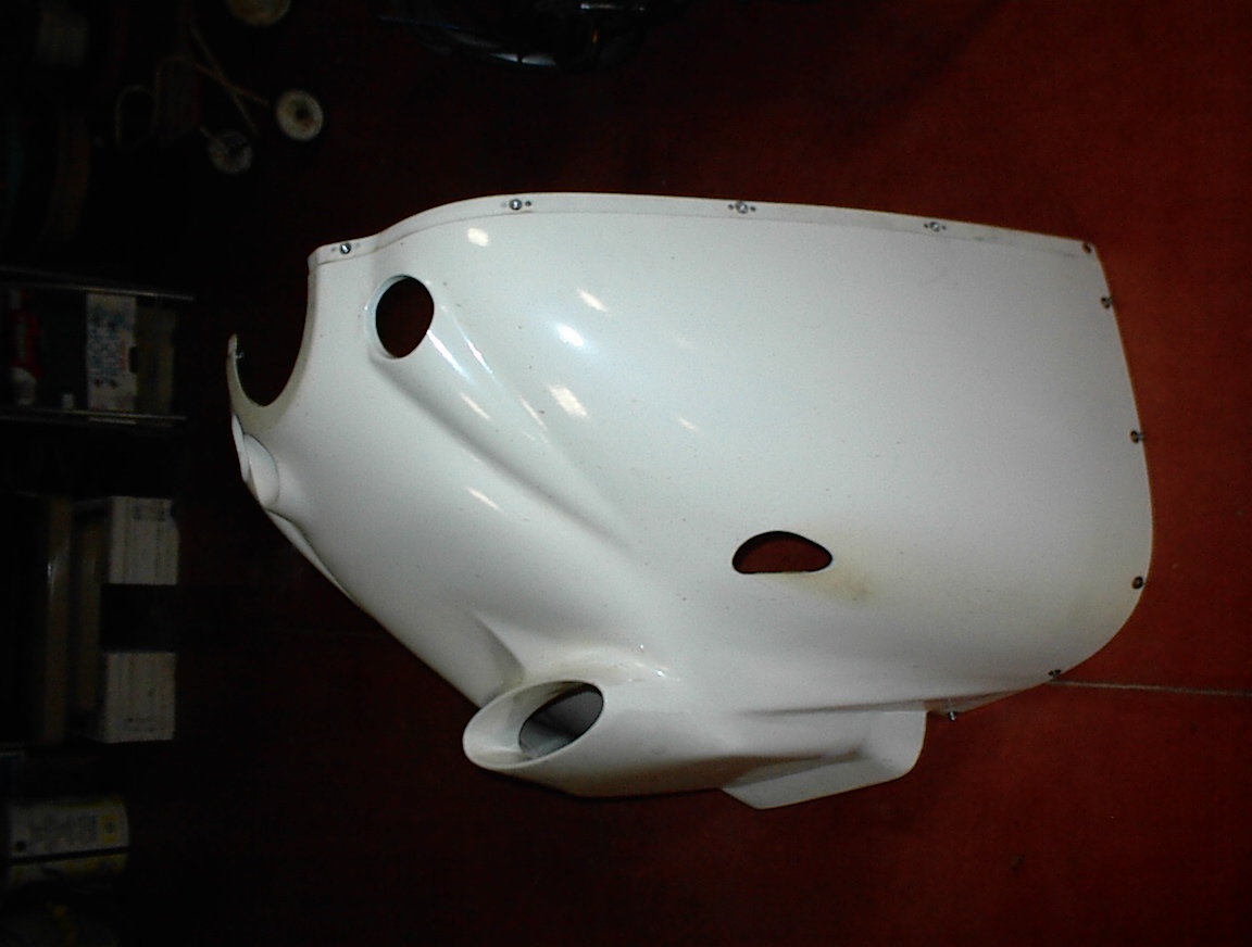

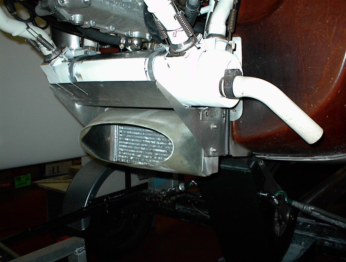

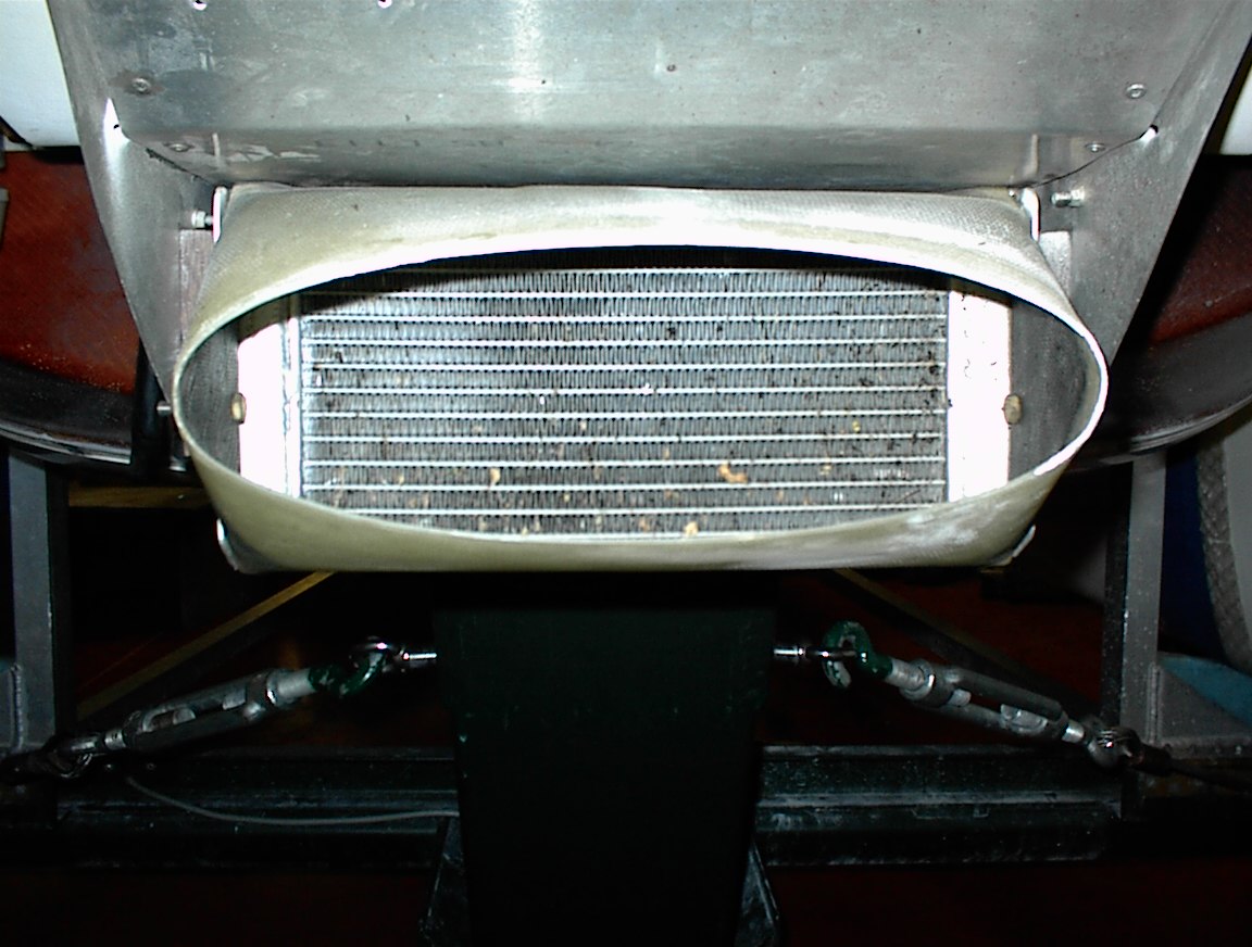

Jeff,
In attachment my concept of cowling and inner radiator duct.
Best regards,
Karel Vranken

paul.the.aviator(at)gmail
PostPosted: Thu Jul 03, 2008 2:47 pm    Post subject: A question on composits Reply with quote
Hi Karel,
Nice looking modification. Do you have the radiators directly behind
each other or to you have the rear one dropped down by 40 mm ?
Paul

karelvranken(at)hotmail.c
PostPosted: Thu Jul 03, 2008 3:36 pm    Post subject: A question on composits Reply with quote
Paul,
I didn't use the original cubic radiator for the coolant. The surface is
greater and only 1,5" thick with the same contents. I didn't need to lower
the oil radiator. Using the Evans coolant I notice normally in cruise 100°C
for oil and 110°C for coolant. In hot summer like last year in Italy by 41°C
on the tarmac the temperatures rose with 10°C. Oil is changed every 50 hours
and I use actually Shell Advance 4. Next I will change to the Aeroshell
Sport plus. I always use Mogas 98 without alcohol.
Best regards,
Karel Vranken, F-PKRL 912 ULS Airmaster CSU.
