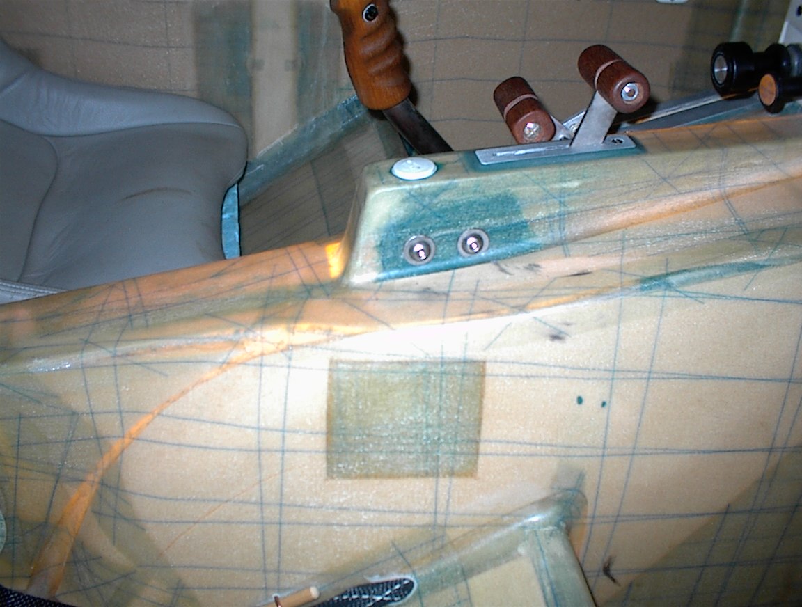

The manual shows a measurement for positioning the monowheel brake
master cylinder which looks as though it might be made parallel to
the top corenr of the tunnel moulding. However, that would put one of
the mounting holes in a brown foam area which would obviously crush
when the mounting fastener was tightened. However, measuring
horizontally with the fuselage lying on the ground (instead of
slantwise along the top corner of the tunnel) puts both holes in a
plain resin area, which I feel confident is the correct location.
However, (since I can't rely on the picture on the manual) I'm
wondering about the angle at which the master cylinder is mounted.
Should it be parallel to the tunnel top, or should it be as near to
horizontal as possible (with the fuselage level), or should it be
horizontal in the tail-down attitude (to make bleeding easier)?
Any suggestions?
regards
Rowland

There is a metal insert in the tunnel wall (the area you call the "plain resin area"). The mounting holes need to go in this area, parallel to the top of the tunnel as shown in the illustration.
John Heykoop

At 2008-06-28 21:58 -0400 JohnDHeykoop(at)aol.com wrote:
| Quote: | There is a metal insert in the tunnel wall (the area you call the
John - thanks for that confirmation.
So, if the cylinder is parallel to the top of the tunnel, the filling
hole will be at the lower end of the cylinder. How does the air in
the upper end of the cylinder get expelled when trying to fill the
brake system with fluid or to bleed it? All sounds potentially messy.
Seems it would be better if the cylinder was tilted downwards at the
front so the filler hole was at the highest point of the cylinder -
of course that would reduce the length of lever available above the
tunnel so would probably be undesirable. I suppose one answer would
be to tilt the whole fuselage tail-up when filling the brake system
regards
John - thanks for your reply.
The metal insert in my cockpit module must be a quite exotic alloy as
I can see through it! That's why I said it was a "plain resin" area -
obviously it has glass weave too.
But now I'm wondering - is my cockpit module faulty? Can anyone else
confirm that the brake master cylinder mounting area contains a metal
insert as John found on his?
regards
Rowland

I can confirm that my cockpit module had an aluminum plate for the brake master cylinder mount molded into the cockpit module. If you will go to my build web site ( http://www.europaowners.org/N914XL/ ), album Year #2, Q3 2004. Go down the page to the pic "Brake master cylinder bolted in place." The view is from the bottom of the cockpit module. You can plainly see the aluminum plate bonded into the cockpit module.
You should contact the factory to see if your CM is correct or defective. If your CM has been bonded in place already, it may be that you just need to bond the appropriate chunk of aluminum to the back side with Araldite and cover with a couple plys of BID. Or, perhaps take the appropriate chunk of aluminum, use it as a template to mark the area on the inside of the CM where it will reside. Cut out the inner layer of BID and remove the layer of foam. Bond the chunk of aluminum in place with Araldite, using Araldite/FLOX to fill any cracks. If necessary, make a FLOX fillet around to provide a transition to the inner skin, and lay up at least two layers of BID on the back side, maybe more. Other folks suggestions as to the number of layups would be welcome. Probably need to overlap the inner skin by at least 1 inch (2.5 cm). I might go 2 inches (5 cm). Of course, be sure to scuff sand every bonding surface, aluminum and fiberglass.
Hope this helps.

Posted: Thu Jul 03, 2008 1:37 pm Post subject: mono brake mounting |
Rowland,
As you remember perhaps we were in Kirbymoorside the same day to pick up the
first stage of our millenium deal. So I think we had similar parts. Also for
the cockpit module we have about the same construction. Indeed the
reinforced place for the attachment of the brake cylinder is clear glassed
as you can see in the pictures attached. The first one is looking as if
there is metal inside. But when you put the light underneath then it becomes
clear. Note the different position of my brake cylinder and different
throttle.
Best regards
Karel Vranken

I have the piece here in my hands as it was a part I had to cut away to make
room for my trigear brake cylinder mod. No metal insert here. I have to
admit, if you do not attempt to shine light through, it has the appearance
of a metal insert.
Michael Grass

My tunnel has an area about 3" square in this spot which looks darker,
however I am pretty sure it does not contain any metal inserts. This is
about where I am planning to mount the finger brakes, converted from toe
brakes.

I should have mentioned that I drilled 2 holes here, to mount the finger
brake assembly, and do not remember any metal flakes coming out with the
bit. I will look at the holes again this weekend, just to be sure. If
anything changes, I will post again. Possibly, there was a manufacturing
change of the cockpit module, which took out the metal insert? This may
explain why Bob B. has one in his module...
Greg Fuchs

I finally had to opportunity to get under my aircraft and pull the
masking from the wheel well area so I could get in to see what is
going on. There is no aluminum plate in there. It is some sort of
reinforced area and I have no idea what is actually acting as
reinforcement.
I guess your CM is OK. Get that brake master installed.

Bob - I had a word with the factory today on the phone.
Roger went down to the shop where they have just completed a new
cockpit module and the technician there said they make a rectangular
cutout there in the brown foam and put in 12 layers of glass to make
it up to the same thickness as the foam before the top layer of
pre-preg goes on.
Maybe once upon a time they did use a metal insert and that is what
some people have got. The Classic CM had no prepared area and
required the builder to cut away one side of the glass and the foam
and replace it with plywood before re-glassing.
Thanks for your confidence-building response.
regards
Rowland
