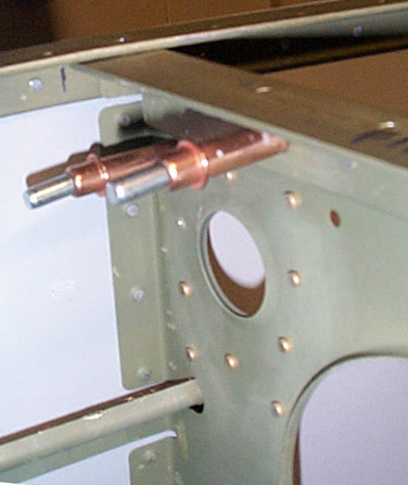

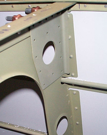

Fortunately, I still haven't joined my tailcone or have cables in the way, but I began the doubler plate work yesterday. I found that drilling out the old #30 rivets was hard to reach as the shop heads were facing forward and the taper of the fuselage made the angle tough (Did go buy an angle drill tool for this). I clecoed the doublers on the forward side of the bulkhead and carefully drilled perpendicular to make the many new #30 holes, then mounted it on the aft side, reamed, and then deburred everything. Having more than one set of hands will be handy to get the last few rivets in.
How do you all get those nasty filings out of the tailcone? Someone needs to invent a drill with a powerful vacuum... Best I can do is with a vacuum and attachment.
Placed doubler on fwd side to make initial holes.
 Filesize:  41.11 KB
 Viewed:  817 Time(s)
Doubler on aft side after reaming and priming
 Filesize:  38.5 KB
 Viewed:  878 Time(s)

Yeah, I used a 90 degree drill for those couple rivets holding it on
to the top of the bulkhead. A small 90 drill like you can get
from aviation tool places works well for that. I clecoed mine
on the aft part of the bulkhead, since I figured for the match
drilling we were doing that was the best, and used the same
90 degree drill to drill the holes. I just worked alone on that
part.
The attached photo shows the attached doubler plate. I used
a rivet gun on the forward side, for a couple reasons....1)
the rivet head should technically be on the thinner material
if possible. 2) it gave more clearance for the gun. I was
shocked that after a couple years without much riveting, they
all came out perfect. It was easy to rivet and buck working
alone in this area.
To get the filings out, I used a small shop vac hose, and banged
outward against the side of the skin to get the shavings to
loosen and get sucked up. No fun, but I got most of them.
Wish I would have had my akzo primer, but I settled for a
bit of self-etching on this part. Not perfect, but it worked.
