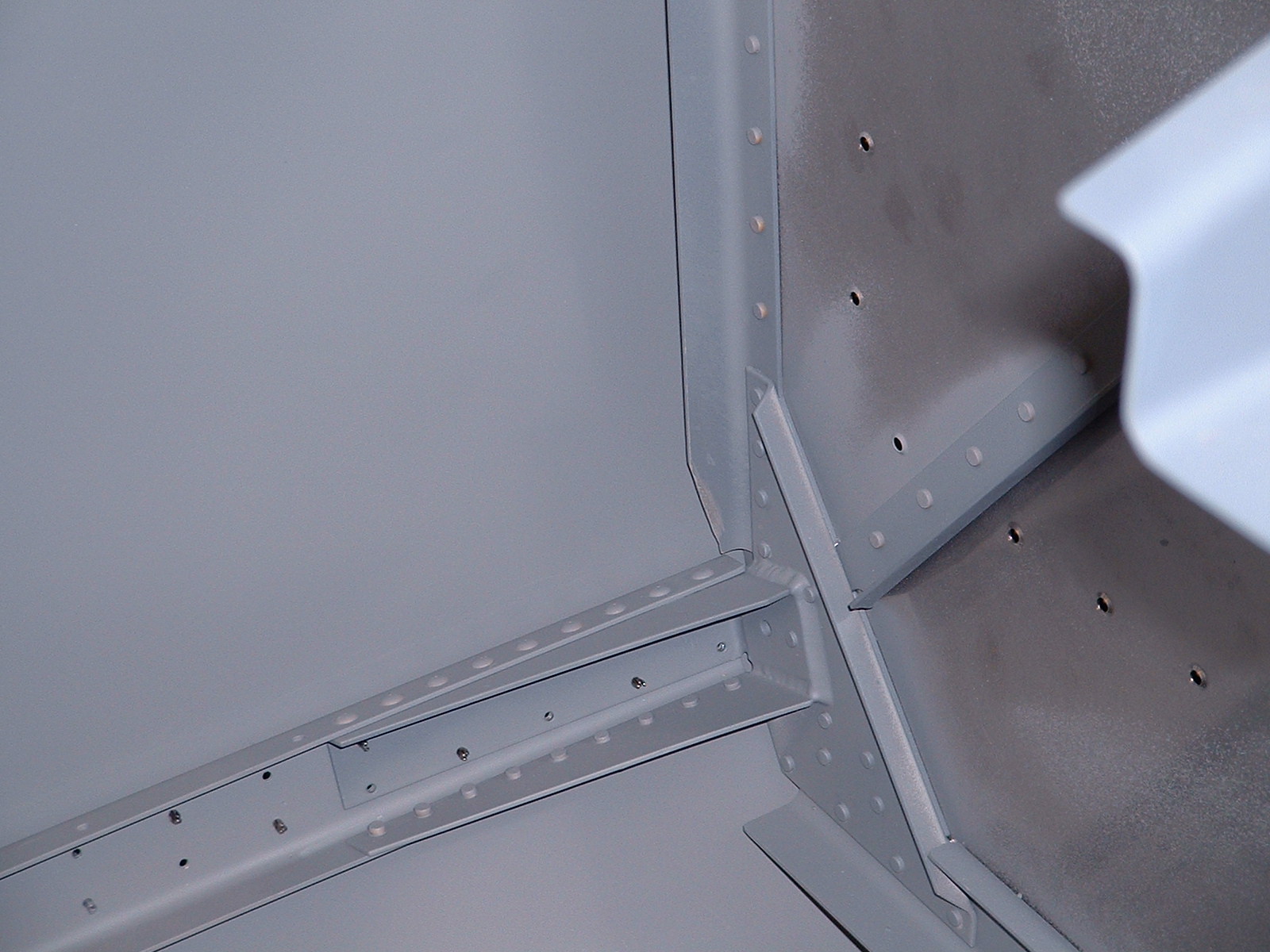

Sorry I may have been thinking about a different section, the area I was talking about is in the photo, it is the most forward rivet in the 1002/1003 brackets. I may have jumped the gun, the are your photos show I followed the plans regarding rivet direction and had no issues.

Sorry I was thinking of a different area, William posted the correct respons to double check your rivet direction. My mind is still bouncing after riveting the 1002/1003 to the lower forward longerons. That is where I was refering to regarding the trimming of the stiffener. See later post for what I was thinking.
