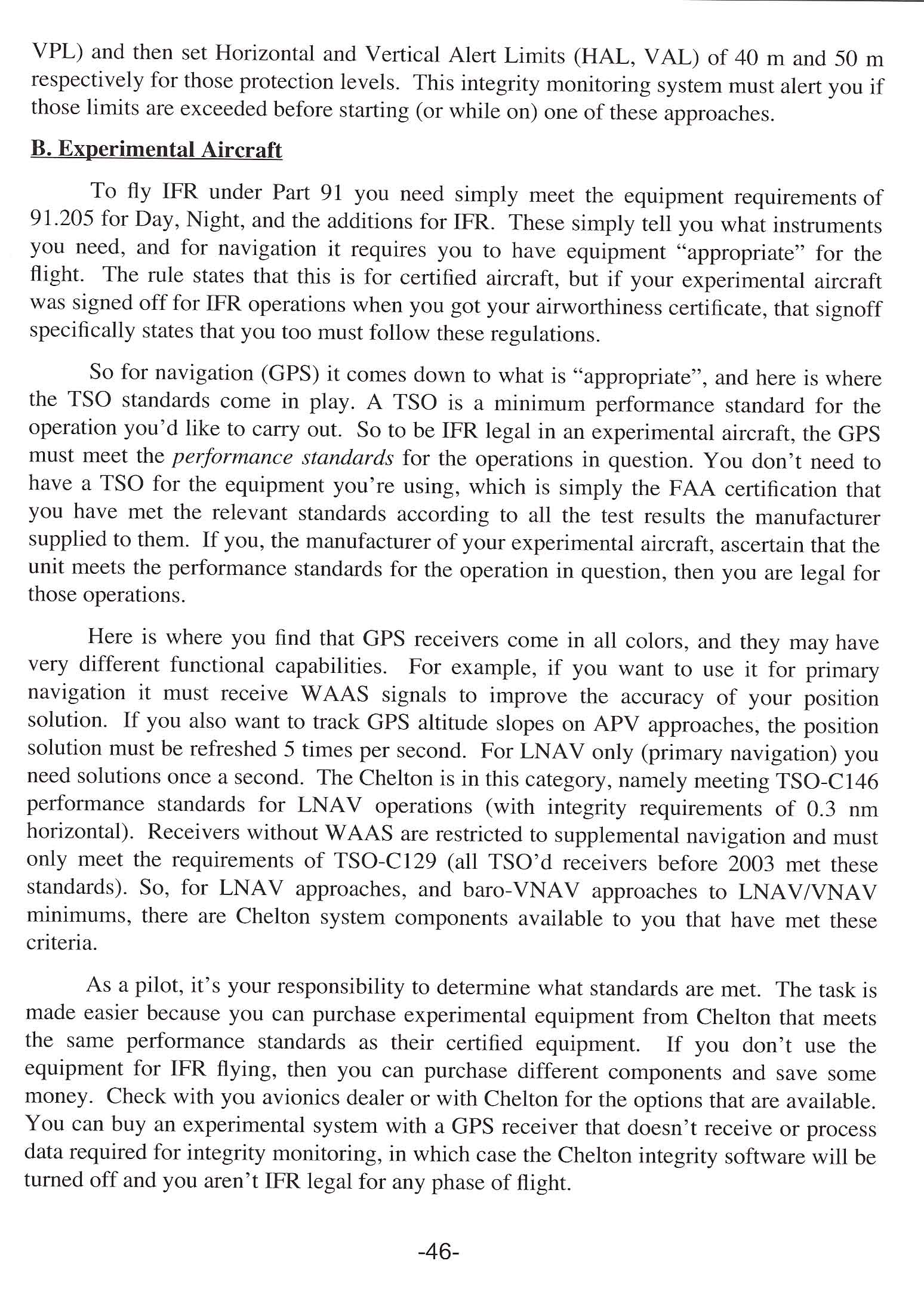

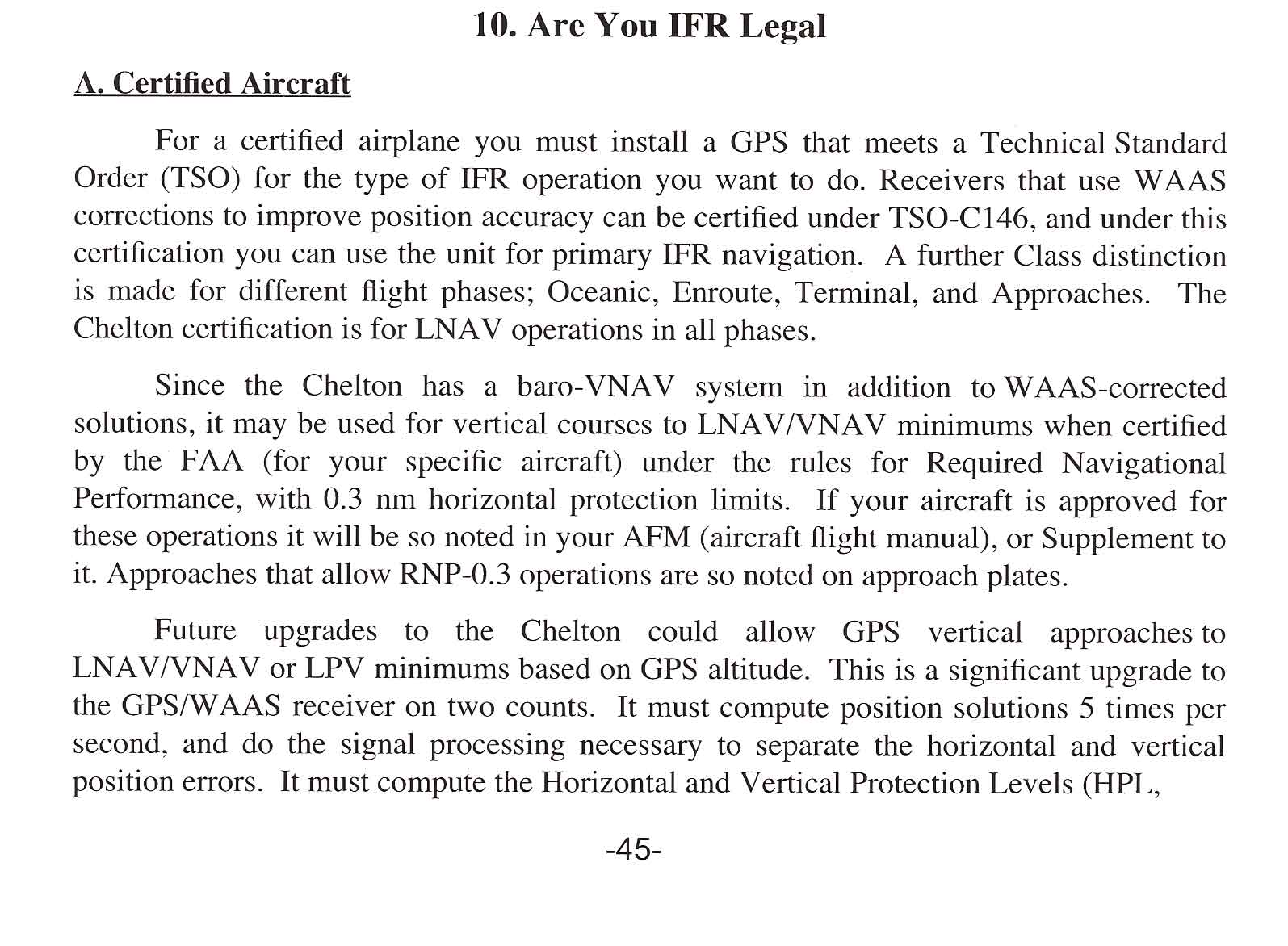

PostPosted: Mon Jun 16, 2008 2:16 pm    Post subject: IFR GPS Reply with quote
Linn,
I've attached are a couple of pages from Keith Thomasseen's great book on the Chelton's, I hope he doesn't mind, that I think will help address your question. I think he's a pretty smart guy and I would trust his evaluation.
I have the Freeflight 1201 WAAS GPS, which is IFR certified and I use it as my primary source, driving my Chelton's. I have standard steam gauges to backup the Freeflight/Chelton's.
I hope this is able to help you out on your question.
Wayne Edgerton N602WT
flying and staring my flight to Alaska Saturday.
