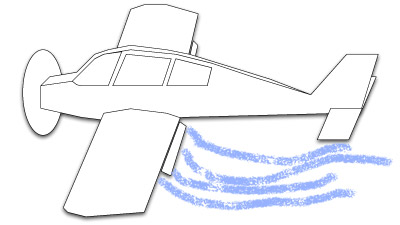

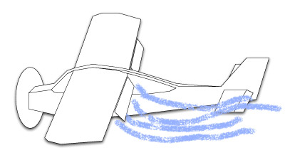

Michel wrote:
Anyway, I was on final with 10 degrees flaps and did a sideslip ... oops, it felt like my tail stalled! I am not sure and I didn't want to try again. Are you, guys, sideslipping with the flaps on?
Cheers,
Michel Verheughe
Norway
Kitfox 3 - Jabiru 2200
<pre>
Hi Michael
I heard before that the Cessna 172 should never be forward slipped with full flap (40deg) for this very reason. Full flap on the 172 is like opening the barn doors and the turbulence combined with a slip can mask the tailplane.
However in this case I am do not think that the Junkers type flaps on the Fox will generate that much turbulence and also the tailplane on the III is not really an aerofoil section, more of a flat plate really, so should not be effected as much.
It will be interesting to see if you encounter the same effects when at a high and safer altitude. My thinking is that the flaps on the Kitfox can also be used as a trimming device and work as such by changing the forward pitching moment of the wings with little drag penalty. Full flap will give a larger forward pitching moment which has to be balanced with greater downward force at the tail, ie. stick further back. At low and slow flight you would be more prone to the effects of of these pitch changes due to reduced elevator authority so it is conceivable that the bump you mentioned and the following downdraft may have reduced the lift, and pitching moment, of the wing but retained your tailplane force giving a sudden pitch up. In stable flight conditions the tail is exerting a downward force and any stalling at the tailplane should lead to nose down pitching. Let us know how you get on.
Michel

Tom Beirne wrote:
Cheers,
Michel Verheughe
Norway
<pre>
Hi Michael
The reason for not slipping a Cessna with flaps deployed is because the little control rod that actuates the flaps has been known to bend with the induced loads. When you go to retract the flaps (like in a go around situation), the flap with a bent link will not retract all the way inducing a rolling moment. This has been know to cause a few wrecks. At least this is what my instructor / flight school owner / DE told me. I was used to doing full flap slips in a PA-12 and the first time I tried it with a 152 we were in he about knocked me out with a quick slap to the head. He then showed me the POH that noted not to do that.... The same held true with the 172, 180 and 185 POH that he made me read over and over before he checked me out in them.

Leonard sez:
If anything, it seems like loading on the flaps would decrease as
they are turned sideways to the slipstream. My understanding was
that it had to do with the way the flaps disturbed the airflow over
the tail surfaces in that attitude causing a loss of elevator
effectiveness.
I carried that no-slip-with-flaps-extended thinking with me when I
started flying Piper Cherokees but, of course, Piper does not
prohibit such a maneuver in those airplanes.
Mike G.

The geometry of the two designs is quite different so the airflow
will be quite different. Imagine the Cessna in a side slip with
those huge barn door flaps extended. The nose is down a bit and the
airplane is moving sidewise due to the slip. The disturbed airflow
from the flaps is striking the tail dead-on.
In a low-wing Cherokee with much smaller flaps, the disturbed airflow
is passing below the tail surfaces to a greater extent. Remember
also, Cherokees use a stabilator with a much larger surface area than
the Cessna's elevator.
There are plenty of high-wing aircraft, including the Kitfox, in
which flap extension and slips get along just fine, but it all has to
do with the geometry of the airplane.
Mike G.
Mike G.
