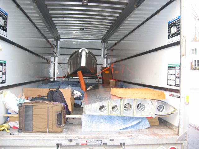

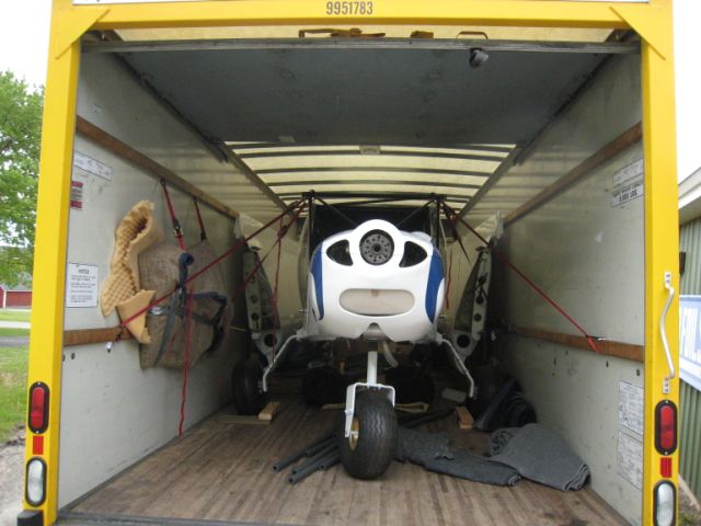

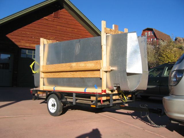

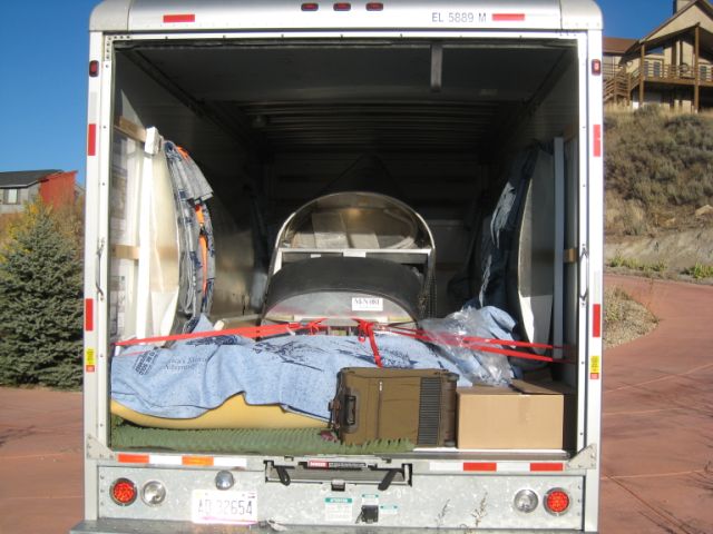

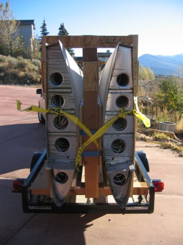

PostPosted: Tue Jun 03, 2008 10:32 pm    Post subject: Moving wings to hangar? Reply with quote

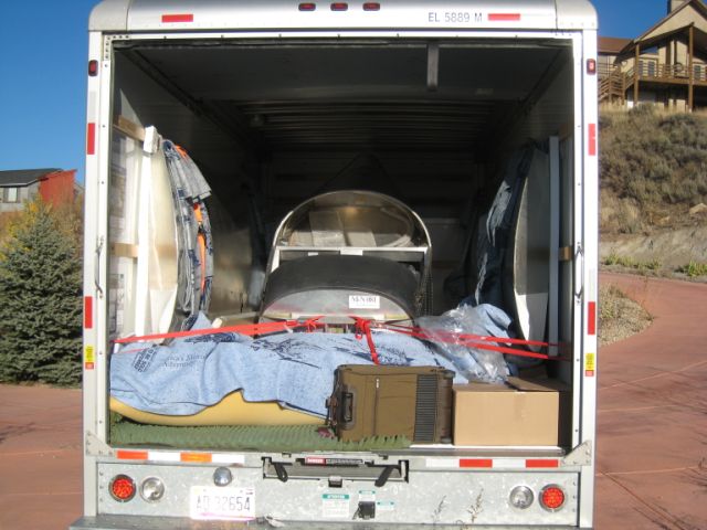

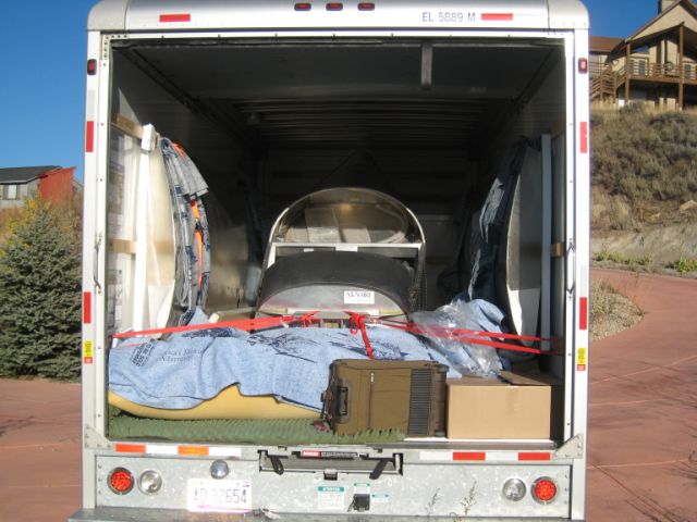

I’ve moved wings a lot of ways over varying distances: 20, 800, 1800 and
2300 miles. I’ve moved them may ways (pictures attached) and haven’t damaged
any yet. For two of the long trips the wings were hung from the sides of
rental trucks from straps padded with folded furniture pads. For the longest
trip the wings rode flat-side down on 2x4s padded with furniture pads. For
the short trip I just loaded the wings in their cradle onto an open trailer.
The set taken for the longest ride were painted white and *one* area under a
strap picked up what looks like ink from the folded furniture pad. These
were 701 wings with the leading-edge slats attached. Bottom line is the
wings are tough and weigh so little as to not require a lot of support.
-- Craig
