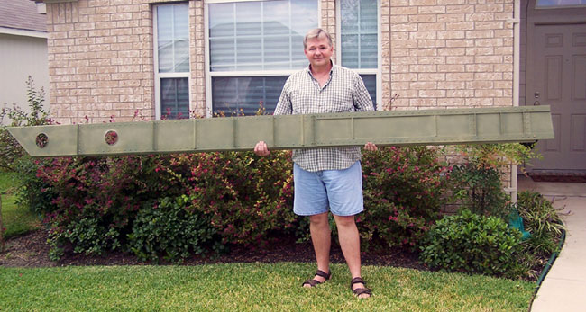

I think quite a few folks on this list have built their spars. It's fairly time consuming, but not extremely difficult.

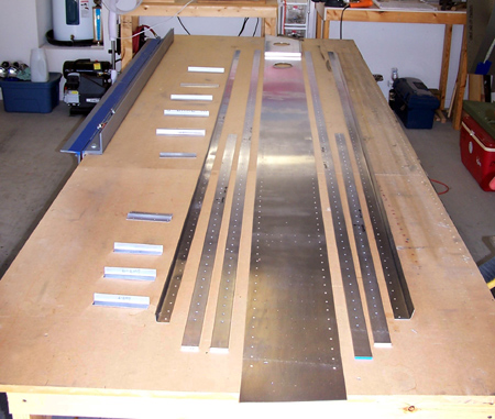

| Quote: | I built my spars from scratch, but when I ordered the .025 spar web, I
was surprised that they cut it exactly 209mm. That saved me a lot of
trimming. I managed to get the three sheets required for the ribs and the
spar webs plus a few extra pieces cut small enough to get it into my
station wagon. My spars are completely riveted and ready for ribs and
skin. The spars were not that difficult to drill and rivet, at least I
don't think so.. good luck Ron keep plugging.....Do not archive

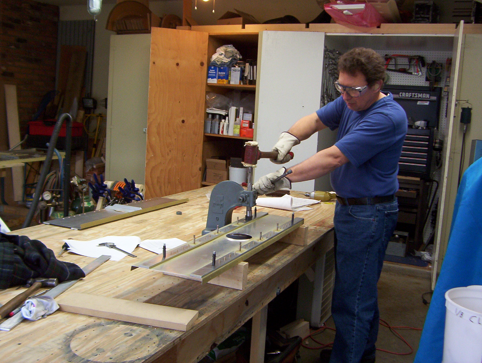

I built the spars for my 601HDS and found the process rather basic and
not too hard. I used a backing
block and 2-lb sledge for the first few, but finished it with an air
hammer and found air power to be much easier.
Bending is making a short sample, checking it and then going for the
finish piece.
I'm sure you could do it as well.
