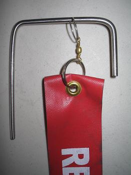

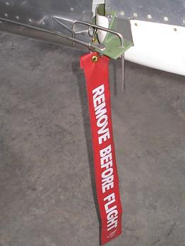

PostPosted: Sat May 31, 2008 7:39 am    Post subject: Gust Lock options/opinions Reply with quote
Perry,
This is close to what I plan on using:
$1.30
Light, compact, simple, tested
Remove as part of preflight.
Robin

PostPosted: Sun Jun 01, 2008 12:17 pm    Post subject: Gust Lock options/opinions Reply with quote
This won’t work on an RV-10 because of the way the rudder stops are arranged.

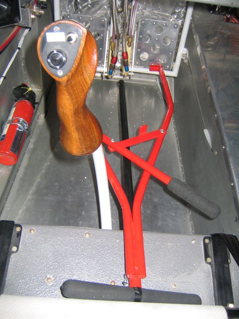

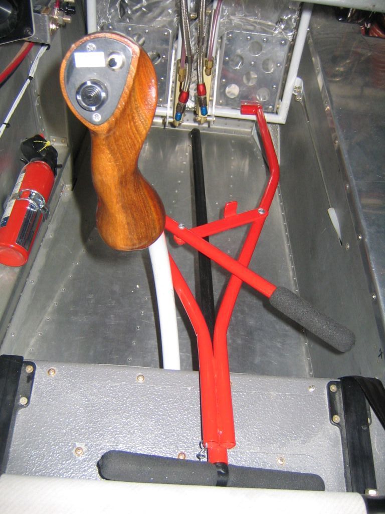

PostPosted: Sun Jun 01, 2008 1:18 pm    Post subject: Gust Lock options/opinions Reply with quote
We've just been doing this. It'll work even better after I cut about 1/8" off the end of the red tube. We have to pull the pin out so the handle collapes all the way down against the frame.

PostPosted: Sun Jun 01, 2008 3:49 pm    Post subject: Gust Lock options/opinions Reply with quote
We do something very similar, except when we trim the horizontal tubes to allow the towbar to fit around the nose wheel pant, we weld those onto the front of the towbar so they fit in the holes in the pedals. Then we usually leave the handle extended and up against the back of the seat and put the seatbelt up and over it to hold it down. Sometimes we put the stick up through the middle of the "Y" and then use the other seat belt to hold it back which holds the ailerons, elevator and rudder. It takes some time, but seems to work quite well. You can get a little play in the rudder, but not nearly enough to hit the stops. We've been happy with it this way so far.

robin1(at)mrmoisture.com
PostPosted: Sun Jun 01, 2008 10:01 pm    Post subject: Gust Lock options/opinions Reply with quote
Albert we are working on a mod to this design. Anything to add several hours to the build.
If we come up with something cool I will post the results.
Robin
