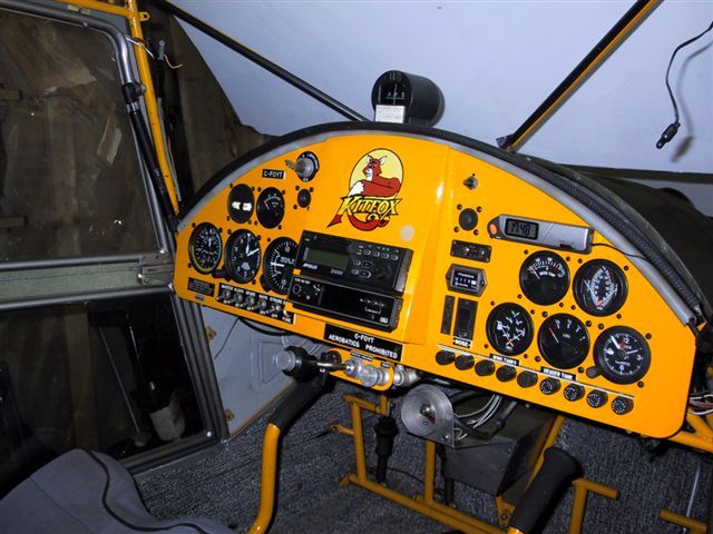

Posted: Fri May 23, 2008 2:48 am Post subject: Show us your panel!! |
Here's the pan[img]cid:001f01c8bcc2$314a9d70$6600a8c0(at)ogri[/img]el from C-FOYT.

Dave,
Where did you get your kickpanels? Jeff Classic IV Ktzr

Posted: Sat May 24, 2008 9:16 am Post subject: Show us your panel!! |
If you meant the carpet (normal plastic indoor outdoor) the panels are .020 cut to follow the tubes with about 3/4" extra. They are riveted through the firewall to stainless 1/2" "L" stiffeners from below the footwell bend in the firewall and "stitched" to the frame tubes with tie wraps the carpet is glued to the aluminum and the extra folded over to give a finished edge.
Not my creation it was done by a gentleman in New Brunswick, Glen McGuigan.
