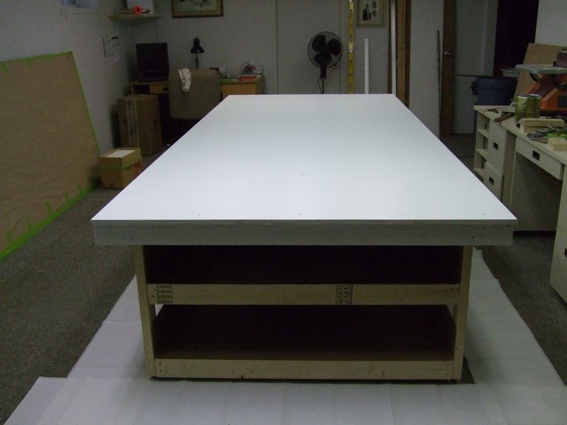

P.S. I have just completed, and painted my work table. A big thank you, to all of you who have taken the time, to send me your recommendations and tips. I built it slightly wider ( 62" ), so that there would be enough room to store the 12' sheets flat on the two lower shelves, making it easier to manipulate them by myself, since I work, and live alone.

Hey nice table!
