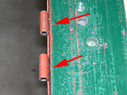

I have built one of you benders and have the bowing of longer pieces.
I have checked everthing and watched this thread and suggestions.
The rivet line as I have on my setup is 1/2 inch from hinge.
I think on the longer heaver bends I am getting flex in the stainless hinge
material opening bend in center.
I am going to try putting double the rivets but much closer to the hinge pin
hopefully reduce flex.
I will let the group know how it went after it is modified.
It is a good cheap bender Dave
if i can get this sorted it will be perfect
Thanks Graemecns

After looking closely at my Dave's brake last night and removing the hinge pin, I discovered what is happening is that the rivets aren't pulling at all. The hinge rolls are bending and coming away from the angle iron base plate. See photo.
The hinge is fine on the bending plate, as the stress is horizontal across the hinge leaf when the plate is rotated up to the bending position, thereby transferring the forces laterally across the rivets.
I'm going to straighten it, then tack weld the hinge at each of the rolls. Then I will bend no heavier than .025 with it. The rest I will farm out or buy the bits from Zenair.
BTW Andy, I'm interested in your extended Zenair brake in case this doesn't work, but I can't find the plans... can you direct me?
