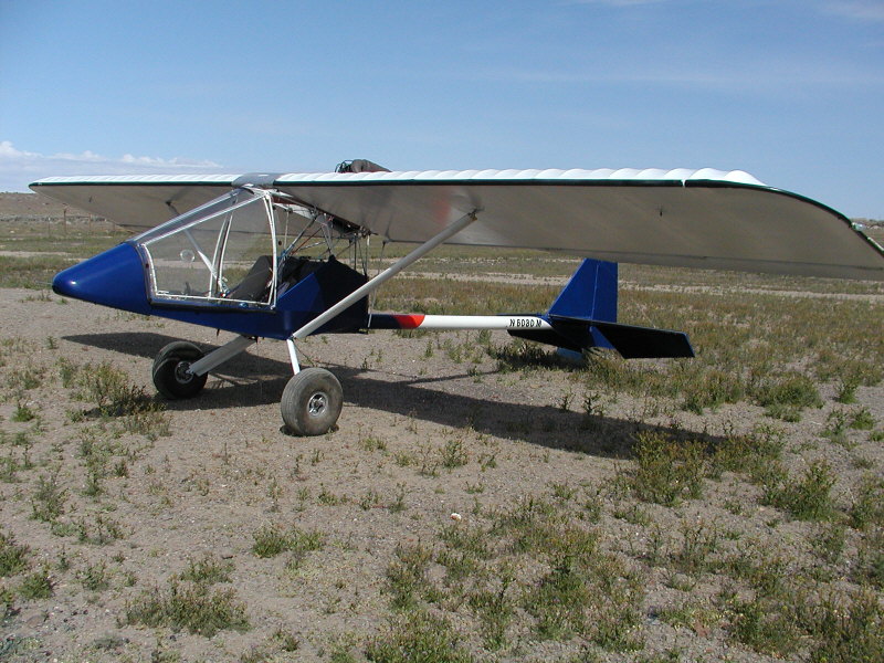

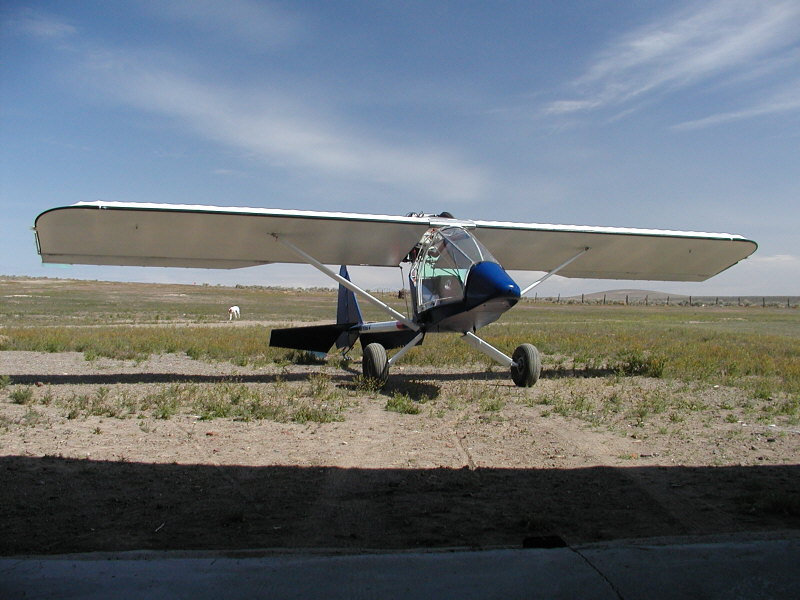

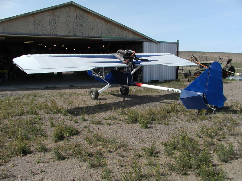

Gang,
things seem kind of slow, so here are the pictures of Dart. ( should rename her to Phoenix, she has risen from the ashes three times now) As you can see the new steel legs make her stand up a bit. Her flight characteristics seem to be the same. I intend to try to be a bit more careful in the future. At least I can be sure that the legs and axles won't fail me any more, but then again as I recall there was some problem with a loose nut on the stick. :-/
Larry C

planecrazzzy
PostPosted: Sat May 03, 2008 11:18 am    Post subject: Re: 50 foot paint job Reply with quote
Looks like "Brand New"
Way ta go Larry !

PostPosted: Sat May 03, 2008 11:38 am    Post subject: 50 foot paint job Reply with quote
Looks good from here, and I'm only 3 feet away from the screen.  Those streamlined legs?Even though wheel pants LOOK dandy, streamlining legs will reduce drag as much and all you need
is a couple pieces of sheet metal.
BB

PostPosted: Sat May 03, 2008 11:50 am    Post subject: 50 foot paint job Reply with quote
Larry C:
Keep it up.
Looks like you are getting good at building FS's.
Looks good.
Have you flown it yet.

PostPosted: Sat May 03, 2008 12:18 pm    Post subject: 50 foot paint job Reply with quote
Yes, I have flown it twice, no problems, no difference other than being a bit higher up in the air when I touch down.
Larry

PostPosted: Sat May 03, 2008 5:54 pm    Post subject: Re: 50 foot paint job Reply with quote
Looks good Larry! I will be taking lots of pictures of your gear legs when I get there.
