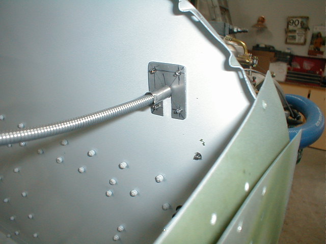

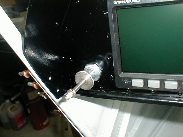

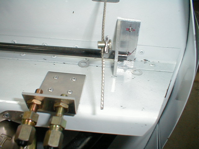

PostPosted: Sat May 10, 2008 3:34 am    Post subject: Re: Throttles Reply with quote
I purchased 2 from ACS and remove the friction ring from the passenger side. This was so it would not inadvertently tighten up where I could not reach. Worked good other than i need to make some nice knobs as the ones that came with the cables are pretty large and ugly. I am running with the center stick. I attached some pics showing the bracket I made for the Firewall that works great to hold the cable. Flexible cable will probably give you a little more flexibility on the position of the throttle handle as well.
