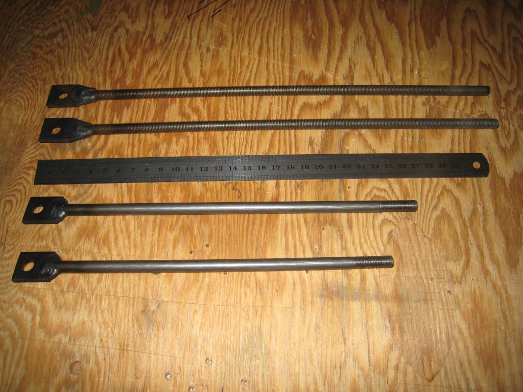

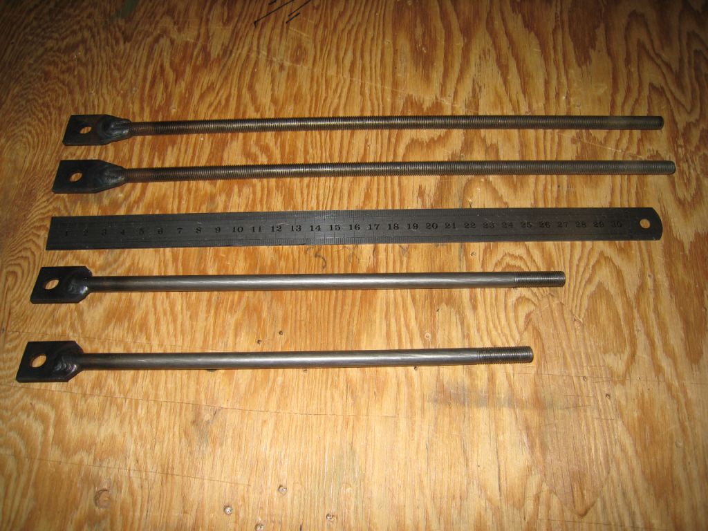

I received mine the other day and have attached a picture of the old and new
rods. These are revision 1 so the full part number is 6G2-4/1. You will
immediately notice that the rods are shorter than the older fully-threaded
rods and are of unequal length. The two I received are 255mm and 233mm from
the tips of the threaded ends to the center of the holes for the rudder
pedal bolts. For the old rods the plans say "length=310 (trim to fit)". Of
course the reason the two new rods are of different length is because the
rudder pedal bearings are staggered fore/aft by 32mm (6B9-4). With the older
rods a tall or short builder had the option of trimming the rods to move the
neutral position of the actual pedals fore or aft. With the new rods any
builder still can make some adjustment (maybe 10mm) by adjusting the
threaded rod ends.
