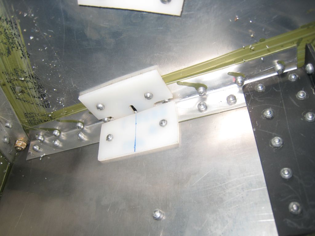

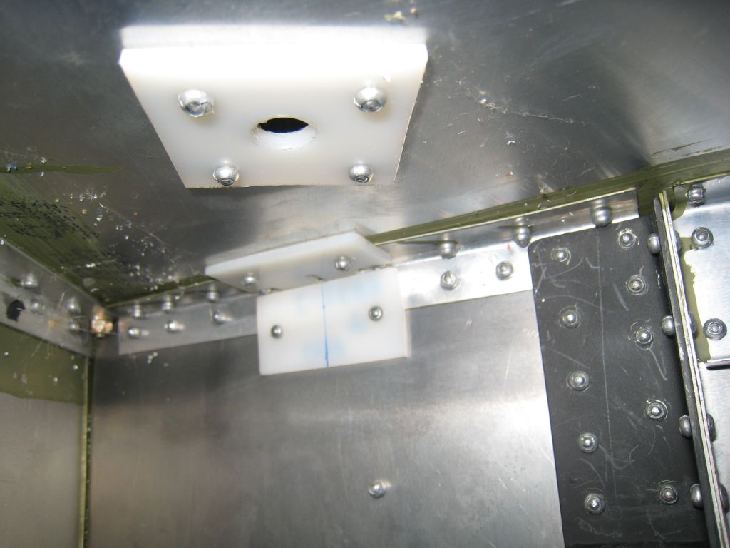

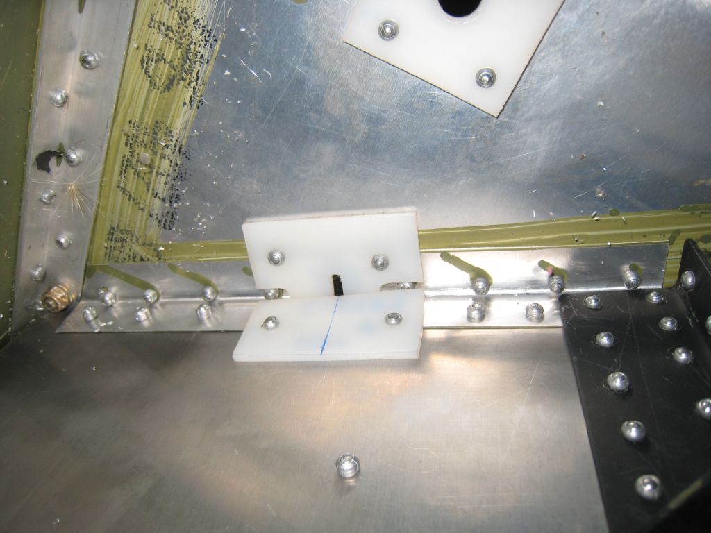

I am really confused about aileron fairleads. I am clear about the (primary) cable fairleads and the middle balance cable fairlead.
However, on Drawing 6-B-22, at the extreme lower right corner, it calls for one 30 x 60 balance fairlead with a slot; and two 30 x 60 balance fairleads with no hole or slot.
The drawing above this calls out "Middle Balance Fairlead 30 x 60 (4 req'd). 2 pieces: one riveted to 6B11-2 (which is the side skin), the other to 6B5-1" (which is the seat back support); with an arrow pointing to the drawing.
The drawing shows the location of the fairleads attached to the side skin; and shows a 30 x 60 fairlead with a hole in it running parallel with the seat back support.
This just doesn't make sense to me. I can't tell what goes where. Someone straighten me out - PLEASE!

Hold on! I think I figured it out. The missing piece is on the drawing of the balance fairlead with a slot. It doesn't call for two of those.
As I see it, the plain 30 x 60 pieces are riveted to the seat back support up against the inside of the side skin. The pieces with the slot are riveted to the side skin to hold the cable very near the plain pieces.
Have I got it right?

The one on the side skin is the thru fair lead and the one on the seat back is just to keep it from rubbing the seat back and rivets. It looks kinda like an L when you are done. If you need any more help I can try and explain it over the phone if you want to call me.

Yes, see the attached shots.

Many thanks Craig. That's exactly what I needed to begin with.
