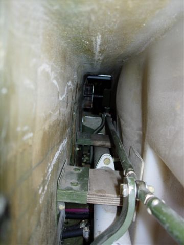

Following Arnold's picture I thought I would take one of my tank and the bulge therein. Very similar but without a leak so far (!!??) as I know.
Steve Pitt

While Baby Blue is in for repairs and installation of her new altitude
hold, I had occasion to look over the tank area, thoroughly. Sure
enough, I found evidence of contact between the center push rod and the
tank, right where you gents are point to. No real damage to the tank,
but it was definitely touching. I applied a bit of Velcro loop to the
tank area to guard against against further wear. I plan to either
reposition the push rod, or extend the brace to push the tank back into
it's intended shape. I'll let everyone know what I come up with and
supply a pic or two...
BTW, my new exhaust down pipe, just arrived. I'll install it tomorrow.
Many thanks to John and Rodger for the prompt shipping. I ordered it
one week ago, yesterday...
Jeff,
Baby Blue

I I remember correctly a few years back there was a change in the tanks from the factory, basically flourinating them to avoid these problems. Are these problematic tanks older pre-flourinated ones? Or are the new tanks also chemically inadequate? I'd hate to hear how much $$ a custom welded Alum would cost (let alone all the probs associated with weld quality leaks).

While Baby Blue is in for repairs and installation of her new altitude hold, I had occasion to look over the tank area, thoroughly. Sure enough, I found evidence of contact between the center push rod and the tank, right where you gents are point to. No real damage to the tank, but it was definitely touching. I applied a bit of Velcro loop to the tank area to guard against against further wear. I plan to either reposition the push rod, or extend the brace to push the tank back into it's intended shape. I'll let everyone know what I come up with and supply a pic or two...
BTW, my new exhaust down pipe, just arrived. I'll install it tomorrow. Many thanks to John and Rodger for the prompt shipping. I ordered it one week ago, yesterday...
