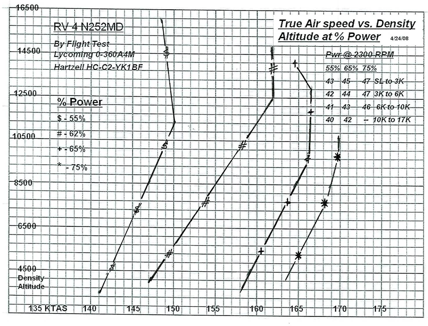

It is to me - and that is the most definitive statement I can make. I fly the #2 slot with Falcon Flight & needed the power and control. I find the fuel burn slightly lower at 65% or less at 9000 to 13000 density altitude - about 7.5 to 8.4 GPH - electronic (Electoair) ignition really helps here; I have had it on for 1500 hours. Attached is my home made (but reasonably accurate) performance chart. The "Pwr(at) 2300 RPM" is the MP + 23 = the value shown. Climb is enhanced & the C/S prop really is an excellent speed brake when you need it.

So what can you say about the performance of the 320/FP vs. 360/CS on the exact same RV-4? That's definitely an "all things being equal" example. I'm very curious to hear if all the extra who-ha is worth it (oh, and the extra $20k...)

Matt - I replace an 0-320 & F/P wooden prop with an 0-360 & Hartzell C/S. On advise of Van's, I left the battery where it was & find the CG is fine - mine is 67.16 aft of datum (at) 1030 Lbs. empty. Originally it was 70.03 (at) 916 Lbs. with the 0-320 & F/P prop. N252MD, 2160 hours.
Bill Gunn, TxDOT Aviation Division
