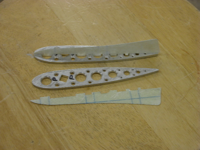

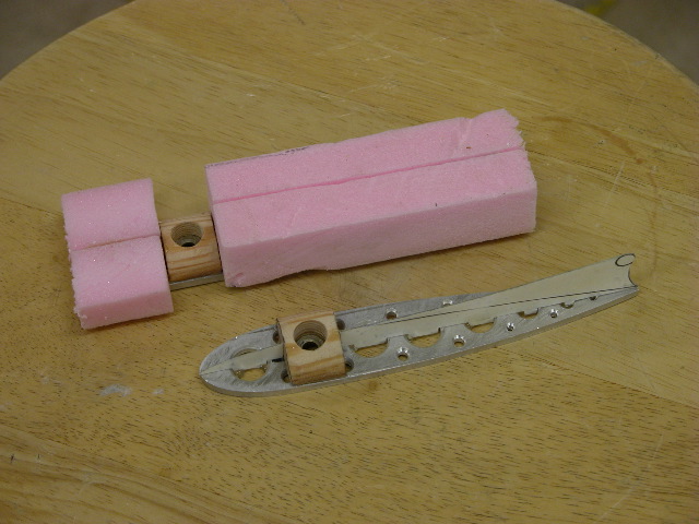

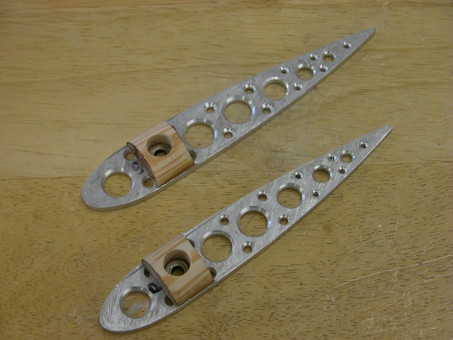

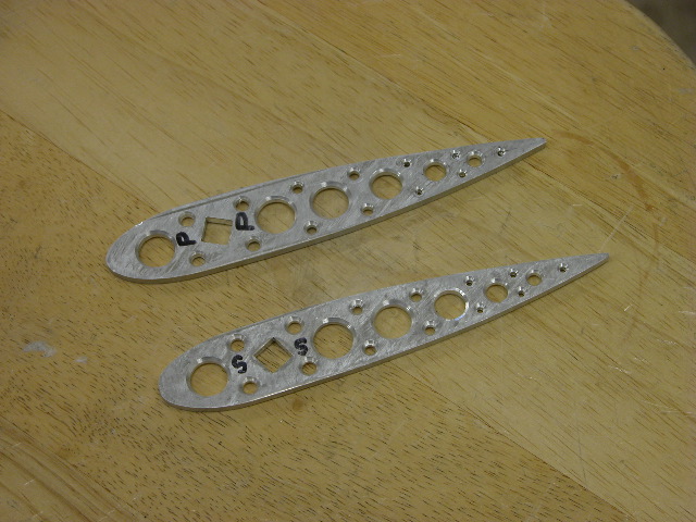

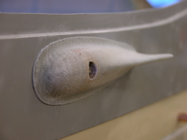

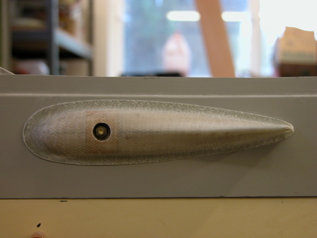

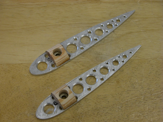

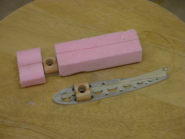

Craig...I thought someone would never ask...see pixs below
Fred

n100rh(at)sbcglobal.net
PostPosted: Sat Apr 26, 2008 5:23 pm    Post subject: External door handles Reply with quote
Fred,
One beautiful job you've done there. I will be using you're design Smile
Ralph

craigb(at)onthenet.com.au
PostPosted: Sat Apr 26, 2008 5:42 pm    Post subject: External door handles Reply with quote
I take it you havnt painted your bird yet, I just wonder if it might wear
the paint where the handle rubs the skin,or do you have a plan
with regard to that, other than that it looks good, and self locking which
is a bonus
fklein(at)orcasonline.com
PostPosted: Sat Apr 26, 2008 7:24 pm    Post subject: External door handles Reply with quote
On Saturday, Apr 26, 2008, at 18:40 US/Pacific, craig bastin wrote:
I just wonder if it might wear the paint where the handle rubs the
with regard to that
Craig,
Yes, that's a concern...still scratchin my head about it...expect to
find something superslick to coat the edges...maybe silicone,
teflon...any ideas?
Figured that was solvable and I liked the fillet w/ no gap for
moisture, lack of draginess...
(definition of "draginess": same relation to drag as "truthiness" has
to truth; i.e., it wants to have the appearance of minimal drag, it may
not however, though overall, it probably makes no difference,)
cheers,
Fred

dglauser(at)gmail.com
PostPosted: Sat Apr 26, 2008 7:53 pm    Post subject: External door handles Reply with quote
How about an ultra-low friction plastic? McMaster-Carr has PTFE in
adhesive backed sheets in a variety of thicknesses. see page 3507 (!)
of the catalog. Or should I say catalogue?
David
