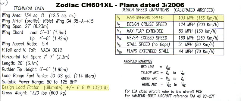

Either a operating manual or placards may be used to provide data such a maneuvering speed. The manner of compliance is specified by the type certificate. For example, the Cessna 172 only calls for displaying maneuvering speed starting with 1971 models, stating: This airplane must be operated in compliance with the operating limitations stated
in the form of placards, markings, and manuals.
MAXIMUMS
Normal Category
Maneuvering speed (CAS) 122 mph (106 knots)
Gross weight 2300 lbs.
I don't know if it was on a placard or in the manual after 1971. My 1968 172 had it only in the manual.
The attached info is from the XL plans dated 3/06.
Tim

PostPosted: Mon Apr 21, 2008 10:56 pm    Post subject: Zodiac XL - Maneuvering Speed Reply with quote
Not a dumb question, Jay.
I often forget what the white arc is for. Fortunately, the 1st page in the
plans gives the definition--the white arc covers the speed range between
the stall speed with flaps extended and the max flap extend speed. My 601
dwg, 6-X-1, gives Vs0 and Vfe as 44 and 80 mph from while Va, the
maneuvering speed is 103 mph.
