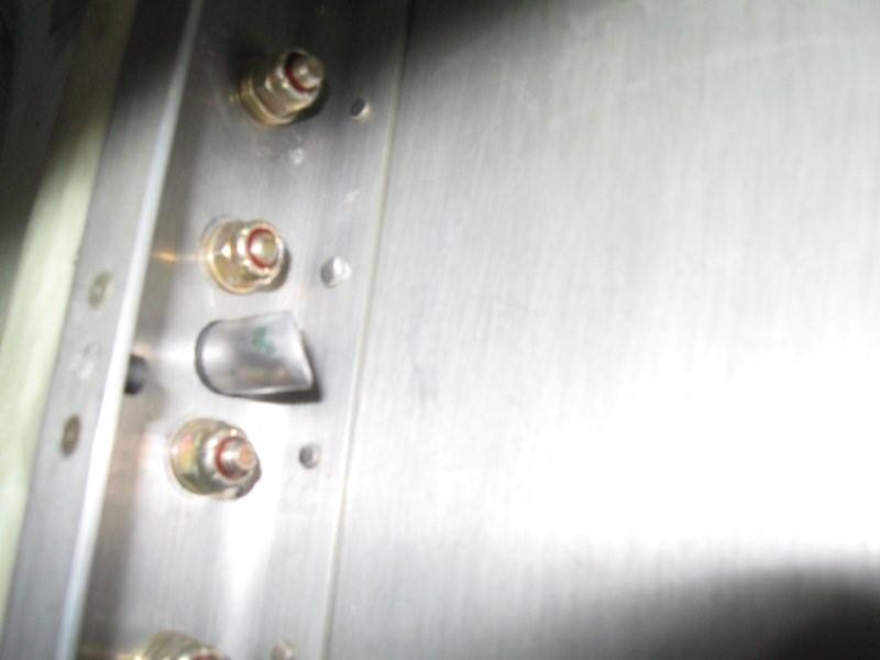

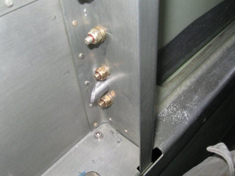

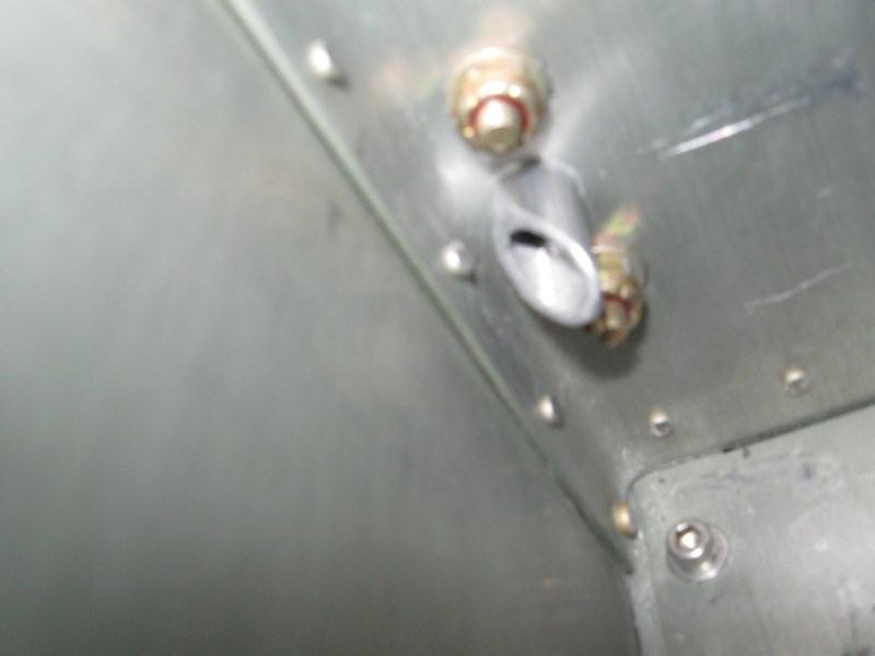

To ensure a complete circumference of the pin in the door jamb we lengthened
the pins about .25-.40 inch and shortened the bevel length . That is we made
the angle steeper.
