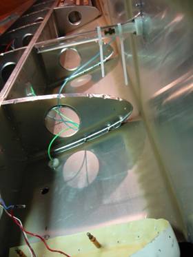

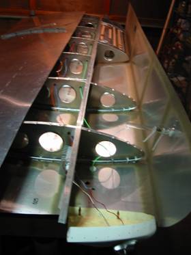

AFS's install manual gives some guidance on cord distance. I have embedded 5 pictures of the right wing of Mike Sigman’s 601XL (N7092N). Basically he placed the probes forward (but close to) the spar and outside (but close to) the outmost nose rib. Just don’t forget to offset the upper and lower probes so they don’t hit when you close the wing J.
My reading indicates that the placement is not extremely critical and that the calibration can accommodated a range of placements.
If the pictures don’t make it through let me know and I’ll mail them to you direct.
BTW: it is a good idea to provide a way to drain the upper port. If you look at the AFS documents you can see how they do this. you can build your own out of off-the-shelf parts: two flush static ports, some tubing and "T"s and a fuel tank drain.
