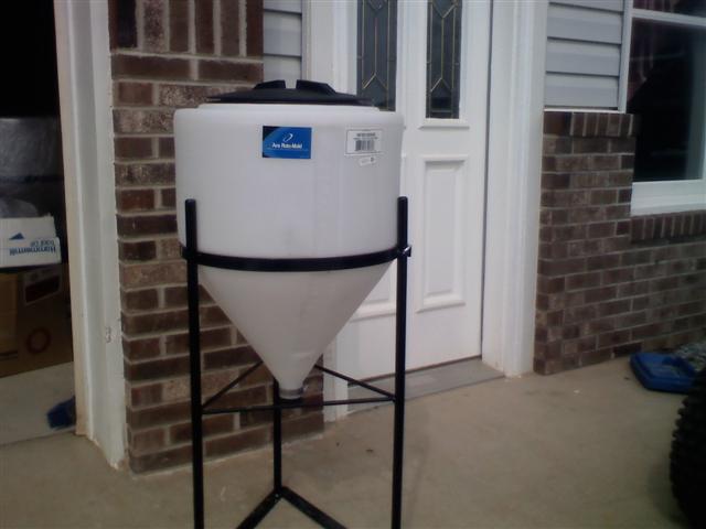

Ethanol can it be removed from fuel by adding water to this 15 gal tank (see Photo) If so what is the ratio of water to fuel? I plan on adding water and shaking it up. Then letting it sit and drain off the water and Ethanol off the bottom. Based on the fact that there is 10% Ethanol in the fuel how far below 93 does it lower the rating? Is there any thing that I am missing by doing this. I have 1995 model IV fiberglass wing tanks and do not want a engine out from the resin break down.
The waste could be used for cleaning parts and such.

How much water to use? Test to be sure. For 15 gallons of gas there is
only 1.5 gallons of ethanol to remove. If ethanol will in excess of 80% its
volume in water I would start with a trial of one quart of water. Then test
the gas with a jar or test tube. If it proves to be cleaned great if it
still seems to show ethanol in the fuel add another cup of water.
When mixing use an air operated agitator and be sure to let it stand for a
minimum of twenty minutes to allow the smallest "bubbles" of water to settle
to the bottom of the tank.
Also, you can siphon the gas off the top or on that fancy barrel just drain
the water off first.
