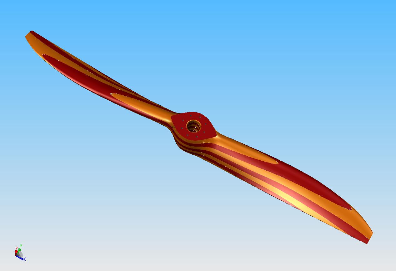

Jan
JC Propeller Design
attached a reason for wood prop.
 Filesize:  49.54 KB
 Viewed:  314 Time(s)

Thanks Jan... Very in depth, however, your idea that each blade at 40 inches
of pitch advances 40 inches with each revolution assumes no drag on the
plane... If that were true we wouldn't need props or engines at all.... I
made the same argument in school.
I was wondering if with each additional blade there is also an additional
root area which gives no appreciable thrust to the plane? And in fact can
increase load by pushing air at a flat cowl.
I agree with your reason for a wood prop.
Beautiful craftsmanship!
