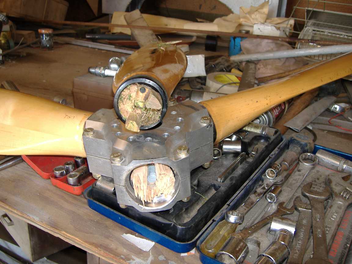

Rex, When you call GSC , Rick Peters will tell you the same thing -- 5 years !! REplace the blades. Hub will likely be ok but blades ..........hmmmmmmmmmmmmmmmmmm
I just ordered another one from him last week. Nice props and blades are cheap. I would get urethane leading edge on any new blade. TEll him i sent you and it will cost you more ... just joking it will likely cost you less if you order through http://www.rotaxservices.com/
look at my last post ..... here is pic again .

The 500 hr part would be from installation the 5yr part would be from manufacture.
These blades are wood. They are held to the hub by a smaller, comparatively speaking, root. Older props of this make have been known to break off at the root leaving a good portion of wood inside the hub. If your blades are loose and the hub is torque down so there is no space at all between the front plate and the rear plate then the prop roots have been damaged. The cells in the wood have been damaged , read weakened. The best thing to do with them is to make up a hub and use the blades on a wind charger ... or hang them in your den with a clock in the hub.
I wouldn't even ground run those blades. Blade departures aren’t unknown why take a chance?
I was in exactly the same position you are in and to this day I’m happy I bought a new prop.

Deke, I am not aware of any overhaul on a GSC prop. They are just a throw away unit as are most of the props we play with . You cannot magnaflux a wood prop and the weak link is in the root end.
Just replace after a set time and or hours flown to be safe.
