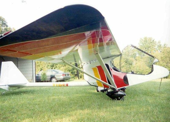

Almost done! Here is the official weight- 306.6 pounds. That is 254 dry, plus 24 for the BRS, plus 5 gallons of gas, for a target weight of 308. That is on a new digital scale. I had to weigh it several times, then weighed other stuff for calibration. It weighed the same, every time. I still need a gap seal, but I don't think that will go another pound. Here is what it is: Old model Firestar airframe with the high cockpit sides. Rotax 447 with 2 blade Warp Drive prop. BRS canister under the fuel tank. Full enclosure. Poly-tone paint on the pod, tube, and tail. Five rib KXP wings, modified to fit the cage. Aerothane paint on the wings. Old type skinny LG legs. 15-6.00x6 tires on three piece aluminum rims. Instruments- alcohol compass, ASI, tach, CHT, altimeter. No flaps, flaperons, brakes, pants, etc. Barn door ailerons. The bulk of the weight difference was removal of the padded wood used to keep the tail from moving in transit. I took off several stray antenna brackets, radio mount, and a strobe and bracket with no power unit. I still have to put in a five gallon overflow on the 10 gallon tank until I change it. Next immediate project is a dolly for moving the folded plane, probably like the one Jack H.built. Still looking for a trailer.
John- keep the updates coming! I am very interested in the difference with the droop tips. I still have two wings to re-build.
Good luck with the plane.
Bill Sullivan
FS/KXP
Possums
Joined: 03 Nov 2007
Posts: 247
PostPosted: Sun Mar 23, 2008 4:55 pm    Post subject: Firestar project Reply with quote
That is amazing - the pig I fly weighs in at almost 400 pounds empty
- it's beefed up, but still......
I like the old Firestar airframe with the high cockpit sides.
Feels good to strap into something solid & gives you something to
lean on in turns.
(took the back lift strut off - not necessary - unless you are doing
something stupid)

Possums- That is a lot more FS than I have. Better paint, too. I see wheel pants, brakes(?), double struts- front streamlined- and a radio antenna. Mine has single, round aluminum struts. My windshield just flexes, no hinge. The KXP wings on mine are full length-27' plus. It's hard to see your LG legs, but mine are the long skinny ones with a long taper. I also have a variety of other bent ones, including some short ones with a long taper. I have some spare struts like your front ones- Thom Riddle was interested in them, but they weigh 9# for the pair.
Take off all the extras and I bet you would weigh about the same- if you have the 5 rib wings. My spare wing set- the originals- are 5 rib "clipped" wings. Probably close to Firefly wingspan. If I repair and switch out I can add extras.
Bill Sullivan
FS/KXP
Windsor Locks, Ct.
Possums
Joined: 03 Nov 2007
Posts: 247
PostPosted: Sun Mar 23, 2008 11:09 pm    Post subject: Firestar Project Reply with quote
At 11:22 PM 3/23/2008, you wrote:
Possums- That is a lot more FS than I have. I see wheel pants,
to see your LG legs
My windshield just flexes like your's, no hinges too. Brakes - yes,
double struts - (don't need them) - uless you're are going to do
loops for everybody to watch on "YouTube".
The KXP wings on mine are (not) full length-they are 27' 6" with 8 ribs.
No.... I could not weigh about the same.

If you have 5 rib wings I believe that makes it a KX not a KXP. 7 rib was used on the KXP.
