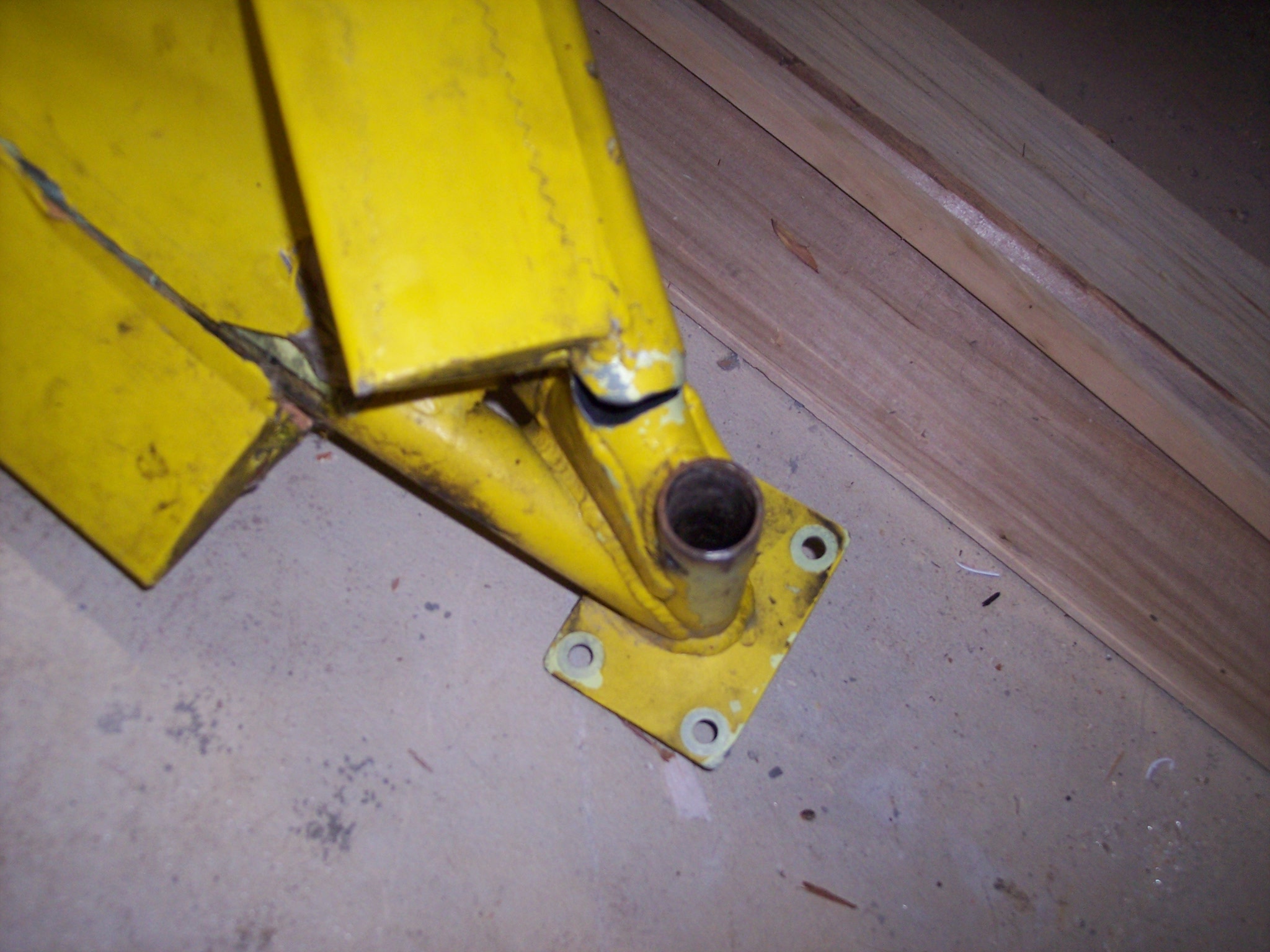

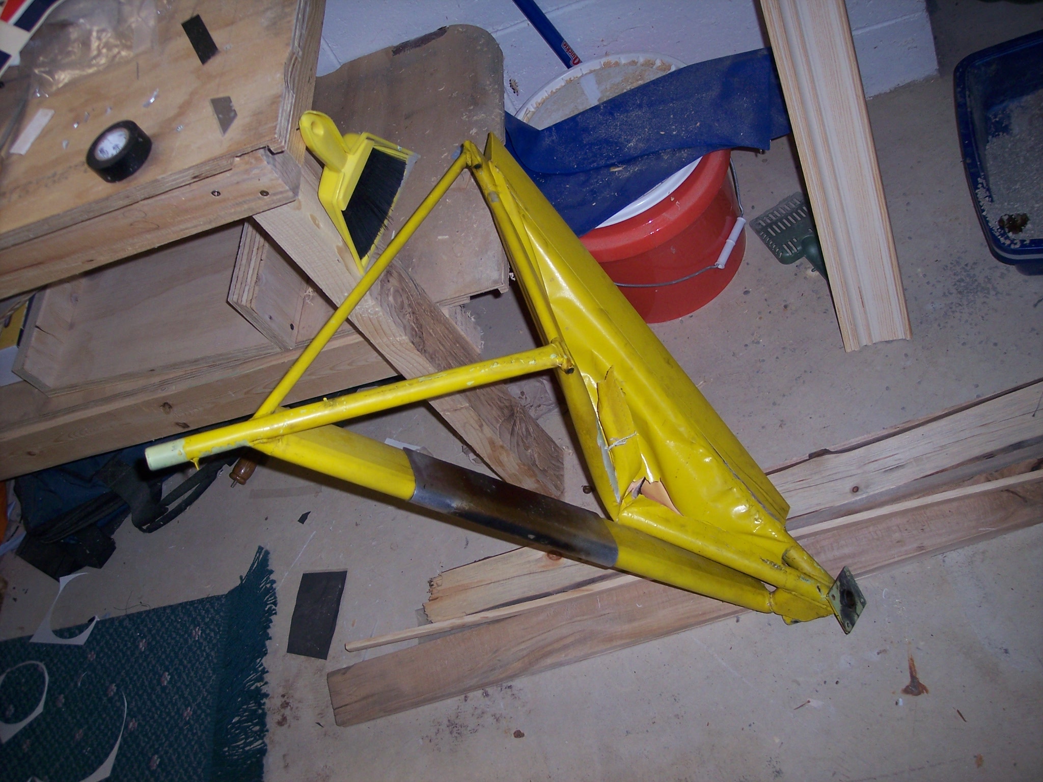

Some pics attached.
It was pretty strange. As I said, the landing was not bad, and the field was pretty soft, but right after touching down we heard a snap and the plane just kind of leaned over.
You can see in the pictures that the tube on the leading edge of the leg is bent and the strut that reaches up toward the bungees is cracked near its confluence with the rest of the gear. The fabric damage is the result of our official investigation, not the incident itself. No corrosion was found, and the crack in the strut appears fresh.
Luckily that's all that broke; we could have pretty easily wiped the radiator off the bottom of the plane or had a prop strike.

Thanks for posting the pictures of the collapsed gear leg. I see that the tube without a fairing attached is the one that failed. I was just wondering if epoxying a wood fairing on that front tube also would strengthen it. It shouldn't be too visible as long as the gear is covered.
If you haven't found them yet here is a direct link to a service letter on thew gear legs. http://www.kitfoxaircraft.com/support/service_letters/sl48.htm

I think I'd replace the whole gear leg. The cluster joints at the top
inside and the axel have been compromised and I wouldn't trust them. I
expect it would be easier to weld up another leg from scratch.
Did you hit anything in flight??? It looks like a bird strike without the
usual blood.
