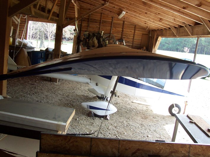

I am flying without the droop tips initially. The X has amazing lift based on a 13 foot wing panel. That is the same length wing as the FSII which has a two foot bow tip.

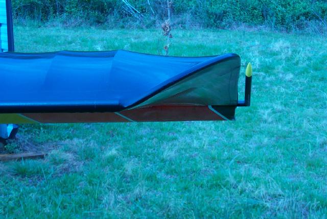

I fell in love with those new wings and droop tips ever since I saw that MK III Xtra at Sun and Fun last year. Increasing wingspan usually improves a planes performance, and from your report it sounds like it is working for the MK III Xtra. I cant wait to hear how it does with the wingtips attached. If your flight tests indicate a major improvement in performance, I will do the work to modify my wings to increase the span and put droop tips on my Kolb.
The one thing I was unsure about were the Aileron cables, how do they feel, any feeling of stiffness, or play, or not being up to the job ?

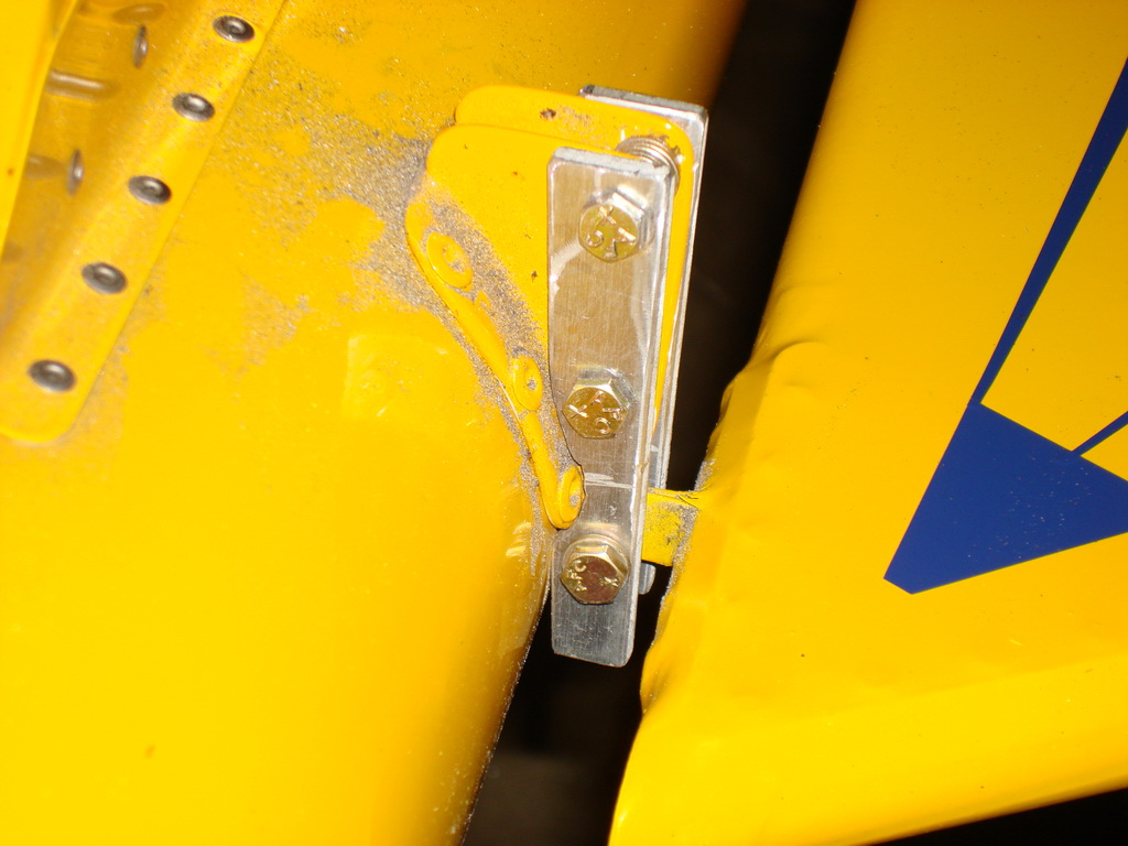

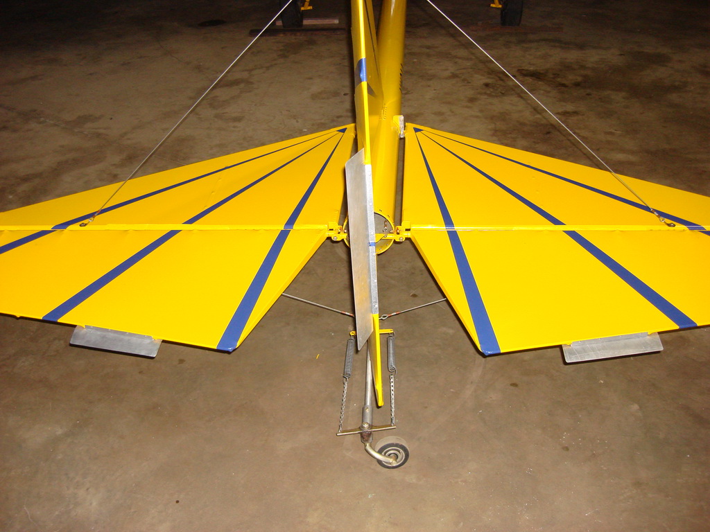

On my MK III Xtra, I had a pitch down trim condition and had to change the incidence on my Horizontal Stabilizer to 7.5 degrees down, almost double of what Kolb specifies. I also had to put trim tabs on with a bit of up trim to spread the load over horizontal stab and elevators evenly. It will now fly great with stock springs. Attached are pictures...
85 MPH cruise is fast ! What RPM are you using to cruise at that speed, and what RPM do you climb out at ??
I am looking forward to your report of how much the wingtips help, and also how the plane handles in calm air.

Brackets I built to move the leading edge of the Horzontal Stab down to 7.5 degrees and fix trim problem.

If you want the new X wing you will have to build them. They use a 13' main spar instead of an 11'. Probably would not be wise to try and splice two feet of 6" tubing to the end of what you already have.
I mentioned cruise and climb rpm in my original post above.
I am pleased with the new Morse Cable aileron controls. We are still adjusting attach points on the rear aileron bell crank to get the mechanical advantage to suit me.
Seems to me you have probably gone overboard on lowering the leading edge of the horizontal stabilizer. That may be killing your cruise speed. Learning how to set up a Kolb has a lot to do with how it performs. I know of two other MKIII Classics that cruise same as my mkIII. They are also configured the same as mine. One is powered with an 80 and the other with a 100 hp Rotax.
If it was my airplane, I'd double up on the pitch trim springs and get the horizontal stabilizer back up a bit. Changing the angle of attack of the horizontal stabilizer also changes the ability of the aircraft to stabilize in cruise flight. When mine is too low, it feels like it is flying on a ball, wanting to slide off fore and aft.
Another thing that may be reducing cruise on your airplane is the open area above and behind the cockpit. If you are flying with partial doors, that will also cut cruise. My mkIII is covered from top to bottom and the doors are complete. I am fully enclosed.

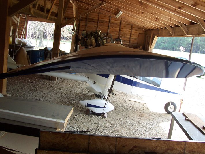

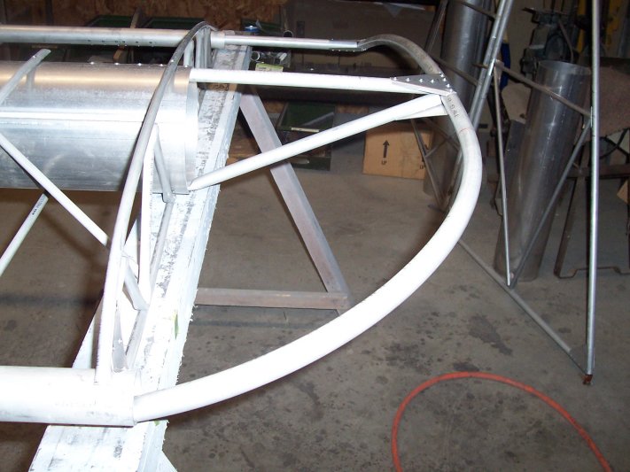

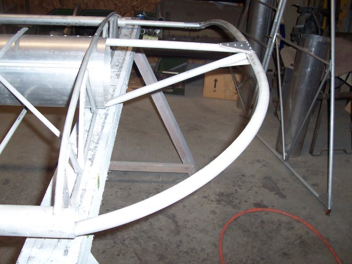

At 04:39 PM 3/23/2008, you wrote:
Thanks for the Report John H ,
Here is another way to do them so you don't get that
rattle out in the wings tips after 100 hours when the little braces break.
Also carries out the lift to the tips.

Looking at the bracket picture....
You've got Steel brackets....Stainless Steel angle brackets...
Then you make an aluminum connection ??
You've even got the aluminum "Scored" in it's weakest point....?

I plan on enclosing that area behind the cockpit with aluminum like you did and putting a V back there to get smoother airflow, I already have the materials, just have not had the time to do it. I have full doors on, just like the configuration you are flying right now.
I have tried the Horizontal tail at the 4 degrees, but felt like all the load was on the elevator. My Kolb flew fine both ways, and I did not notice much of a speed change, but I wasn't really looking for that either, so I will have to test fly that again and pay attention to any speed differences.
Splicing an extra two feet of spar on is exactly what I was thinking of doing. The stress on the spar towards the wingtips is minimal, I think a well done splice would be more than strong enough to add just two more feet of spar on each tip. I hope the weather improves for you, I am looking forward to hearing more about how your tests are going.
Mike,
What is the angle difference between the bottom of the wing and the
horizontal stabilizer? This difference relationship is what is important.
In the FireFly the distance from the boom tube front mounting ring to the
cage cross hole is very short. This being so, a small cross hole offset or
warp in the cage can make a large difference at the tail position.
Jack B. Hart FF004

Possum,
Are you going to mention what aircraft those tips are on ; )
Fly Safe,
Wade
Fly Safe! Wade

Those are the specific issues I was referring to, namely the nose down tendency of the Xtra wedge.
Yes, ALL the wings and stabilizers setting are different on the Xtra, compared to a Classic due to this
newer design.
Additionally, if one goes to the newer steel gear legs, which are taller, this also requires a
change in wing position...which requires a stab. reposition.
John H. says that Mike B's plane was built by Bryan Melbourne. Although I don't know much about this
gentleman, from what I understand he is one of the leading Kolb authorities. In other words, he knows
what the heck he's doing. Then why the radical remount of the leading edge of the hor. stab.???
Is it possible, just possible, his wings are mounted in the lower, aluminum gear leg position?
A quick answer to this question is: Mike B, at what location is your wing tabs drilled and mounted?
I was told by Brian that IF you have the steel legs, the tab is drilled at the TOP, on the wing root tab.
Have you checked??
BTW, when Mike B. stated his plane had a serious "nose down" tendency, I understood him to say he
meant during cruise, not just when adding power, the usual action of a high mounted rear engine. I
could be wrong, but that is what I thought he was getting at.

But, I'm still a little curious about the non-OEM suggested hor. stab. mounting
position, though.
Another question I have is: If you DID go 90 mph in your plane, does you're windshield
flex down? Seems like a lot of down force. I was just wondering.
Mike W
