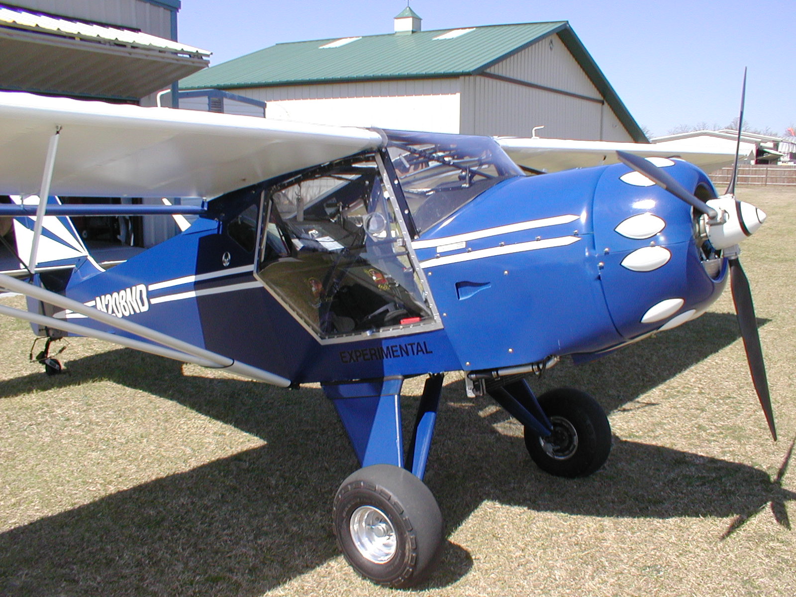

Good comeback Leonard ! Laughed my butt off ! Please excuse me guys. I am new to this list and to the airplane.I don't know alot of things about this aircraft,but I will. I have the original wheels(chrome) which I assume are Douglas one piece wheels.The shaved tires I have on them are ATV 20x7x8 and I would like to replace them as they are rather "long in the tooth" .I liked the look of the KingFox tires and now that I know that the Nanking tires are the same,I will order them.My only other questions are:
    1. Will they fit the stock wheels with no problem?
    2. Do I need tubes and will the stems shear off do to low pressure and
    tire/tube movement or is this a minor problem. Would a bead adhesive as used in jeeps help.
I don't fly off rough ground.My airstrip is grass so I won't be in the bush.( except when the people at the airpark get in a pissing contest over who is going to mow the grass which happens often) Occasionally I fly off of pavement. And besides, these tires look cool!
I am sending my elevator off to a small company to have an elevator trim installed. They will skin the elevator,reweld the tubing and install the trim servo/tab and then cover & paint back to silver. I am tired of the continuous back pressure required on approach. (lazy butt I guess) Also my oil pressure gauge is 12 lbs off so it will go back to Westburg and finally I can install the Nanking tires.
      Dick Maddux
      Fox4-1200
      Pensacola,Fl

I think you'll find that the Douglas wheels are not really chromed,
but polished aluminum...I might be wrong, but my two pairs are both
polished aluminum, and both one-piece.

I have the Kingfox tires on my MK IV and they fit on the Douglas wheels just fine. I don't have tubes in them, but I do have slow leaks that I can't get rid of if I run at rather low pressure. Tubes might be a good idea, but there is the extra weight and $. Jim Chuk Avids, Mn

Douglas wheels are not chrome just aluminum. King fox tires are great on sand rocks grass and work great on the runway also. Yes mine have a small leak but i cannot find from where I used a bead sealant and still did not help. Just run around 6-8 pounds and you have a great off airport tire.

Wheels are spun aluminum.
not one piece but 2 halves welded in centre .
Mine do not leak but i use high quality bead sealer. I did use dish soap and found that one would leak after a week or two. Go to ATV shop and get it done. I have my own tools for bead breaking and taking them off but if you don't you will take a while to change your tires. I can change two tires in under 30 mins including R & R from plane and de - mount and re mount.
