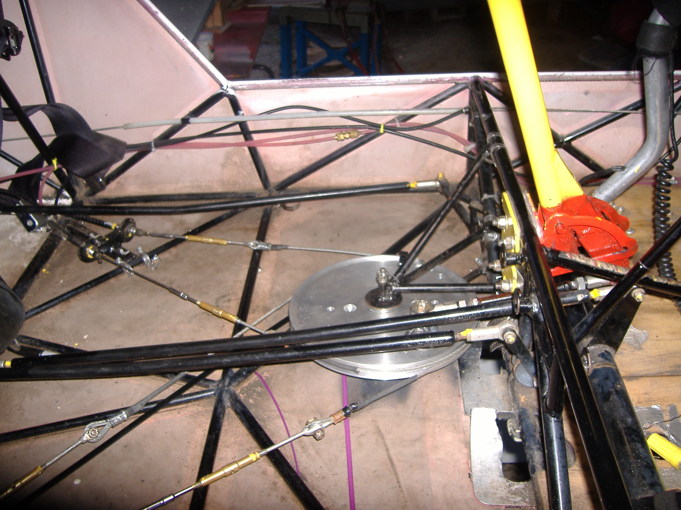

PostPosted: Sun Mar 23, 2008 3:49 pm    Post subject: Re: aerocet 1000 amphibs Reply with quote

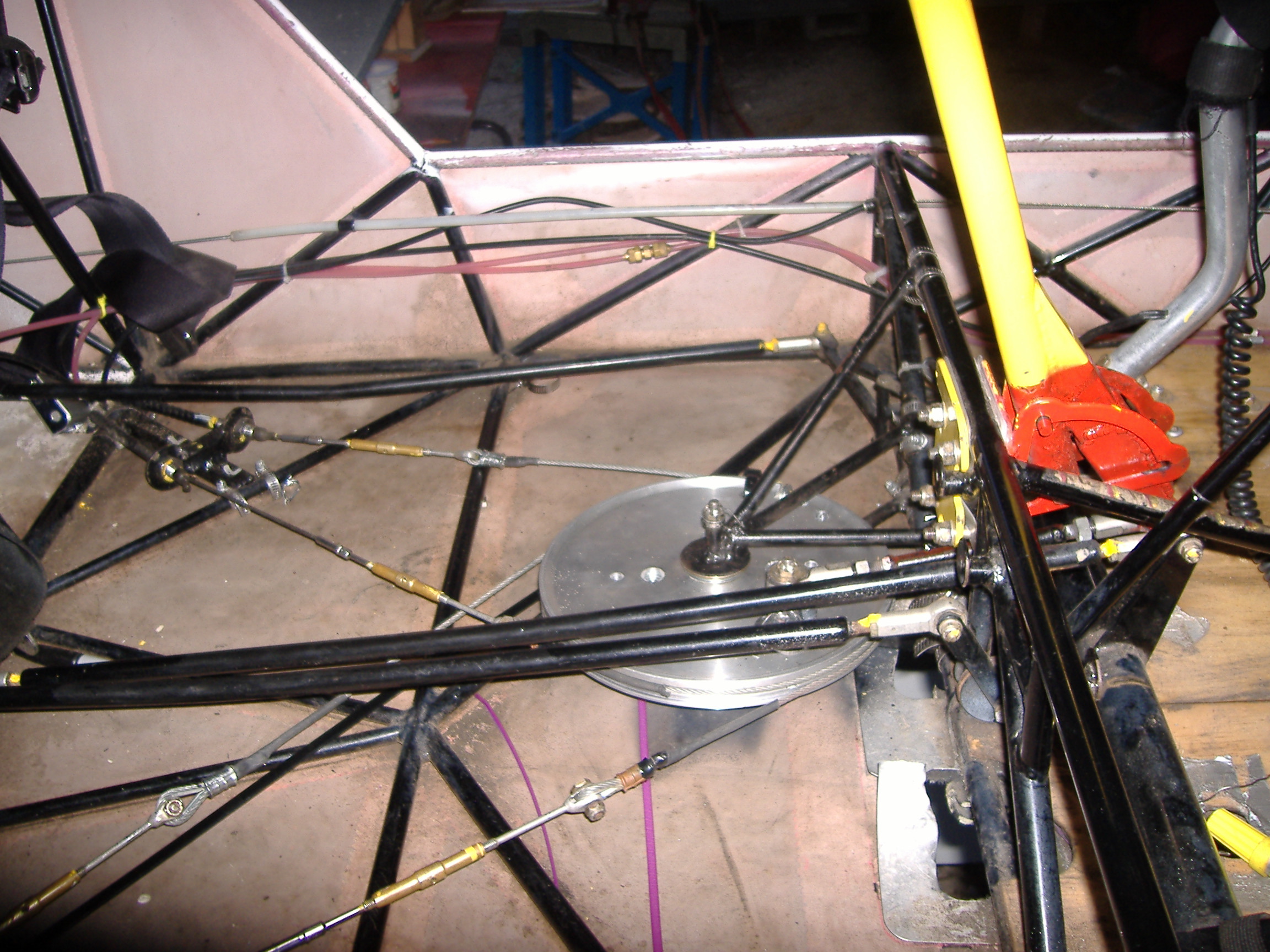

Here is what a IV looks like inside.
I made all hardware except the actual cables and the yellow johnson bar.

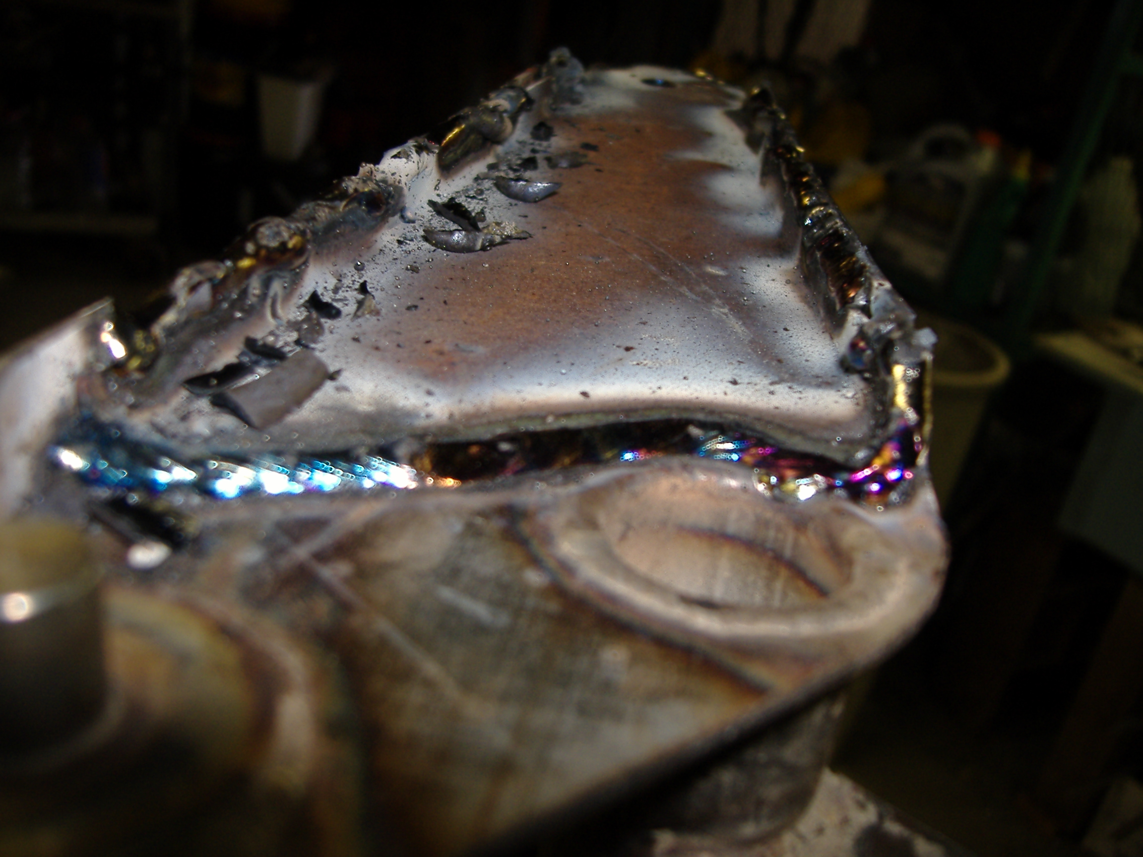

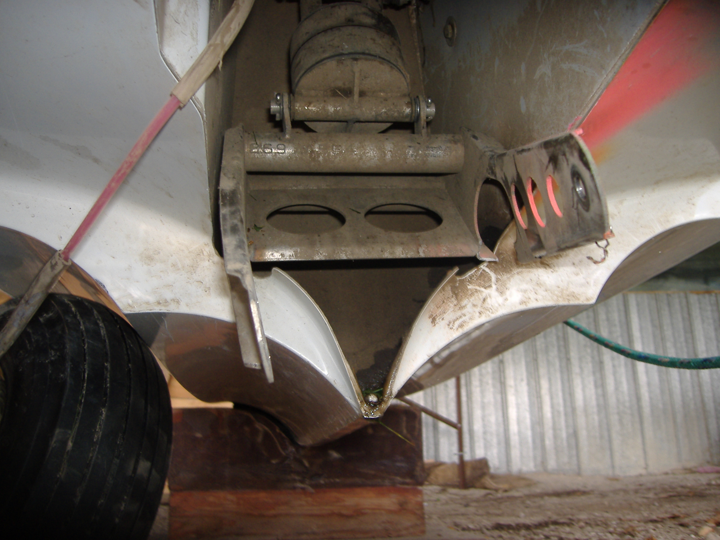

PostPosted: Sun Mar 23, 2008 3:52 pm    Post subject: Re: aerocet 1000 amphibs Reply with quote

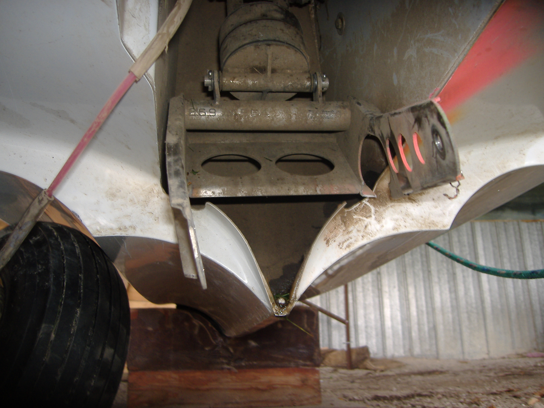

Here is why you should check your Aerocet Gear . If it is not re-enforced it will break in time .
 Filesize:  1.72 MB
 Viewed:  845 Time(s)
 Filesize:  1.47 MB
 Viewed:  840 Time(s)

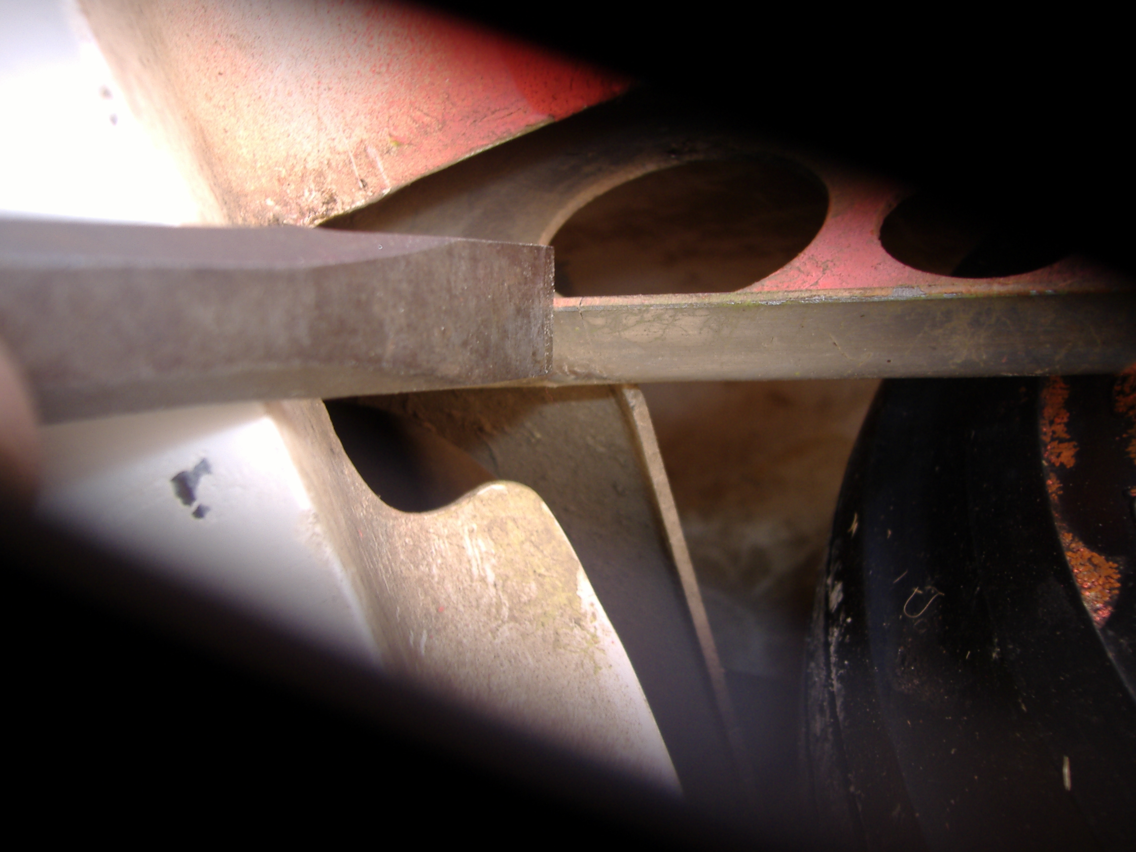

Here is what to look for tiny cracks will propagate eventually
look for cracks

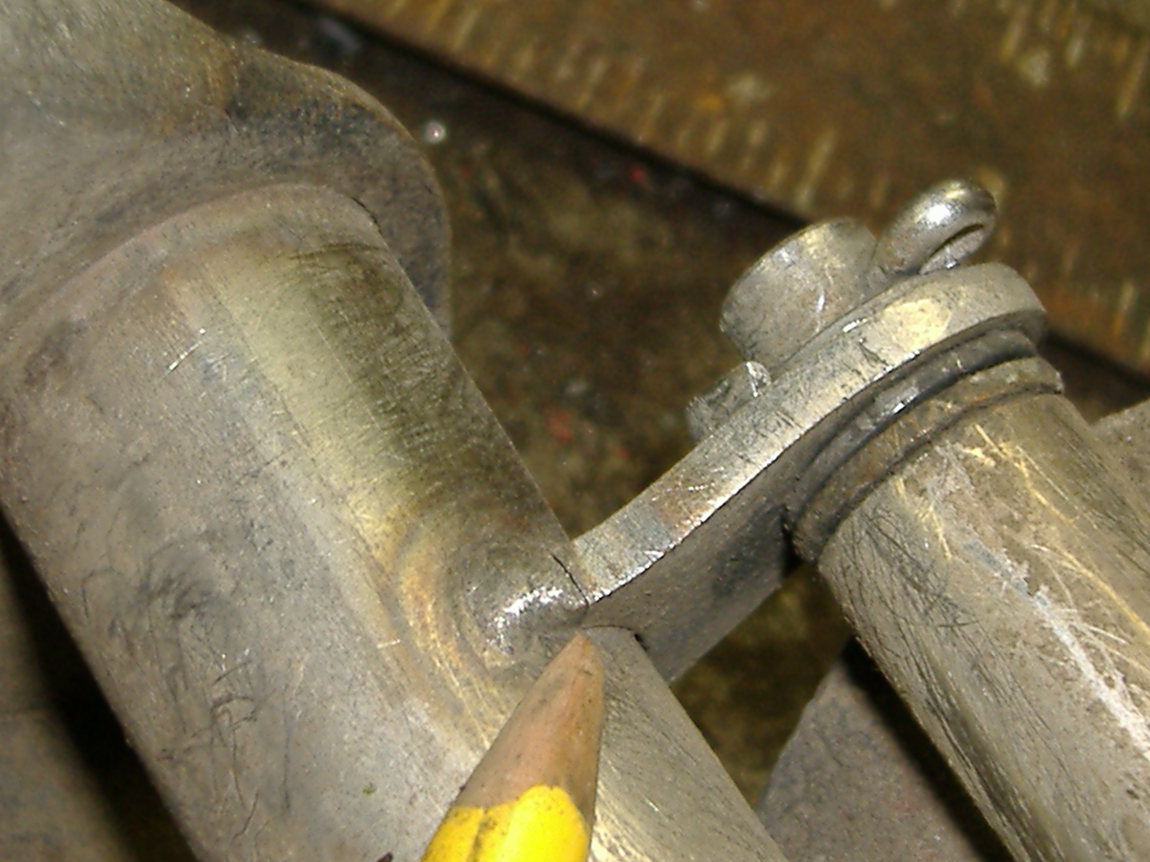

PostPosted: Sun Mar 23, 2008 4:00 pm    Post subject: Re: aerocet 1000 amphibs Reply with quote
Once you got the trailing arms looked at ,well pull your linkages out and inspect.
Here is a pic of what you might find.
Stainless steel fatigue
 Filesize:  1.11 MB
 Viewed:  848 Time(s)

Good stuff if you got the boxed trailing arms already but check all welds etc . Also I had one float where the top link ( where the pulley attaches) break out of the fiberglass. The cloth was dry so I can only assume it was never soaked with resin and it was weak there.

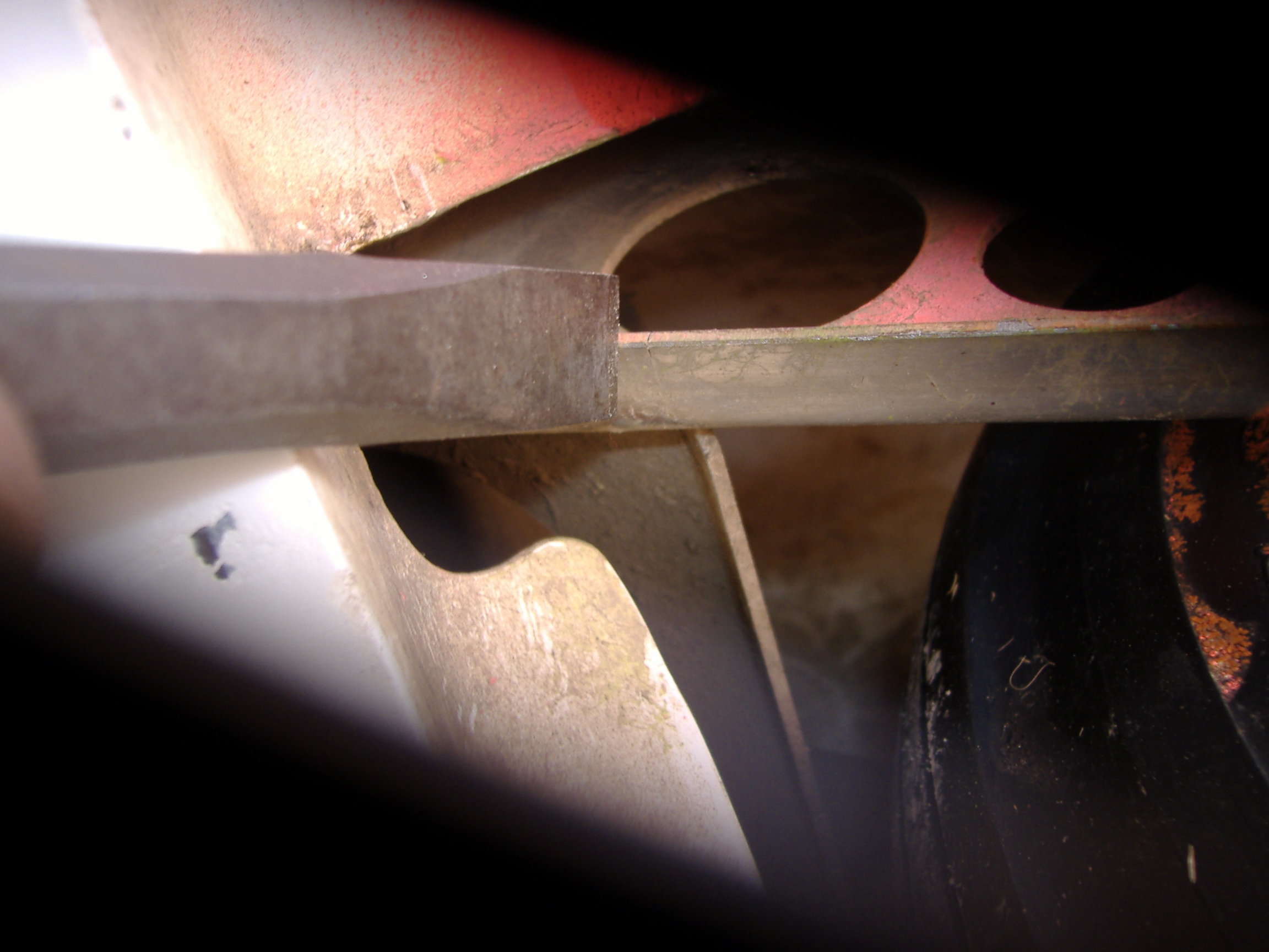

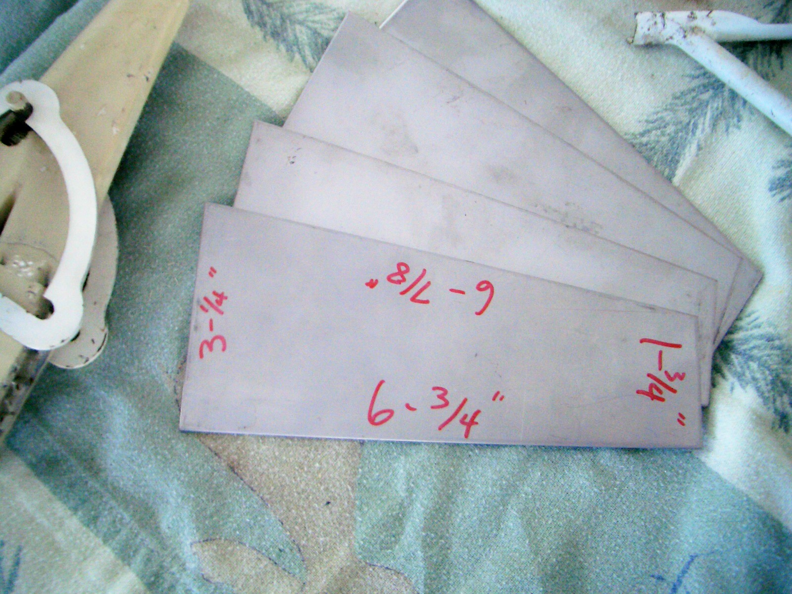

Louie- sent you a PM. I have the channel style gear legs and was going to weld four SS plates to the arms for reinforcement (see attachment). Before I do, however, I'd be interested in seeing a pic of your 'boxed' style leg if you have one handy. Was this a oem improved part or user mod? Thanks, Doug

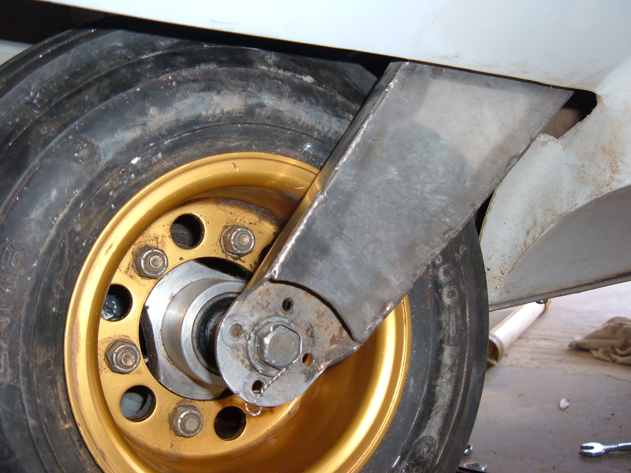

PostPosted: Mon Mar 24, 2008 1:52 pm    Post subject: Re: aerocet 1000 amphibs Reply with quote
Doug,
that looks like the plate that would change the channel to a boxed style.
I made mine out of 4130 channel welded inside of existing channel . Both ways should be alot stronger than OEM . I think the lightening holes was a contributing factor to the weakness of the trailing arms.
 Filesize:  1.24 MB
 Viewed:  734 Time(s)

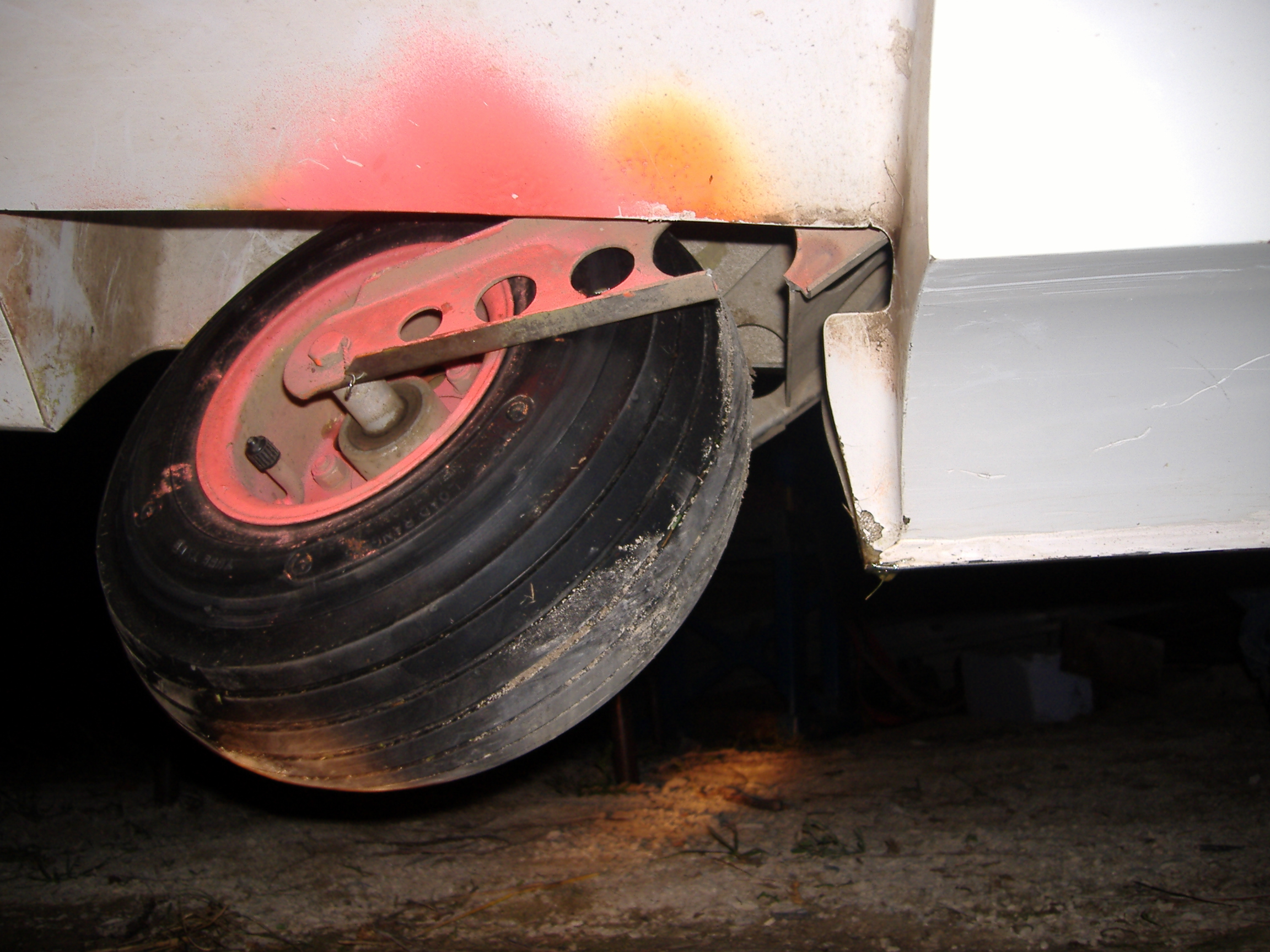

PostPosted: Mon Mar 24, 2008 2:08 pm    Post subject: Re: aerocet 1000 amphibs Reply with quote

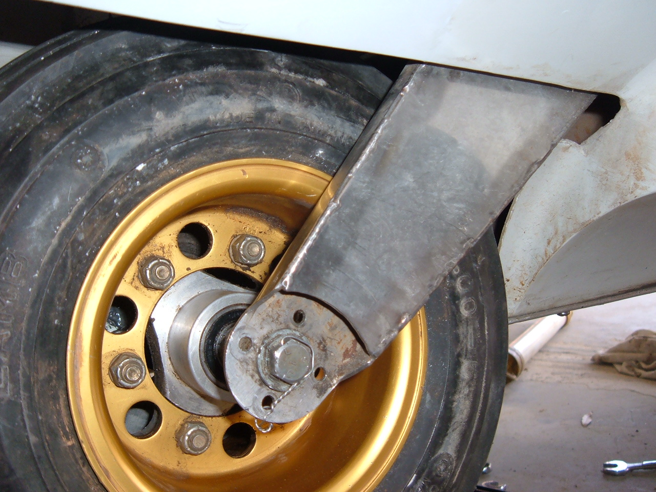

here is a pic of mine. This is the inboard side of the left main, but they all look the same. I believe that this is OEM, but I am not sure. I know that I like the looks of mine better than the busted up things that Dave has pictures of.
Louie
 Filesize:  468.63 KB
 Viewed:  695 Time(s)
dave
Joined: 22 Sep 2006
Posts: 1382
PostPosted: Mon Mar 24, 2008 2:36 pm    Post subject: Re: aerocet 1000 amphibs Reply with quote
Louie
Louie, that will re-enforce the trailing arms BUT you should look over every other part that I showed you are the welds do break. A cracked weld is easy to spot before it breaks away and If it does you will be looking are far more damage .
