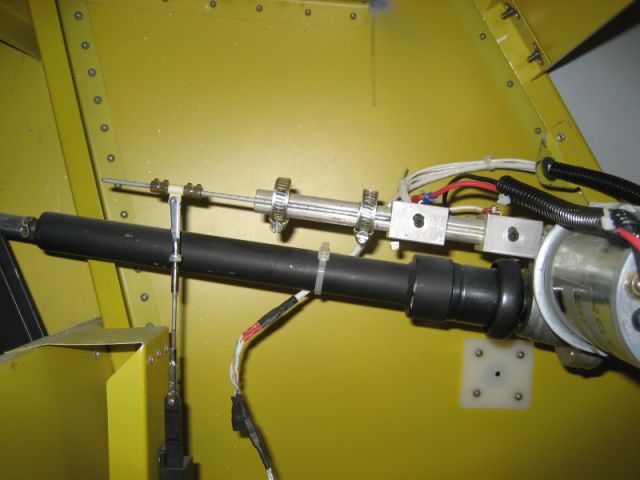

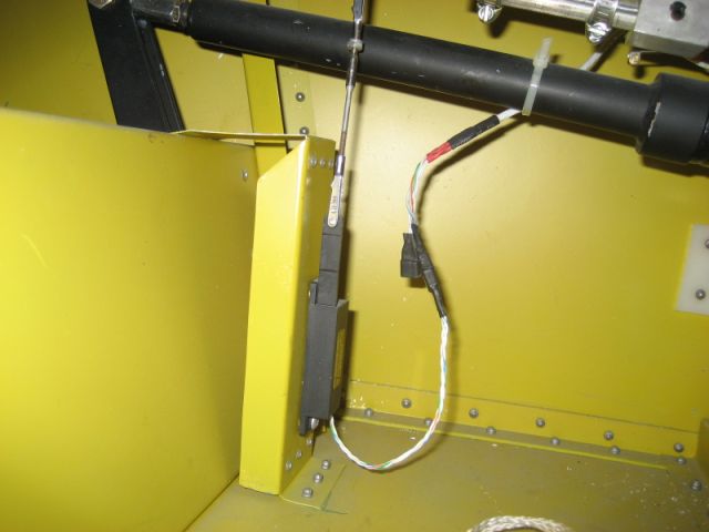

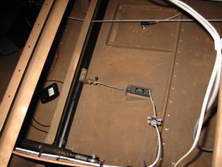

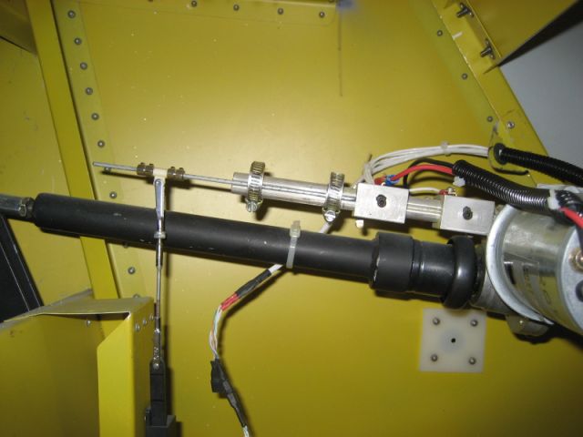

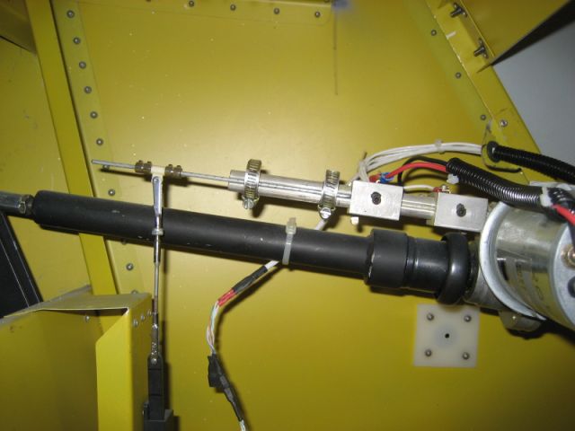

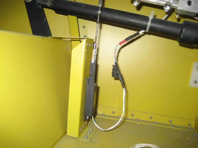

My experience is with the 601XL and I am not sure how things are set up on the 701. On the XL I have seen two styles of solution. In the first an arm is attached to the shaft that rotates to actuate the flaps. One end of the position sensor is tied to the fuselage while the other fastens to some point on the arm. Since the arm moves less than 1.2 inches at the tube (relative to the attachment point on the fuselage) and more than 1.2 inches at a point further out the arm you just find the point on the arm that moves just a bit under 1.2 inches. The pictures below are from Mike Sigman’s 601XL.
Ron Geese has a clever solution that doesn’t involve adding a arm. The flap linear actuator is tied to a fixed pivot at one end and an arm on the rotating flap tube on the other. So, again, somewhere along the actuator is a point where the mechanism rises about 1.2 inches across the whole range of motion. Just connect the sensor at that point. I attached two photos that Ron sent me.
