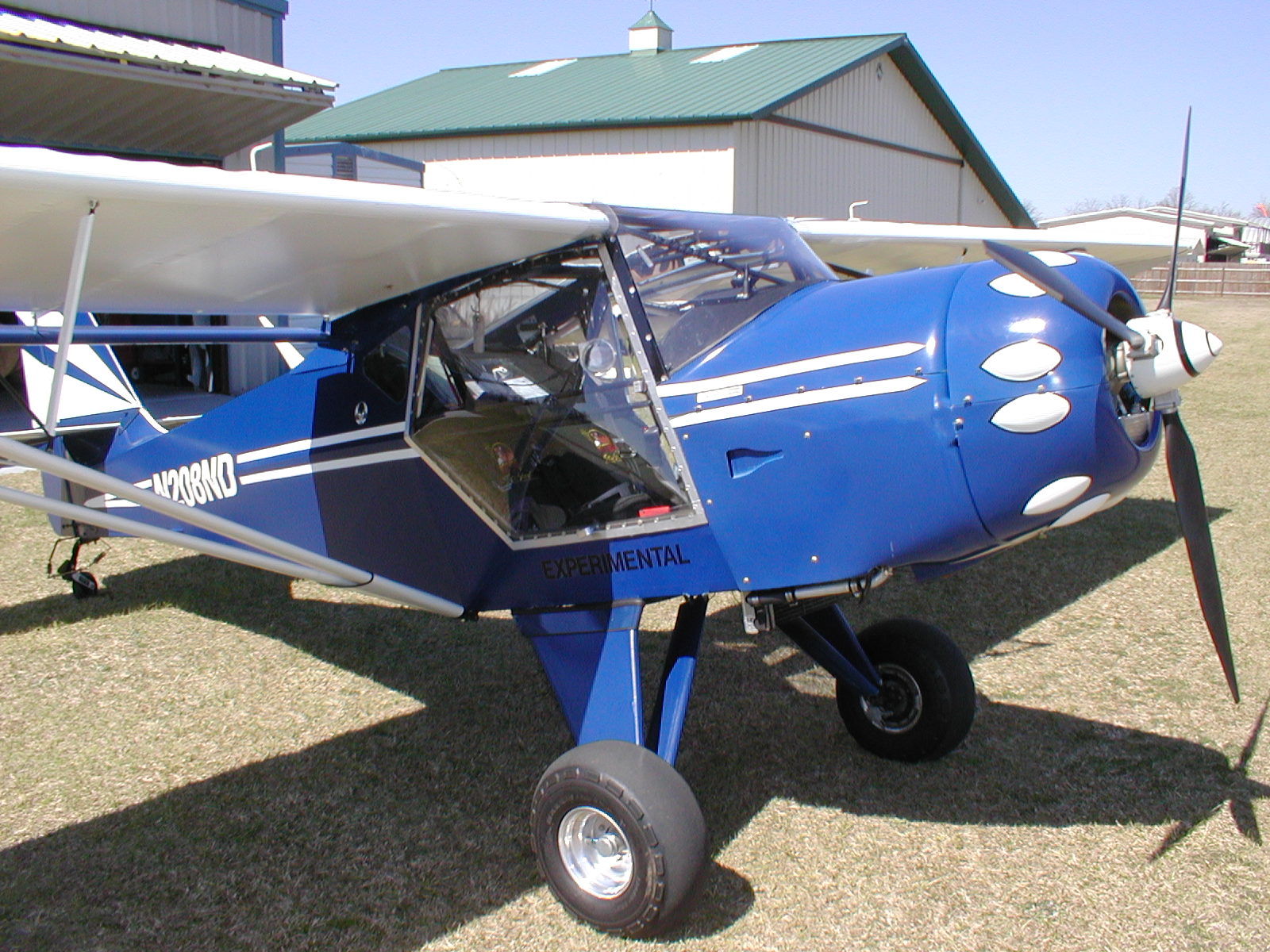

dave
Joined: 22 Sep 2006
Posts: 1382
PostPosted: Sun Mar 23, 2008 5:36 am    Post subject: Re: King Fox Tires Reply with quote
I got a truck load of them from Kevin at Mippi.
All sold out now for 40$ each.
Awesome tires. http://www.cfisher.com/kingfox.html

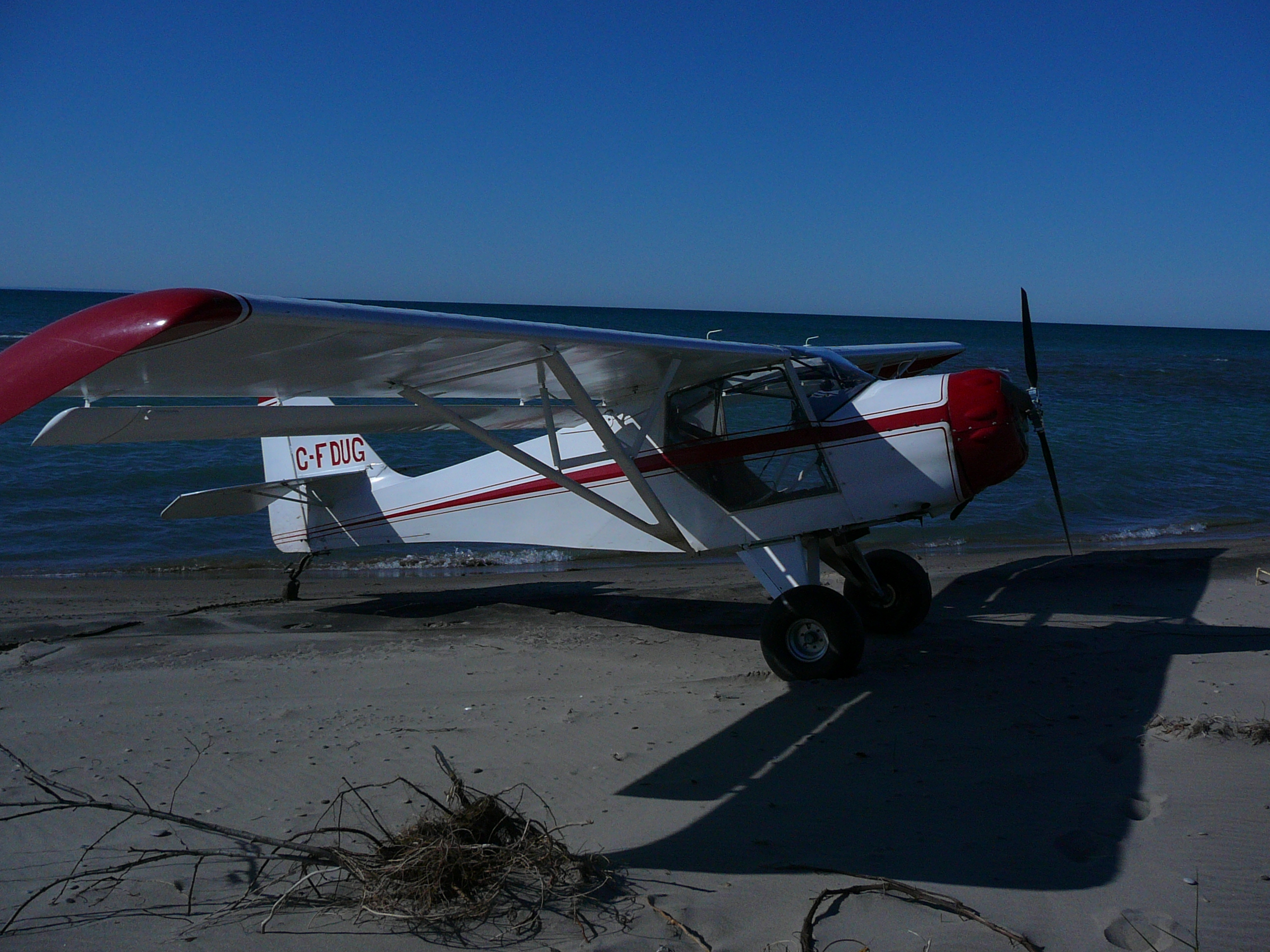

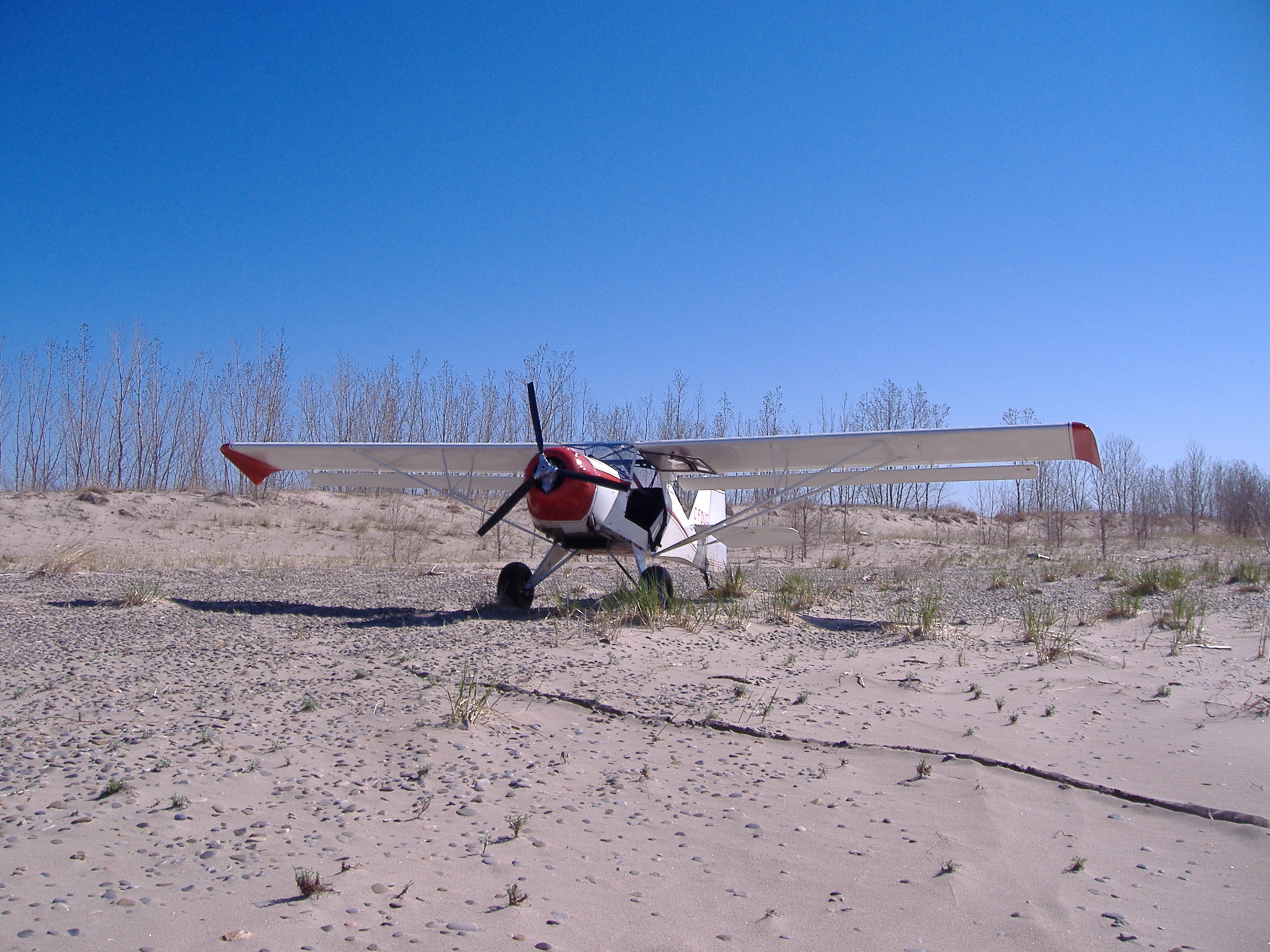

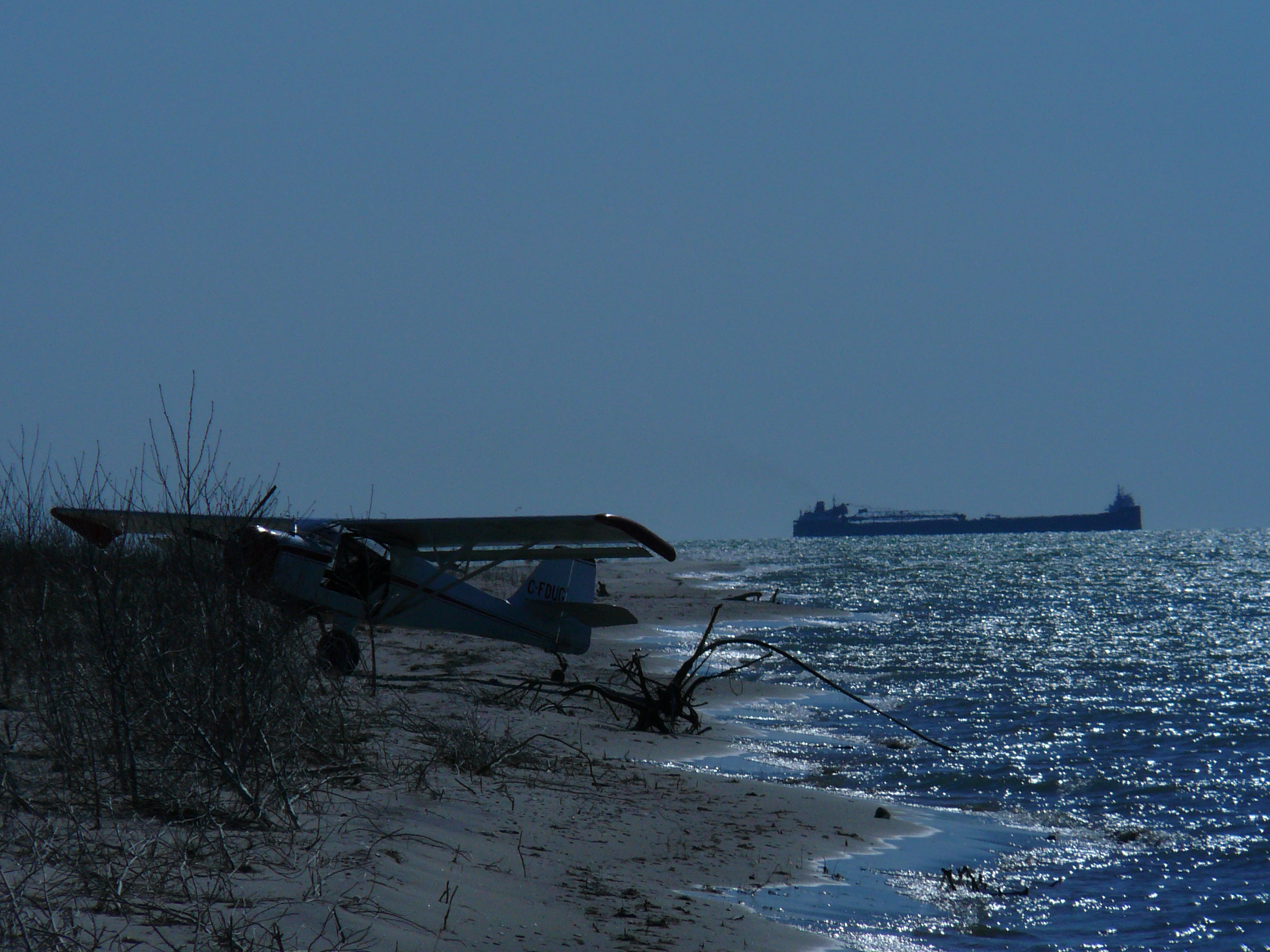

dave
Joined: 22 Sep 2006
Posts: 1382
PostPosted: Sun Mar 23, 2008 5:41 am    Post subject: Re: King Fox Tires Reply with quote
Tires leave virtually no foot print on the beach.
This pic is taken 23 miles off the mainland in Lake Erie at tip of Long Point .

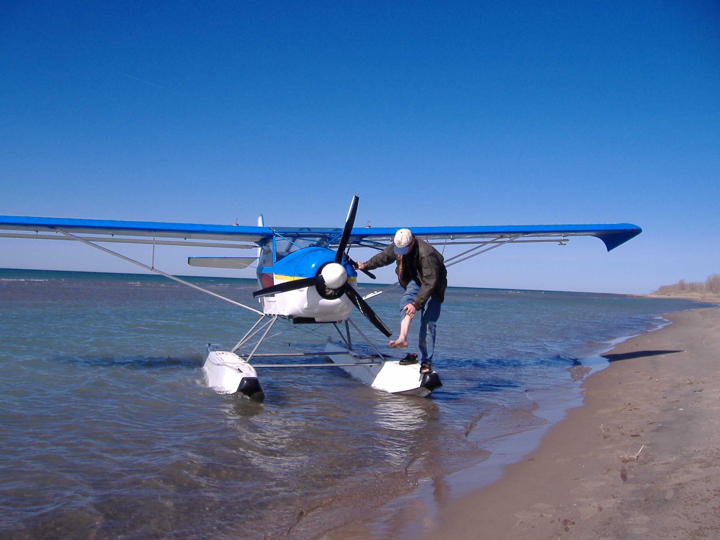

dave
Joined: 22 Sep 2006
Posts: 1382
PostPosted: Sun Mar 23, 2008 5:43 am    Post subject: Re: King Fox Tires Reply with quote
to show you how far out on Lake Erie we were look in background
<snicker>
Pics taken by Gary Walsh from his Kitfox Amphib
 Filesize:  2.23 MB
 Viewed:  1016 Time(s)

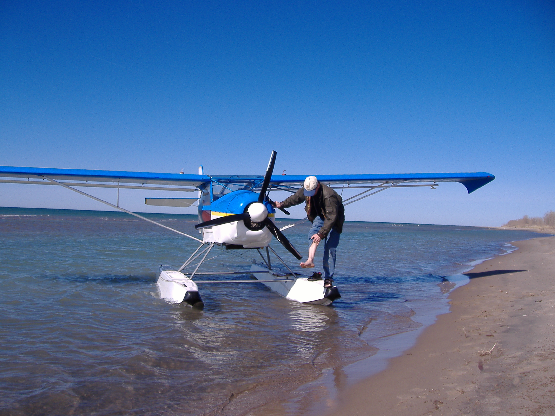

dave
Joined: 22 Sep 2006
Posts: 1382
PostPosted: Sun Mar 23, 2008 5:44 am    Post subject: Re: King Fox Tires Reply with quote
Here is Gary in the Cold water a few weeks after Ice out last year
 Filesize:  1.83 MB
 Viewed:  886 Time(s)
