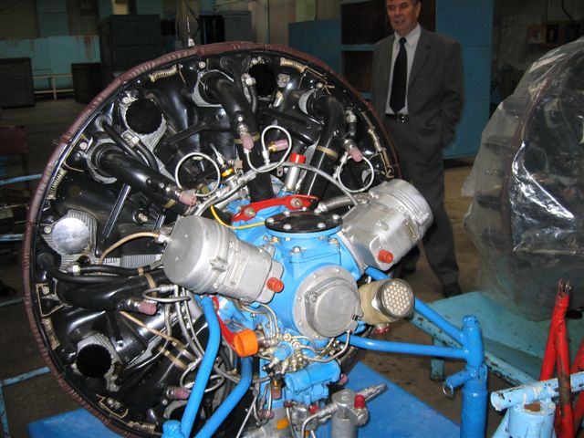

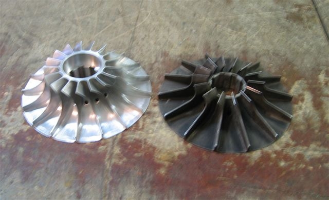

The Russians are certainly capable of teasing out more horsepower ...... check out the photos taken a few years ago in Russia............. the actual output is unspecified but with full fuel injection and no accessories coupled to the vastly improved supercharger output...... I bet it rocks ! TBO times of as little as 50 hours are the downside of heavily modified competition motors.
Incidentally the 'Rat Motor' label is only correctly used to describe the Big Block Chevy series as identified on the list by others. Also, as good as the 426 Hemi from Mopar was it was incapable of producing better than one horsepower per cubic inch in stock form...... even when blueprinted. In Hot Rod circles the big displacement Chryslers were "Elephant" motors
The references to Grumpy Jenkins is pretty accurate and I think the legendry T shirt cartoonist Ed Roth was involved with the plagiarism of his "Rat Fink" logo.
I don't claim to be a motor expert so some one please elucidate me.  Looking at the photos, I can see and understand the up grade of the super charger. However in looking at the "fuel injection" I can not see any advantage. The fuel is merely "injected" into the intake pipes up stream of the intake valve.
As I understand "fuel injection" the fuel is injected directly into the cylinder. Here I understand the advantage, and particularly with the 'gami' (sp?) injectors that horizontal opposed engines use.
Where does the extra power come from? Super charger changes in shape or rotation speed, gapless rings, domed pistons, and valve design, I can understand but I just don't see the advantage here.
Of the different "changes" which one delivers the most horsepower?  The domed piston over the supercharger or just gapless rings?
No one has ever explained to me why injecting fuel into the intake pipe produces more power and is any different than injecting it at the carb and my limited cranial volume can't seem to comprehend it.

What I was expecting was the question "Why are the exhaust ports dubbed out in the photo ?"
I don't know the answer but the ruskies airbrushed them out of the photos for a reason.

The black exhaust areas that you say are airbrushed out in the photo are actually exhaust caps that screw on the cylinder to keep fod out.
