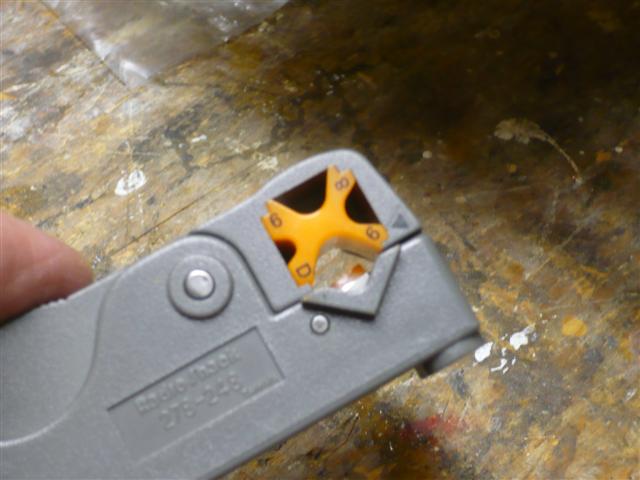

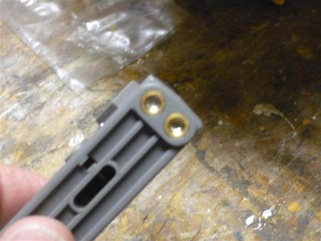

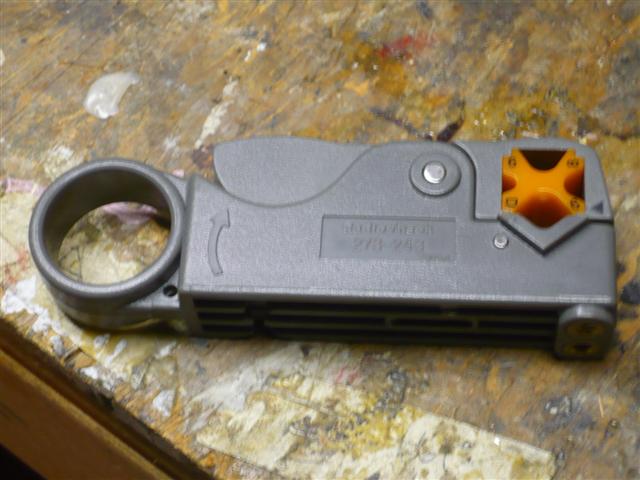

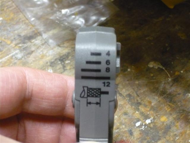

Dave,
Been thinking about the question and thought this tool from Radio Shak might do the trick. Its part number is 278-248. It is made for coax cable but is has adjustable blades and the orange thing rotates to accommodate different size cable. You could disable one of the cutters and only set the other to cut most of the way through. It won't do everything, once you get it setup you will know it won't nick the wire.
Pictures below

Dave, I've used that tool very successfully on large cables. Jay in Dallas
