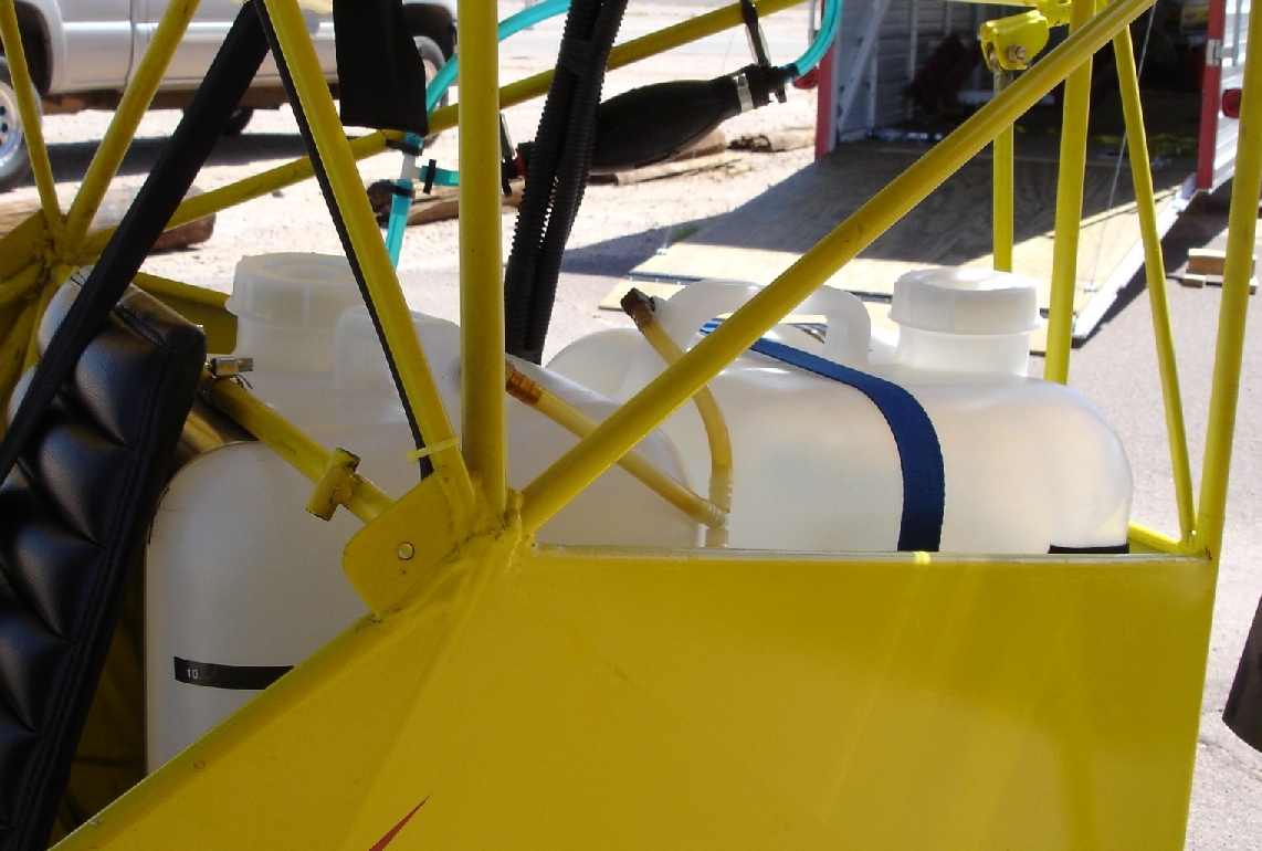

Here is the pic of 2 - 6 gallon tanks purchased from TNK in a FS II, hope it makes it. I Put mine in the same way. Credit for the pic goes to Dan G. in AZ
Jimmy Young

The 6 gal tanks fit fine if you turn the front one sideways so the handle does not interfere with the frame cross member (makes it easier to fill from the side anyway). Definitely a great deal from TNK. The other thing you can see in the photo is that the front tank sticks forward enough to interfere with the rear sling seat. This was not a problem for me because I used a rigid rear seat back.
