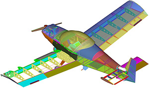

Hello Again Listers, below are some words from Chris Heintz on the last flurry of this discussion, at the bottom of this letter is the whole letter from May 10 2007.
Special note to Zodiac Pilots: The Zodiac aircraft has a large amount of elevator control. I designed this feature so that if a pilot improperly computes the C of G before flying, he/she will in most cases have enough elevator authority to safely return and land. Also, like most of my other aircraft designs, the Zodiac has excellent control authority at low speeds. It is critical that this extra controllability not be abused. Pushing the stick rapidly full forward at cruise speed - even briefly - can result in serious damage to the airframe. Caution must be exercised to not inadvertently push the stick rapidly to its limits ( i.e. while stretching, reaching into the rear baggage compartment, etc.). Remember also that, without a doubt, you will always have a more enjoyable flight if the weather is "severe clear".
Owners should take note that the CH601XL has relatively light pitch control forces and that it is possible to exceed the positive (+6) and the negative (-3) ultimate load factors if forcing the controls in a very rough or sudden manner. Please be reasonable: the fact that the CH601XL can perform aerobatic maneuvers very well does not make it an aerobatic design."
So this latest spawn of doubt sprang from someone stating that the Aussie accident had a wing failure, then the band wagon was lead by the loudest voice. I have no problem with a common sense discussion of the 601’s design. Hell that is what this list is for, in Chris’s own words the control of the elevator can move the plane into stresses that can exceed it’s design. I am concerned about the mentality that wishes to believe a problem exists without proof and runs with heresay.
So lets get back to the latest one in Australia, I have just gotten off the phone from the Dealer there and had a discussion with them and the divers who found the wreckage. I cannot tell you what happened, nor am I going to guess. I will not judge accomplished pilots and builders of the plane. I have not talked to Zenith about this so the information I have is from non official sources. However, I will lay out the facts here as I know them to be from people who are there and seen the wreckage.
<![if !supportLists]>1. <![endif]>Parts of the Canopy have been found 2 kms from the resting location of the plane. Some have been found on top of buildings.
<![if !supportLists]>2. <![endif]>Pictures taken with camera’s were deceiving at first by hiding one side of the fuselage on decent, but some frames have shown the plane just before impact with the water and both wings are in place, as well as the tail. The divers that found the wreakage have stated that all flying surfaces are attached to the plane, though the canopy is missing.
<![if !supportLists]>3. <![endif]>The shape of the pilots looks to be a quick and merciful by the report of one diver.
<![if !supportLists]>4. <![endif]>There is a report of pelicans that fly in that area, that is a large bird.
Accidents unfortunately can happen, we have weather, objects, mechanical failures, pilot issues, running out of gas and stresses placed on the planes beyond design loads. As improperly executed Aerobatics can do or sudden full stop inputs on the controls.
I am not saying to stop what your doing, it is your choice, discuss your options. But be realistic, consider your opinion before placing it on this list for the Archives to capture. This accident is unfortunate but in no way is there any evidence of a structural issue, just the opposite, the plane may have flown 2 kms with no one at the controls. I do not know but the broken canopy may indicate such.

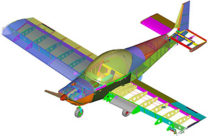

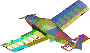

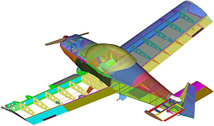

May 10, 2007:
As the designer of the Zodiac CH 601 series of aircraft, I take it very personally when I hear of a fatal accident involving one of these aircraft, especially when it involves elements of an in-flight break up.
With the introduction of the Light Sport Aircraft rule, I personally re-calculated the entire Zodiac CH 601 XL design to confirm that it exceeded all minimum LSA design requirements. The structure of the design is comparable to the Alarus CH2000 FAR 23 certified aircraft (now certified in more than 20 countries). The present Zodiac XL S-LSA model is stressed to an ultimate +6/-3 g at 1,320 lbs.
Still, we have seen a disturbing number of accidents over the last year, including the most recent one on May 2, 2007 (NTSB Identification: DFW07LA102). Having evaluated the wreckage photos of a Zodiac crash in 2006, I am in the process of starting yet another complete set of structural load tests on a production airframe. This will be done at the Zenair Ltd factory in Canada. In order to make absolutely certain nothing is missed, an independent structural engineer will confirm the findings of these rigorous tests.
\n\u003cp style\u003d\"color:rgb(51,51,255)\"\>\u003cfont color\u003d\"#009900\"\>While I am confident that the Zodiac XL design will again be found to be sound in every respect, it is important for builders and pilots of this very nice airplane to have full confidence in the integrity of the aircraft. Findings of the tests will be communicated through the Zenair Newsletter and through the Zenith Aircraft website.\n\u003c/font\>\u003c/p\>\u003c/span\>",1] ); //--> While I remain fully confident that my Zodiac XL design will again be found to be sound in every respect, it is important for builders and pilots of this popular airplane to have full confidence in the integrity of the aircraft. Findings of the tests will be communicated through this website.
\u003cfont color\u003d\"#009900\"\>\u003cspan style\u003d\"text-decoration:underline\"\>Special note to Zodiac Pilots\u003c/span\>: The Zodiac aircraft has a tremendous amount of elevator control. I designed this feature so that if a pilot improperly computes the C of G before flying, he/she will in most cases have enough elevator authority to safely return and land. Also, like?most?of my other aircraft designs, the Zodiac has excellent control authority?at low speeds. It is critical that this extra controllability not be abused. Pushing the stick rapidly full forward at cruise speed - even for a second - can result in serious damage to the airframe and pilot(s). Caution must be exercised to not inadvertently push the stick to its limits (\ni.e. while stretching or reaching into the rear baggage compartment); Also, slow down if flying in turbulent weather where bumps could cause your control arm to move, thereby moving the stick in an unwanted way? ?\u003c/font\>\u003c/p\>\n\n\u003cp style\u003d\"color:rgb(51,51,255)\"\>\u003cfont color\u003d\"#009900\"\>Please continue to be safety-conscious whenever you fly\u003c/font\>\u003cfont color\u003d\"#009900\"\>. Always stay within the design limits of your aircraft and well within your own abilities as a pilot. \n\u003c/font\>\u003cspan style\u003d\"color:rgb(51,51,255)\"\>\u003cfont color\u003d\"#009900\"\>CH\u003c/font\>\u003c/span\>\u003c/p\>\n\u003cp\>\u003cspan style\u003d\"color:rgb(51,51,255)\"\>\u003cfont color\u003d\"#009900\"\>\u003cu\>A \u003c/u\>\u003cu\>Note from Zenith Aircraft Co.:\u003c/u\> We are happy to report that our red and white factory demo Zodiac XL (N-601XK) is now six?years old! This Jabiru-powered aircraft?has logged over 1,100 hours (as of?April 2007) and has crisscrossed the USA dozens of times in all kinds of conditions. We estimate that we fly over 300 demo flights per year in this aircraft; that's over 1,800 passengers over the last 6 years. Additionally, over 15,000 people have taken a seat in this aircraft over the years at different shows and fly-ins, as well as at the factory. The plane flies as well today as it did when it was new; we feel very fortunate being the kit manufacturer for such a fine aircraft.?The fact that?our demo?plane still looks and performs as well as it does is a testament to the design's integrity?and robustness. If you have not done so already, call us today to schedule your own demo flight in 601XK!?ZAC\n",1] ); //--> Special note to Zodiac Pilots: The Zodiac aircraft has a large amount of elevator control. I designed this feature so that if a pilot improperly computes the C of G before flying, he/she will in most cases have enough elevator authority to safely return and land. Also, like most of my other aircraft designs, the Zodiac has excellent control authority at low speeds. It is critical that this extra controllability not be abused. Pushing the stick rapidly full forward at cruise speed - even briefly - can result in serious damage to the airframe. Caution must be exercised to not inadvertently push the stick rapidly to its limits ( i.e. while stretching, reaching into the rear baggage compartment, etc.). Remember also that, without a doubt, you will always have a more enjoyable flight if the weather is "severe clear".
Please continue to be safety-conscious whenever you fly. Always stay within the design limits of your aircraft and well within your own abilities as the pilot in command.
Chris Heintz.
Update from Chris (July 2007):
"To 'certify' the CH601XL in the LSA category, a complete stress analysis was performed and confirmed for the positive loads be static tests. No permanent deformations were found at limit loads (i.e. +4 'g') and no failures at ultimate loads (i.e. +6 'g'). The bending deformations were in accordance with the analysis and the torsional deformations were barely measurable, removing the possibility wing or tail flutter.

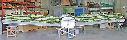

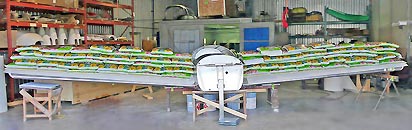

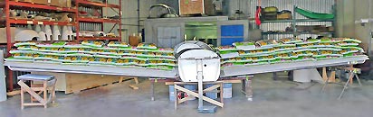

Load testing the Zodiac XL by Zenair Ltd. (June 16, 2007)
"Recently, Zenair Ltd. also performed static tests of the negative loads on the wing, fuselage and horizontal tail (see photos) and the results were similar to the positive load tests: No permanent deformation at limit loads and no failure at ultimate 'g' loading. The bending and torsional deformations were very small (the torsional twist was practically zero!).
"I want to remind and reassure every owner, builder that not\n only is the\u003cspan style\u003d\"color:rgb(51, 0, 51)\"\> \u003cspan style\u003d\"background-color:rgb(102, 255, 153)\"\>main \u003c/span\>\u003c/span\>structure \u003cspan style\u003d\"background-color:rgb(102, 255, 153)\"\>well in compliance \u003c/span\>\n\u003cspan style\u003d\"background-color:rgb(255, 102, 0)\"\>substantiated\u003c/span\> with the ASTM standards,\n but also\u003cspan style\u003d\"background-color:rgb(102, 255, 153)\"\>, \u003c/span\>\u003cspan style\u003d\"background-color:rgb(255, 102, 0)\"\>the \u003c/span\>'accessories' such as the seat\u003cspan style\u003d\"background-color:rgb(102, 255, 153)\"\>\n-\u003c/span\>belt attachments,\n battery installation, etc... were all static tested with\n \u003cspan style\u003d\"background-color:rgb(102, 255, 153)\"\>very \u003c/span\>satisfactory results. \u003cbr\>\u003c/font\>\u003c/p\>\u003cp align\u003d\"left\"\>\u003cfont face\u003d\"Arial\"\> Owners should take note that the\n CH601XL has relatively light pitch control forces and \u003cspan style\u003d\"background-color:rgb(102, 255, 153)\"\>that \u003c/span\>it is\n possible to exceed the positive (+6) and the negative (-3)\n ultimate load factors if forcing the controls in a very rough\n or sudden manner.? Please be reasonable: \u003cspan style\u003d\"background-color:rgb(255, 102, 0)\"\>in spite of\u003c/span\> the\n fact that the CH601XL can perform aerobatic maneuvers very\n well does \u003cu\>not\u003c/u\> make it an aerobatic design."\u003c/font\>\u003c/p\>\n \u003c/blockquote\>\u003cbr\>\u003cbr\>\u003cbr\>\u003cbr\>\u003cdiv\>",1] ); //--> and pilot that not only is the main structure well in compliance with the ASTM standards, but also, 'accessories' such as the seat -belt attachments, battery installation, etc... were all static tested with very satisfactory results.
A Brief Note from Zenith Aircraft Company:
We are pleased to report that our red and white factory demonstrator Zodiac XL (N9601Z) is now six years old and has logged over 1,000 hours. The aircraft has crisscrossed the United States dozens of times through all kinds of conditions. We fly well over 300 demo flights per year in this aircraft; that's over 1,800 passengers over the last 6 years. Additionally, over 15,000 people have taken a seat in this aircraft over the years at different shows and fly-ins, as well as at the factory. The plane flies as well today as it did when it was new; we feel very fortunate being the kit manufacturer for such a fine aircraft. The fact that our demo plane still looks and performs as well as it does is a testament to the design's integrity and robustness.
