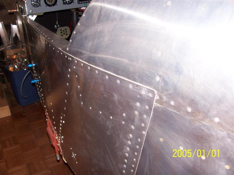

PostPosted: Tue Mar 11, 2008 4:00 pm    Post subject: Re: Skins Reply with quote
The top overlaps the side skins, but tucks under the cabin side skins. Leave a large area of the cabin side skins clecoed until you are ready to tuck the top skin under.
I'm pretty sure I've got this correct according to the plans (at least the version I purchased).
Dan
[quote="rmacpunk(at)netzero.net"]Do the rear and middle top skins overlap or go inside the side skins?
close up of overlap
 Filesize:  57.53 KB
 Viewed:  523 Time(s)
leinad
Joined: 19 Sep 2006
Posts: 283
Location: Central Virginia
PostPosted: Tue Mar 11, 2008 4:03 pm    Post subject: Re: Skins Reply with quote
By the way ignore the date on the photo. I took it a week ago. The battery on my camera died and reset the date.
