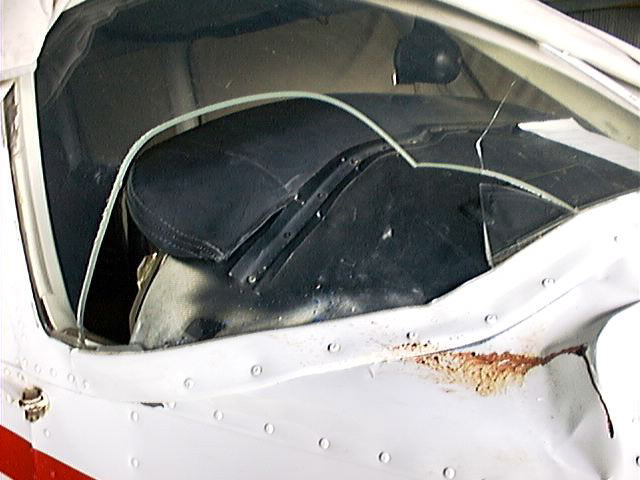

Regarding the article that Joe shared with us about the Australian crash, a bird strike was the first thought that came to my mind when I heard of pieces of the canopy ending up on shore, far from where the plane went in. At the altitude the plane was at if the pilot took a bird in the face he might not have had much time to react and could easily have lost control.
We had an incident at our local airport where a Beech Sundowner being flown by a student with his instructor hit a bird (maybe Canada Goose) on final approach at night. He was going about 80 mph when he experienced an impact that slewed the plane around. He later said he thought he'd hit a skydiver. Upon landing a hole was found in wing skin just outboard of the fuel tank from the leading edge to the spar and beyond. It was big enough to stuff a frozen turkey into. The way the skin was peeled you would have thought he'd taken an artillery round. The insurance company decided to replace rather than repair the wing.
A bird strike may not be responsible for the tragedy in Australia but it points out that we all need to be especially vigilant when flying in areas frequented by large fowl. I don't have a picture of the damaged wing but here is a shot of what a bird did to a Cherokee windshield.
Tim (who lives near a major migratory bird route)

There are two photos in that attachment. This first one is not a 601xl, the
airfoil is much thinner than an XL.
Randy
bill_dom(at)yahoo.com

It looks like the plane is resting on the left side of the fuselage with both wings folded up in relation to the plane. The leading edge skin seem to be missing from the most part exposing the main spar. Strangely enough, the stabilizer an elevator can be seen intact in a vertical position in the background. The front wheel is pointing to the left side.
Something to keep in mind about this accident is that some of the news that cover it didn't mention a wing failure but an engine failure as the cause.

Darrell Haas <darrellhaas(at)gmail.com> wrote:[quote] --> Zenith-List message posted by: "Darrell Haas"
It looked like that to me also. And the trim for the canopy was up.
Darrell
do not [quote][b]
