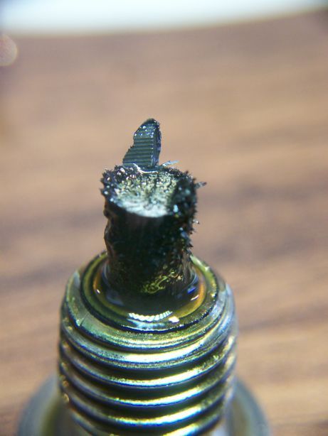

PostPosted: Thu Mar 06, 2008 9:44 pm    Post subject: Re: Gearbox recall Reply with quote
Don't beat your gearbox up.
Gearbox magnetic plug when things go wrong.
 Filesize:  39.72 KB
 Viewed:  601 Time(s)
