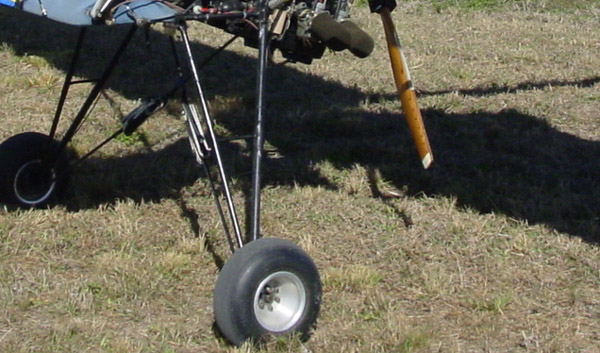

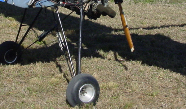

UltraStars don't have bungees, just a rigid gear, not even the spring steel
gear of the later Kolbs...
<<<<SNIP>>>>
-Dana

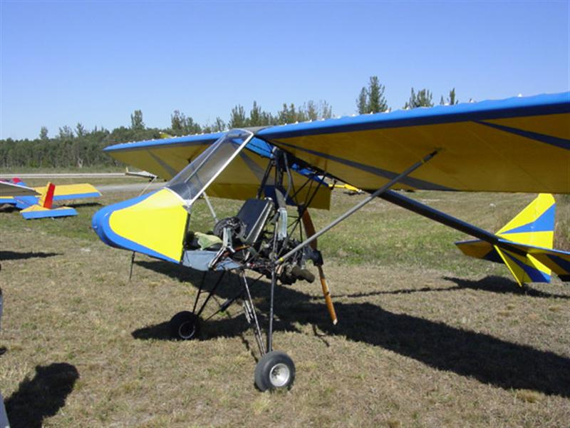

While not stock set-ups, I personally know of 3 different Ultrastars that had bungee suspension systems on their mains.
The attached images are of a very highly modified one (used to belong to Richard Swiderski of this group) with a bungee system.
Sorry I don't have images of the other two.
Ah yes, the "stork" UltraStar. I've heard of US's being modified with
FireStar gear, too. The problem is, you have to add the height to insure
adequate prop clearance when the gear compresses. The previous owner of my
plane just installed much larger, soft tires... but then it wouldn't fit in
the trailer so I had to go smaller again... and land carefully.
-Dana
