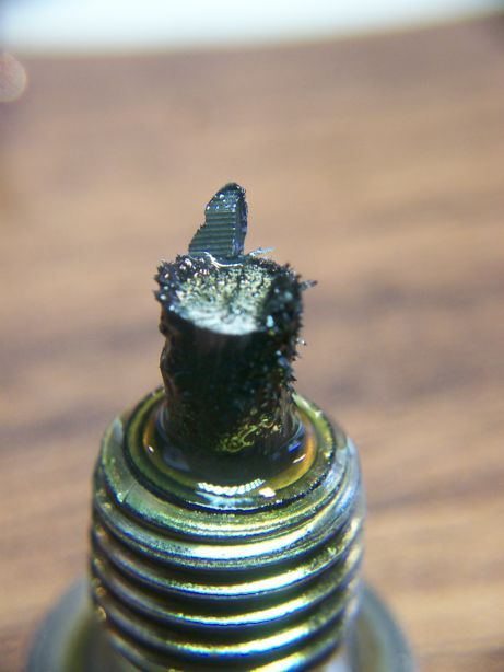

Roger Lee
Joined: 10 Jan 2006 Posts: 1464 Location: Tucson, Az.
Posted: Fri Mar 07, 2008 1:53 pm Post subject: Re: 912 with low RPM |
Be kind to your engine or else.
| - The Matronics RotaxEngines-List Email Forum - | | Use the List Feature Navigator to browse the many List utilities available such as the Email Subscriptions page, Archive Search & Download, 7-Day Browse, Chat, FAQ, Photoshare, and much more:
http://www.matronics.com/Navigator?RotaxEngines-List |
Description: |
Magnetic oil plug from a 912ULS. |
