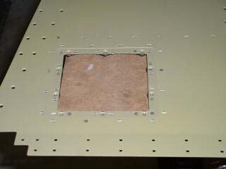

PostPosted: Mon Mar 03, 2008 2:43 pm    Post subject: baggage floor access plate for step Reply with quote

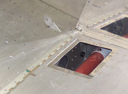

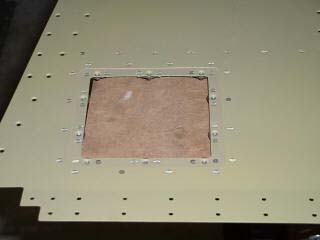

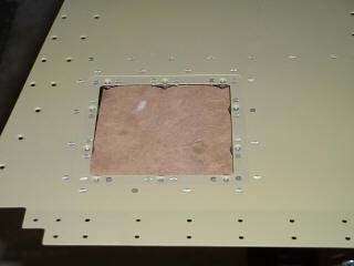

I used the parts for the stall warning horn access panel. I had to
drill the bolt hole in the steps from the side, however, to be able to
get the bolt in because of how I oriented the access panel. If you
rotate it to the right about 30 degrees or so, I believe you can still
put the bolt in per the plans.
PJ Seipel
RV-10 #40032

seipel(at)seznam.cz
PostPosted: Mon Mar 03, 2008 2:46 pm    Post subject: baggage floor access plate for step Reply with quote
Sorry, forgot the picture.
PJ Seipel

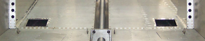

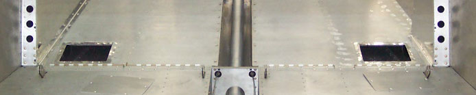

robin1(at)mrmoisture.com
PostPosted: Mon Mar 03, 2008 4:30 pm    Post subject: baggage floor access plate for step Reply with quote
Ben,
  I think it’s an excellent idea especially when working around the plane during construction. Think of it as Shin Insurance because you will whack yourself and it can hurt. Then you will hit your already tender shin in the exact same place and it will hurt even more. We powder coated our steps a smoke chrome and I wanted it to be removable in case the PC didn’t hold up. Additionally mine are removal for the Reno Air Races. Watch out Bearcat!
Robin
Photos Attached
 Filesize:  45.98 KB
 Viewed:  695 Time(s)
 Filesize:  36.25 KB
 Viewed:  638 Time(s)
rv10(at)sinkrate.com
PostPosted: Mon Mar 03, 2008 5:31 pm    Post subject: baggage floor access plate for step Reply with quote
That looks pretty good but how are you going to get the bolt out? Is there room if you move the access panel all the way next to the wall panel to lift the bolt up?
-Ben

jesse(at)saintaviation.co
PostPosted: Mon Mar 03, 2008 6:53 pm    Post subject: baggage floor access plate for step Reply with quote
You either have to have a big enough hole for the head of the bolt in the bottom skin and put the bolt in from underneath or you have to have the hole in the baggage floor to get it out from there. I don't think you can get the access panel close enough to actually pull the bolt out through it.
Jesse Saint

PostPosted: Mon Mar 03, 2008 7:54 pm    Post subject: baggage floor access plate for step Reply with quote
Just a thought but Cessna on occasion drilled a bolt insertion hole directly over the bolt and had an circular access panel below or adjacent to the bolt for hand access to tighten or loosen the bolt. the bolt insertion hole was covered with a chrome cap.

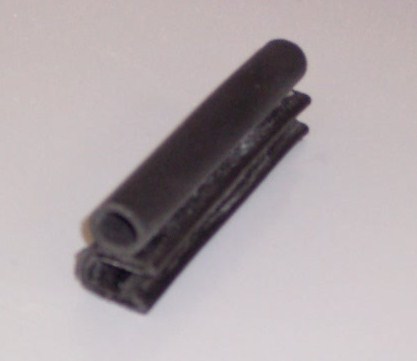

PostPosted: Mon Mar 03, 2008 11:46 pm    Post subject: baggage floor access plate for step Reply with quote
Bingo! Ben.
Lew, sorry I am on the road and have too many moving parts these days to reply quickly.
There is a ½” hole drilled directly above the bolt (no pictured). That hole is normally plugged with a plastic panel plug and then the entire area covered with carpet.
Regarding the door seal we used a seal sold by McMaster Carr not the vans seal. Sorry I don’t have the style number.
(Photo attached)
Regarding the nut installation for the door, it’s not that difficult to remove and I hope the doors will not have to be taken off many more times. At least not till the first flight J
We cleaned up under the hinge a bit but ours do sit pretty flush. The metal is bent a bit down into the recess we made for the cover. There are a number of different ways to do this including living with a small bump at each hinge point.

PostPosted: Tue Mar 04, 2008 2:09 am    Post subject: baggage floor access plate for step Reply with quote
Or drill the hole in the step horizontally. Then you can get the bolt
in and out no problem.
PJ Seipel

I purchased 2 extra of the stall warning access panels rom Vans. I installed these in the floor inboard of the step bolts for hand access. I drilled a hole in the lower skin large enough to just clear the bolt head and stuck in a hole plug.
It works great, but I like the idea of redrilling the hole horizontal and not having the hole in the bottom skin...
-Mike Kraus
