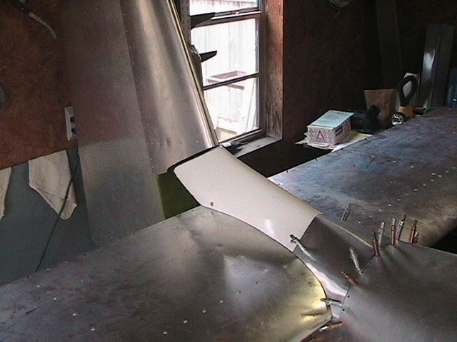

PostPosted: Sat Feb 23, 2008 2:15 pm    Post subject: Saddle Reply with quote
Definitely Bill. Wait until you hav ethe rear top skin at least clecoed in place so you can work out how the saddle sits on the H-stab and how the saddle's forward edge mates up with the aft edge of the rear top skin. I jumped in a separate piece of .016 to allow me to cut the aft edge of the rear top skin far enough forward so that the H-stab can be placed and removed in a vertical path compatible with the brackets.

PostPosted: Sat Feb 23, 2008 2:26 pm    Post subject: Saddle Reply with quote
Chris,
Don't get side-tracked on stab position and stick with the drawing. Fly
it with the saddle in place and
let it go at that. Few people find the 601s stab a problem after the
build. More likely you'll find a CG problem
that needs to be taken care of before testing. Make sure you get that
right.

PostPosted: Sat Feb 23, 2008 7:11 pm    Post subject: Saddle Reply with quote
I adjusted the rear hor. stab. mounts. No need to do anything to the
saddle.

PostPosted: Sat Feb 23, 2008 9:11 pm    Post subject: Saddle Reply with quote
I installed my saddle yesterday and here's what I did.
From the plans, I plotted and drew out the top half
of the HT rib on a piece of cardboard. I cut that out
and used it to transfer the curve to the bottom of the
saddle with a sharpie. Sanded to the line and had a
nearly perfect fit. A little fine tuning and it was
ready to drill and cleco.

naumuk(at)alltel.net
PostPosted: Sat Feb 23, 2008 9:46 pm    Post subject: Saddle Reply with quote
Rich-
Hmm. More than one way to skin a cat. I was going to level the saddle
and duct tape it directly on the stab. Then run a Sharpie line using a
spacer to get an acceptable height.

PostPosted: Sun Feb 24, 2008 8:40 pm    Post subject: Saddle Reply with quote
I didn't have to make any changes to the saddle after re-pitching my
stabilizer. I did have to do some trimming to the rear end of the rear
top skin.
