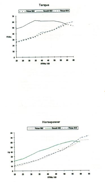

I can't verify as to the accuracy but this is the chart that has been
used for comparison
between the 582 and the G10 Suzuki.
I think Richard Swiderski has this on his web site too.
(Has anyone heard from him lately?)
scroll down for the HP chart.
