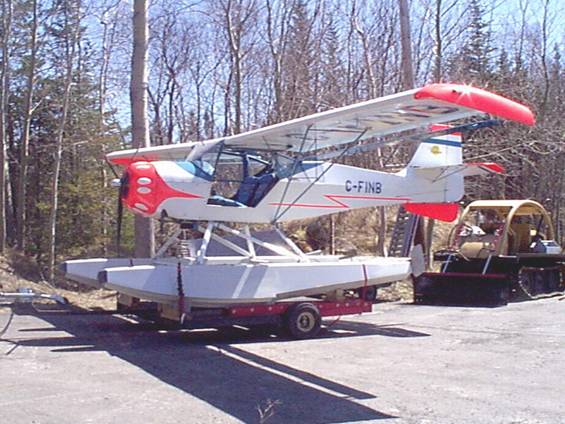

PostPosted: Fri Feb 22, 2008 3:48 pm    Post subject: Weight Affected by Color of Plane Reply with quote
I guess that it is only reasonable to assume that different pigments made from different compounds would have different weights. For example I think the white pigment is usually lead, zinc or titanium compounds.... all pretty heavy. Iron oxides are the basis for some red paints and are a little lighter. Black paint which it is only reasonable to assume would be the heaviest... heavy colour and all that is actually quite light because most of it is soot, or more correctly carbon.
Just for fun try http://en.wikipedia.org/wiki/Pigment different colours are hyperlinks to additional pages...
Now for a question for Lynn... You have been in the photographic industry long enough to know this... when colour photos fade what colour do they fade to? Smile
Another question... if it is true that red fades faster why do farmers ever paint their barns a colour that would require more work?? After you think of an idea or two look at http://people.howstuffworks.com/question635.htm
FWIW my plane isn’t white and red, but white with Day-Glo orange with navy blue trim. I haven’t found where the builder got the day glo.
