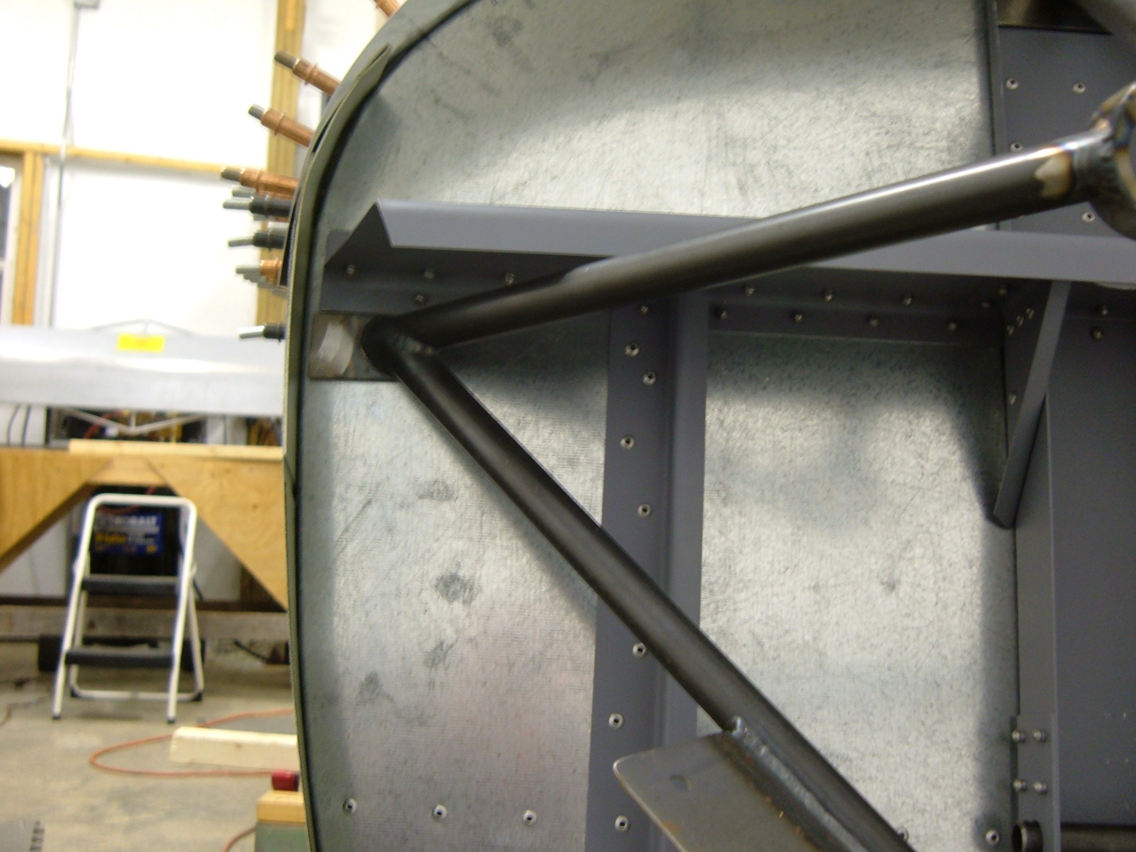

I've attached a picture of the left side of my 912 ring mount. You can see the tab sticking out to the left where it will be bolted to the firewall. The bolt goes through the firewall and through a bent steel plate in back which also bolts into the flange of the firewall. Presumably whatever mount you're building could be attached the same way.
Incidentally, the previous 912 bed-mount mounts a little differently right here. The mount tab sticks up rather than to the left, so it overlaps on top of 7F7-1SP. That way the bolt goes through 7F7-1SP as well, which seems a little more durable to me.
Hope that helps. Drop me an email offline if not, or give Zenith a call.

John, thanks. That helps a lot. I notice that you have installed
7F7-5 firewall stiffeners at an angle instead of vertical. Does that
have to do with the Rotax installation? One last question, what is
the capacity of the Rotax oil tank? Thanks again, Jerry
