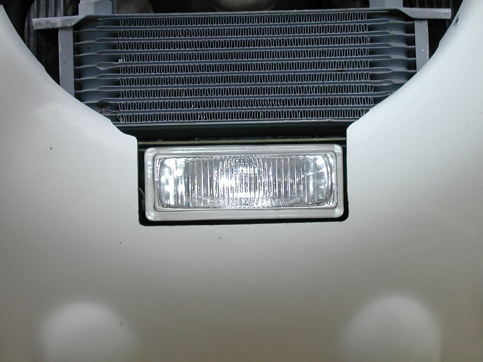

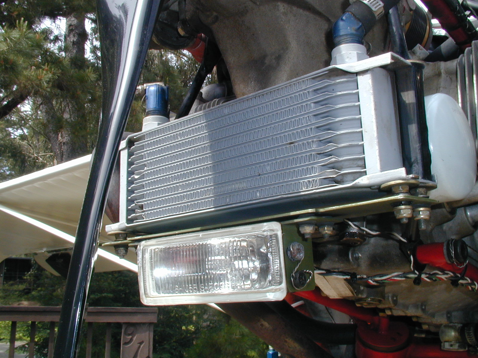

PostPosted: Wed Feb 13, 2008 8:13 am    Post subject: Landing Light Reply with quote
I installed a small driving light in front of my Kitfox. Worked for years, mounted on bottom of oil cooler. Hope pictures take.

PostPosted: Wed Feb 13, 2008 10:27 am    Post subject: Landing Light Reply with quote
Clint
The pictures were quite small, but it looks as though you cut into the round cowl to install?

PostPosted: Wed Feb 13, 2008 11:17 am    Post subject: Landing Light Reply with quote
Here are a couple of pix a little bit bigger. Didn't know they would be so small.
Clint

PostPosted: Wed Feb 13, 2008 1:36 pm    Post subject: Landing Light Reply with quote
Thanks for the photos Clint. They came through just great. Question: With the vibration from the engine, do you go through many light bulbs?

PostPosted: Wed Feb 13, 2008 5:40 pm    Post subject: Landing Light Reply with quote
Have severl hundreds of hours and haven't changed bulbs yet. Use it in flashing mode when airport is busy.
It is double shock mounted.
