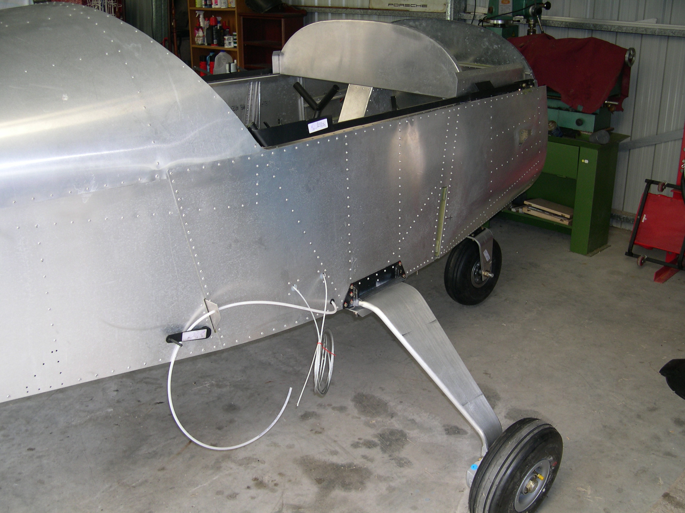

geather
Joined: 06 Feb 2008
Posts: 23
Location: Mt Hutton Australia
PostPosted: Wed Feb 06, 2008 2:29 am    Post subject: Re: XL Aileron balance cable instalation Reply with quote
Chris
This is how its done on the Quick Build Kit
Geoff Eather (Mt Hutton)
 Filesize:  771.57 KB
 Viewed:  602 Time(s)
ge

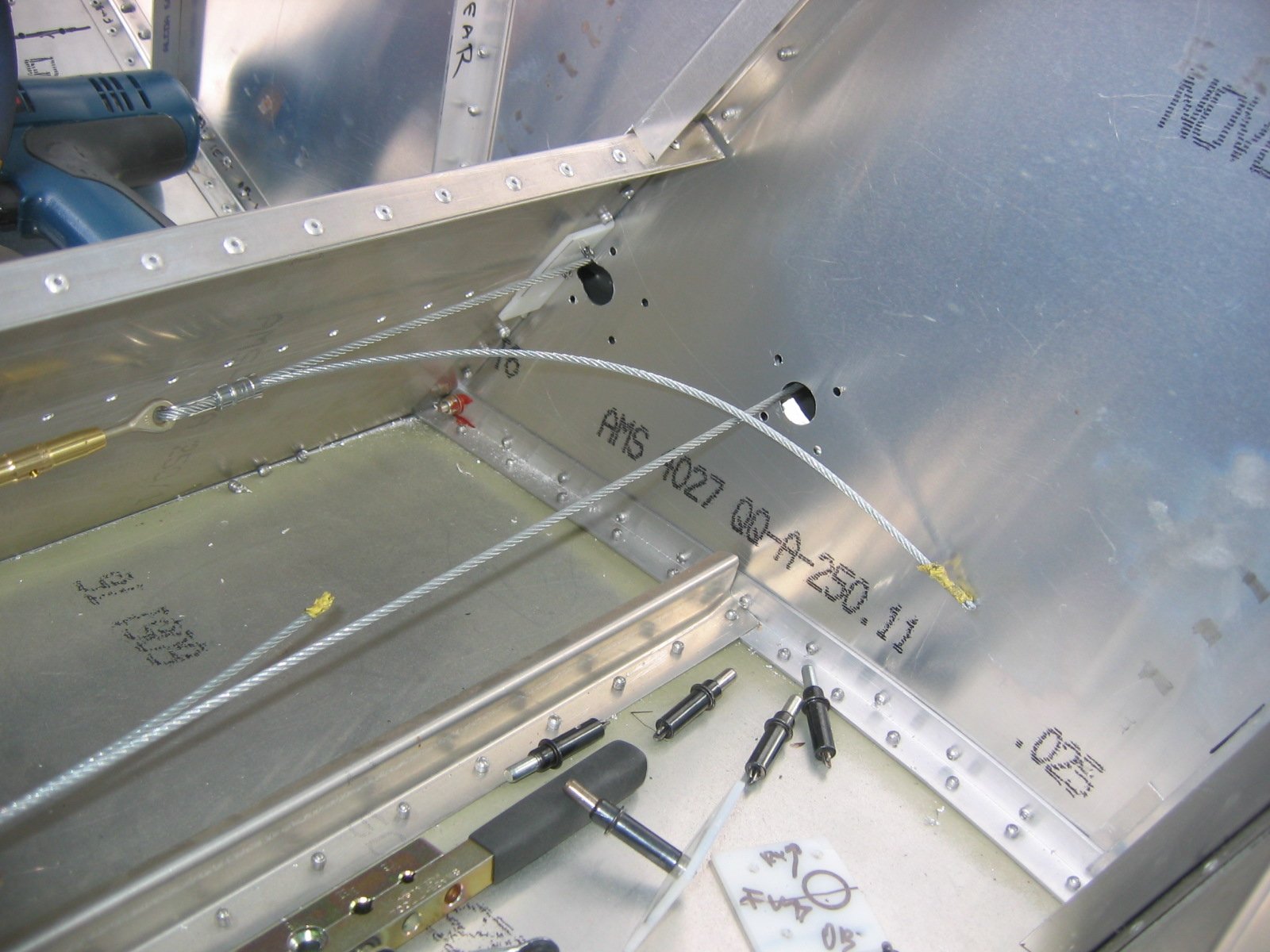

Joined: 27 Oct 2006
Posts: 351
Location: Cincinnati, Oh
PostPosted: Wed Feb 06, 2008 10:01 am    Post subject: Re: XL Aileron balance cable instalation Reply with quote
Chris,
I am not flying yet either, but I have had the wings on and all control cables attached. I drilled my aileron fairlead holes per the drawing 6-B-22 dated 02/05. The balance cable hole ended up not being as close to 6-B-5 as shown on the drawing so I did elongate my hole a bit to move the cable further forward. I probably could have left it as originally cut. Here is a picture of the right side without the side skin fairleads in place.
Good luck,
 Filesize:  244.81 KB
 Viewed:  603 Time(s)
David Gallagher
Cincinnati, OH area
