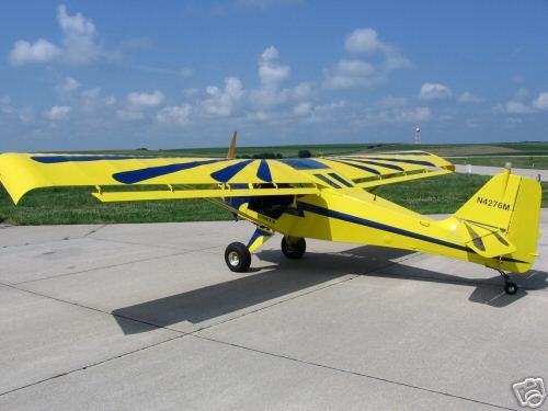

Posted: Fri Feb 01, 2008 2:28 pm Post subject: Re: Turn Down Tips? |
Here are some photos of what I am looking for does anyone have any used ones before I look for new tips. It almost looks like there is more than one type of tip in some other Photos I did not attach because they were not "N" numbered and I figured it would cost to much to have them shipped over seas.

Posted: Fri Feb 01, 2008 4:14 pm Post subject: Re: Turn Down Tips? |
Yes the are the stock droop tips on the KF models I - II - III, if you don't have them count your blessing. I would gladly trade you the droop tips on my plane for your horner type tips in a minute, but alas they won't interchange
