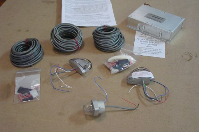

PostPosted: Wed Jan 30, 2008 7:17 pm    Post subject: Re: LED lights Reply with quote
[quote="av8or(at)cox.net"]Is the taillight/strobe the same sized/configuration as the A500?
John
#40262

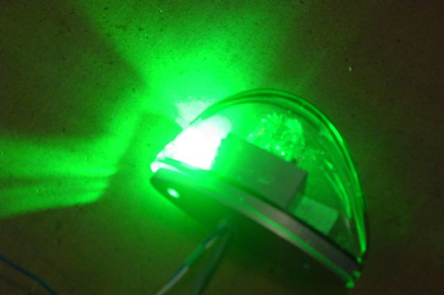

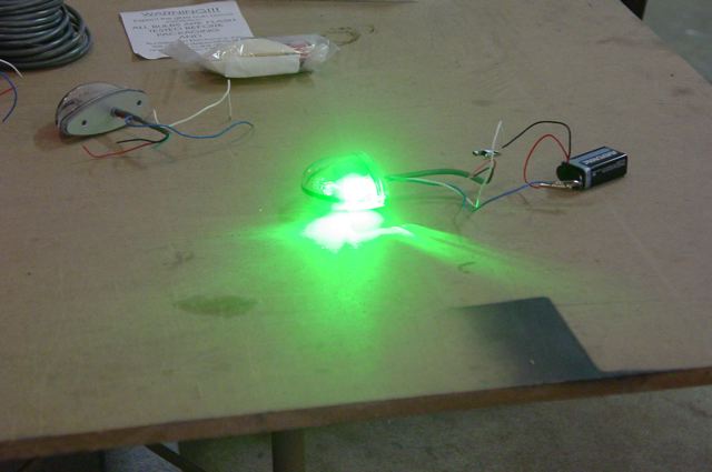

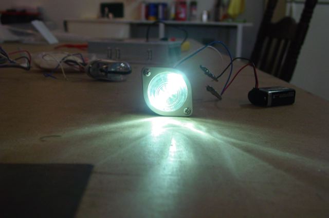

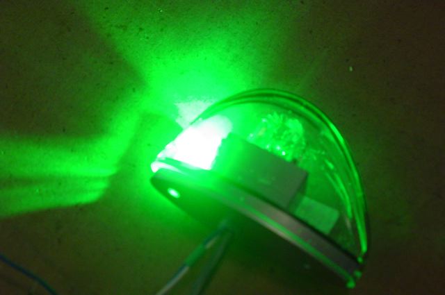

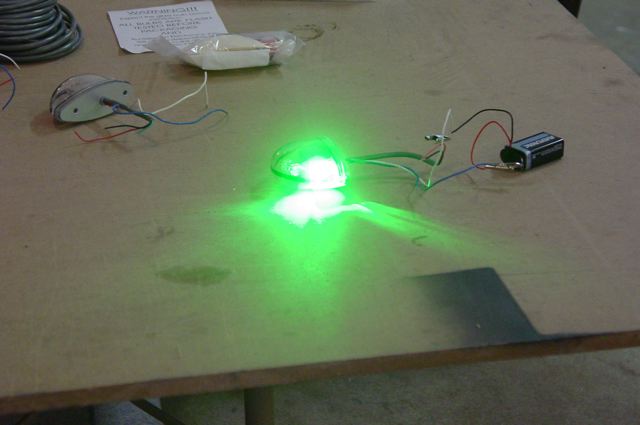

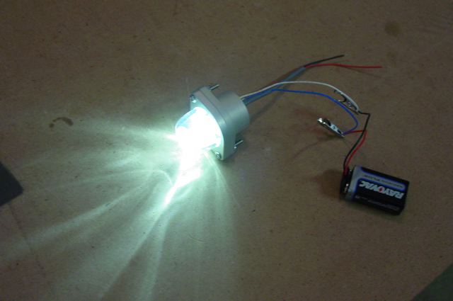

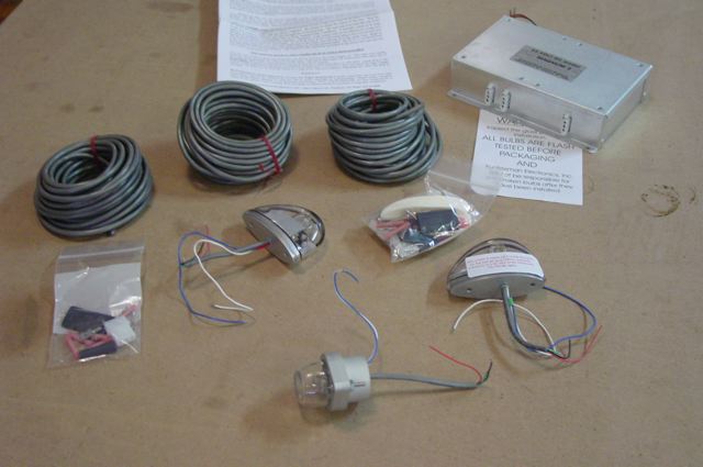

I don't have an A500 to compare but the tail light appears to have a 1&5/16" insert 3/4" deep. 5 wires - blue & white together, then black, red, aquamarine out of a grey sleeve. The exposed part is a pair of flanges and a glass dome extending out 1&5/16". The flange is about 1&11/16" narrow and 2&5/8" wide overall. Two screws on the wide part of the flange at approx. 2". It will require a little flox buildup to streamline it to the RV-10 tail light position but it will be easy. Inside the glass dome is a strobe and two large LEDs. Wing lights are similar in size and makeup - very clean looking with only two LEDs each. All wiring included.
We will see....
John
johngoodman
Joined: 18 Sep 2006
Posts: 530
Location: GA

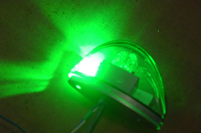

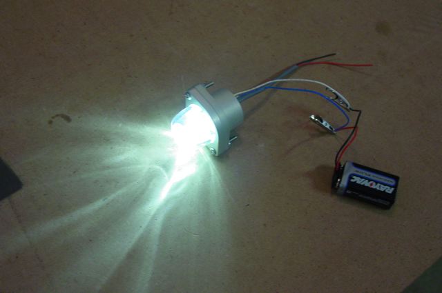

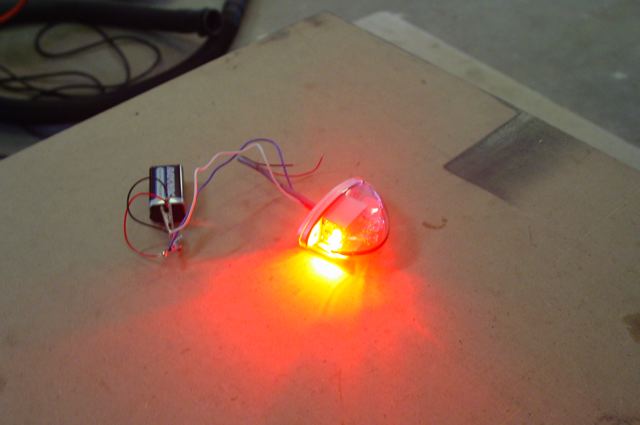

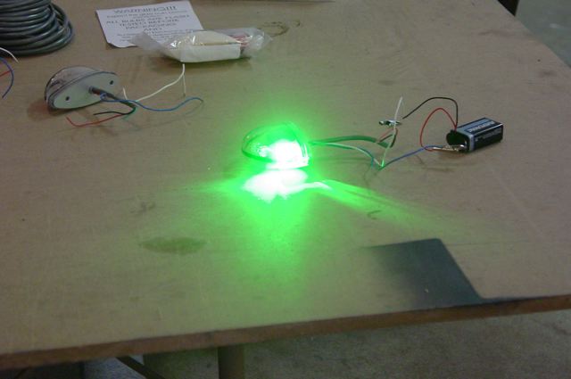

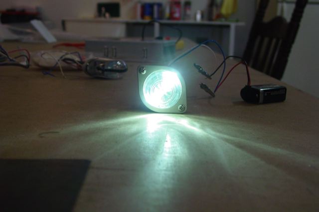

PostPosted: Thu Jan 31, 2008 9:18 am    Post subject: Re: LED lights Reply with quote
OK, I'll try to attach some photos. As far as I'm concerned this lights are perfect for me. $620 plus $9 shipping. Everything in package including wiring connections, etc. The power supply is called the Driver and it fits on the Van's optional Strobe/ELT mount although the nutplates are for a smaller unit. I'll just modify the mount to fit.
John

If its the same tail unit I bought - note that you'll have to do a little
work to get it to fit in fairing hole - I think its a little bigger diameter
than the standard unit from Whelen.
